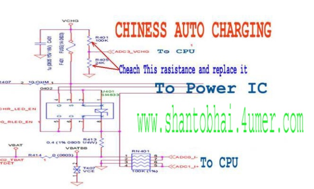

F Fly Dubai Well-known Member Joined Sep 14, 2010 Posts 670 Likes 3 Jan 10, 2011 #61 Maximum china auto charging solution

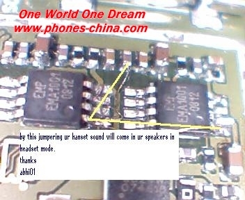

F Fly Dubai Well-known Member Joined Sep 14, 2010 Posts 670 Likes 3 Jan 10, 2011 #62 S3 head set mode solution

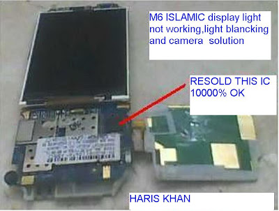

F Fly Dubai Well-known Member Joined Sep 14, 2010 Posts 670 Likes 3 Jan 10, 2011 #63 M6 Islamic LCD Light Solution 1000%

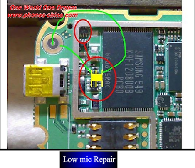

F Fly Dubai Well-known Member Joined Sep 14, 2010 Posts 670 Likes 3 Jan 10, 2011 #64 China Mic Low Solution 1000%

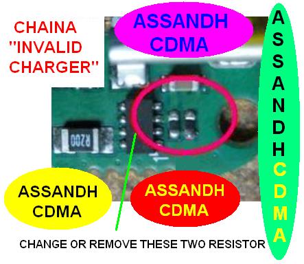

F Fly Dubai Well-known Member Joined Sep 14, 2010 Posts 670 Likes 3 Jan 10, 2011 #65 Invalid Charger Solution First Try To Change Charger if not work Remove Or Change Two Black Color Resistor near R22. 100% TestedA Lot Of Set.

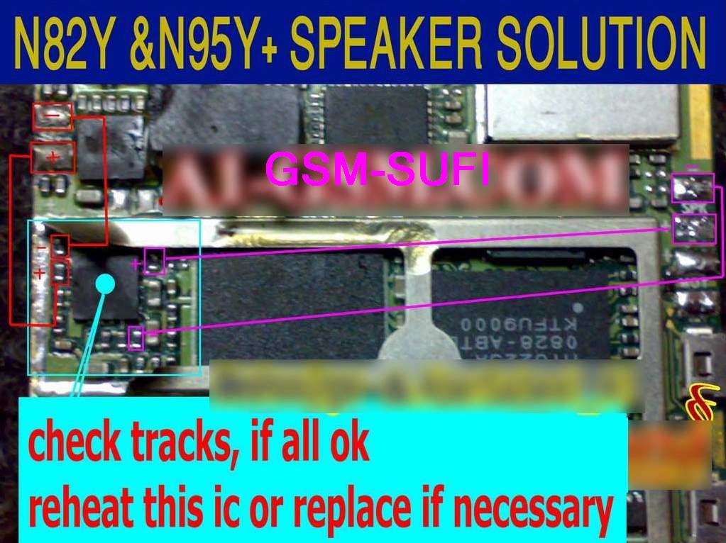

F Fly Dubai Well-known Member Joined Sep 14, 2010 Posts 670 Likes 3 Jan 10, 2011 #66 China N82 & N95 Speaker Solution

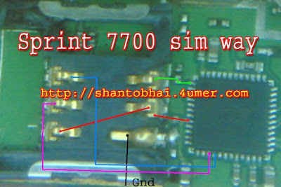

F Fly Dubai Well-known Member Joined Sep 14, 2010 Posts 670 Likes 3 Jan 10, 2011 #67 Sprint 7700 Insert Sim Solution 1000%

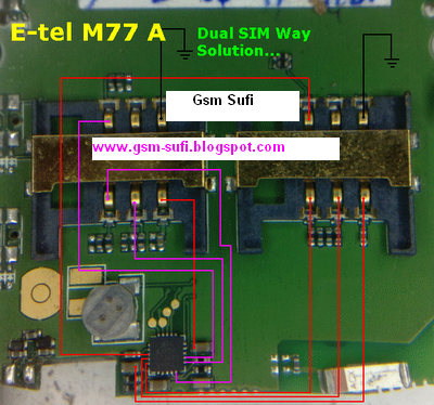

F Fly Dubai Well-known Member Joined Sep 14, 2010 Posts 670 Likes 3 Jan 10, 2011 #70 E-tel M77A Dual SIM Way Solution
F Fly Dubai Well-known Member Joined Sep 14, 2010 Posts 670 Likes 3 Jan 10, 2011 #71 Sprint 7700 RX TX gnd Sprint 7700 RX TX GND PIN Solution
