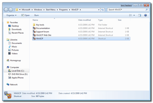

Launch the WinSCP application from your Start Menu programs.

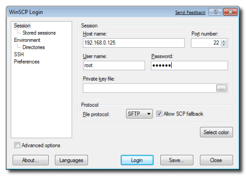

Step Four
WinSCP will ask you to input your login information. Enter the IP Address Address you just retrieved in Step Three as the Host Name, root as the username and alpine as the password. Click the Login button to continue.

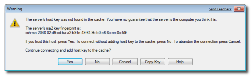

If prompted to add the host key to the cache click the Yes button.

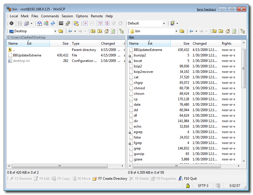

Step Five

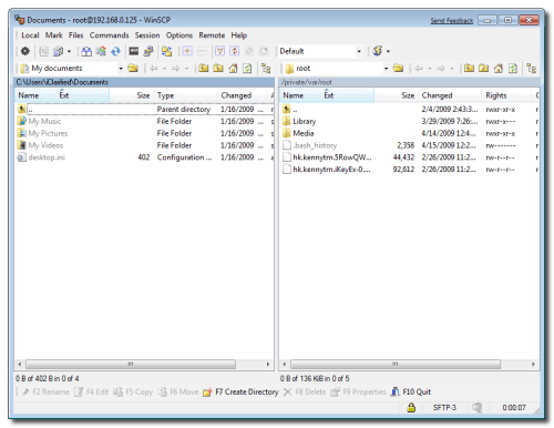

WinSCP will now display two file trees. The one on the left is your local computer and the one on the right is your iPhone.
Navigate to your desktop using the left file tree and navigate to the /bin directory using the right file tree.
Step Six
Drag the BBUpdateExtreme file from the left panel to the right panel.

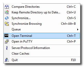

Select Open Terminal from the Commands menu.

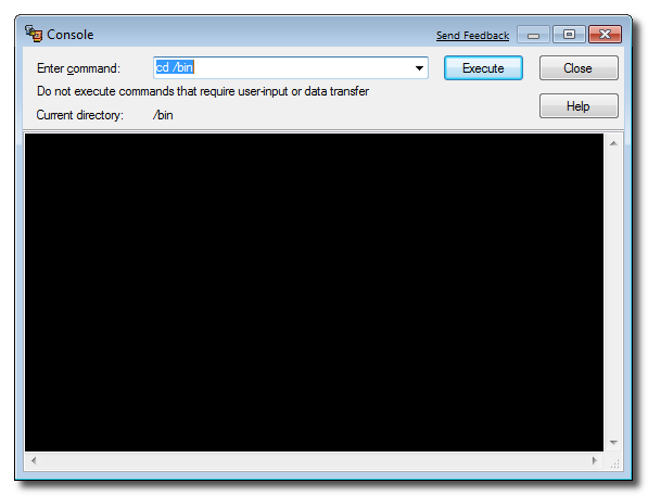

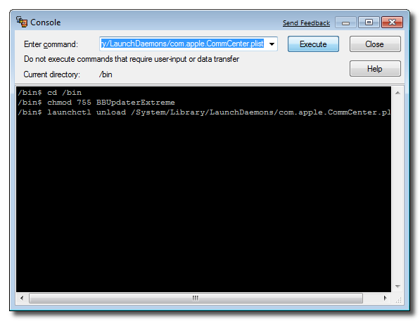

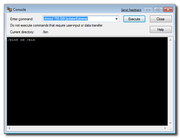

Input the following commands into the Terminal window and click the Execute button after each.
cd /bin
chmod 755 BBUpdaterExtreme
launchctl unload /System/Library/LaunchDaemons/com.apple.CommCenter.plist

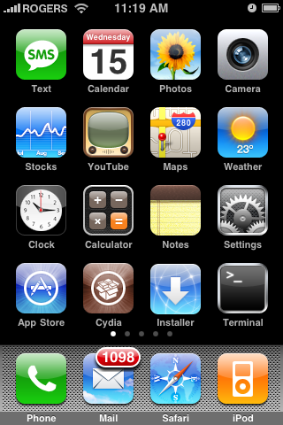

Step Nine
Your iPhone will now loose its network connections. Launch Mobile Terminal from the iPhone SpringBoard.

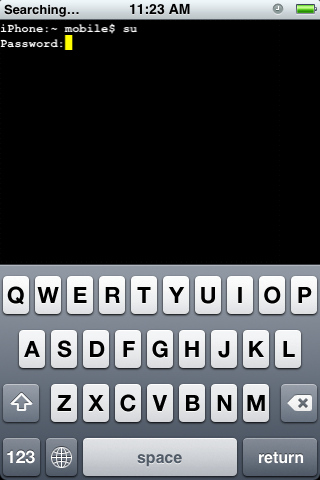

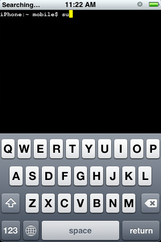

Step Ten
Type su into the terminal window. When asked for a password input alpine as the password.

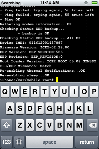

Step Eleven
Now input BBUpdaterExtreme queryversion to get the bootloader version of your iPhone. It will look something like Boot Loader Version: ICE2_BOOT_05.08_G2M3S2
Step Five
Step Six
cd /bin
