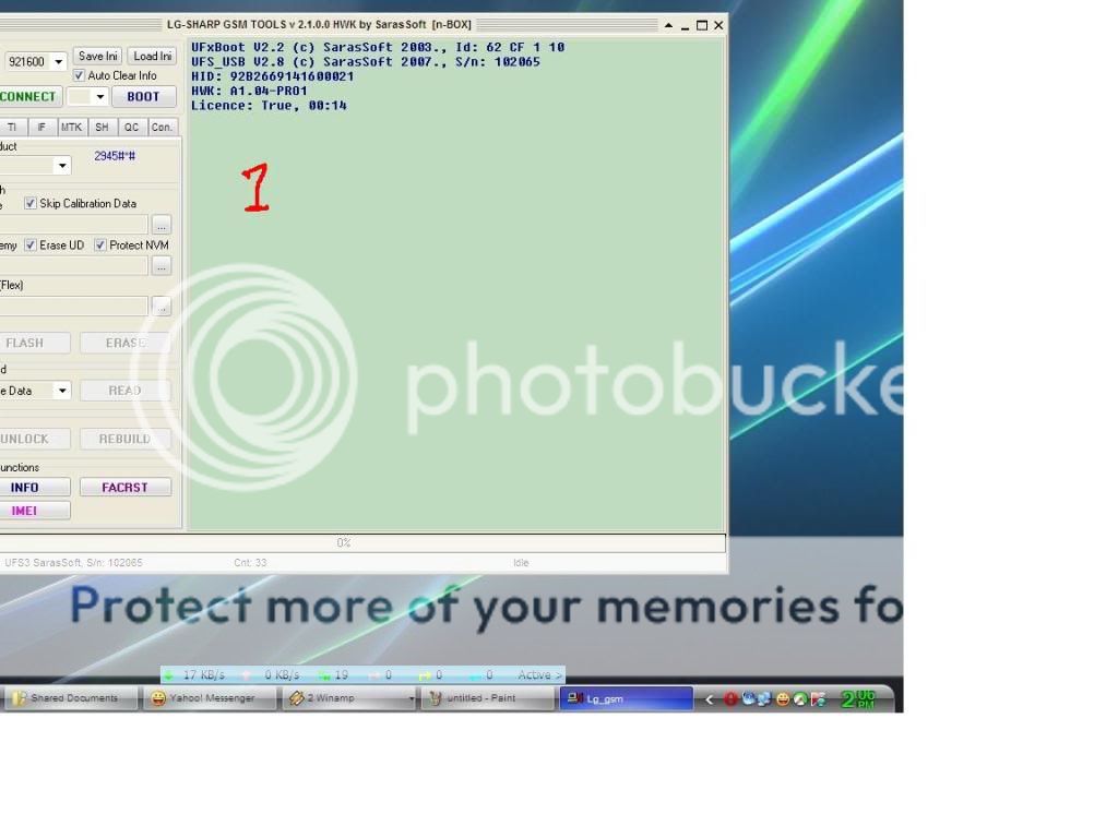

1.Our first open it and connect it UFS_LG
J JannatLui Well-known Member Joined Sep 1, 2010 Posts 2,836 Likes 14 Dec 17, 2010 #1 1.Our first open it and connect it UFS_LG

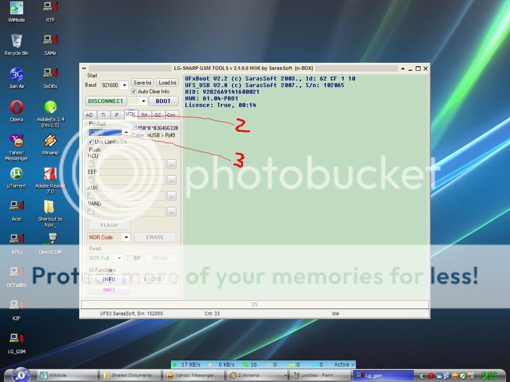

J JannatLui Well-known Member Joined Sep 1, 2010 Posts 2,836 Likes 14 Dec 17, 2010 #2 2. Select One such example MTK CPU type and select one type of mobile phone.

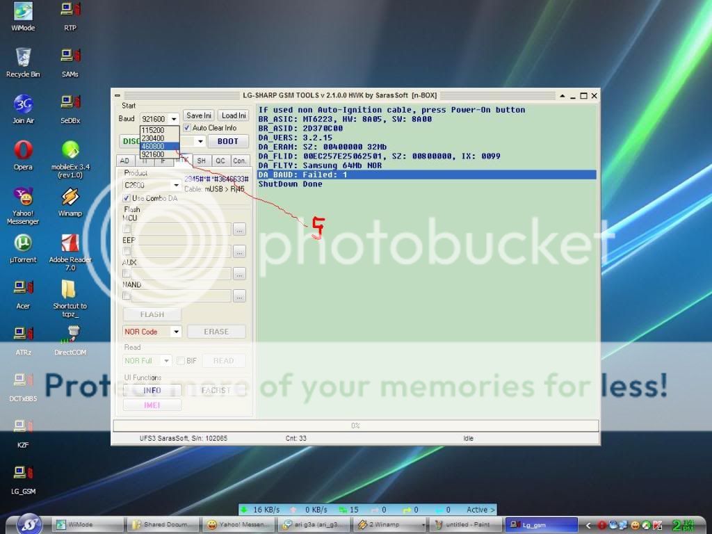

J JannatLui Well-known Member Joined Sep 1, 2010 Posts 2,836 Likes 14 Dec 17, 2010 #3 3. press the "BOOT" and our phone press the Power ON / OFF and don't forget the brain work on speed baud

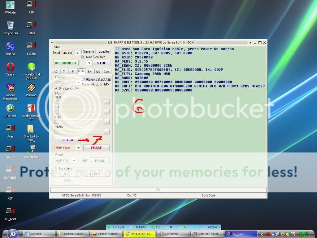

J JannatLui Well-known Member Joined Sep 1, 2010 Posts 2,836 Likes 14 Dec 17, 2010 #4 4. when it's connected to input flash file and then press the "FLASH"

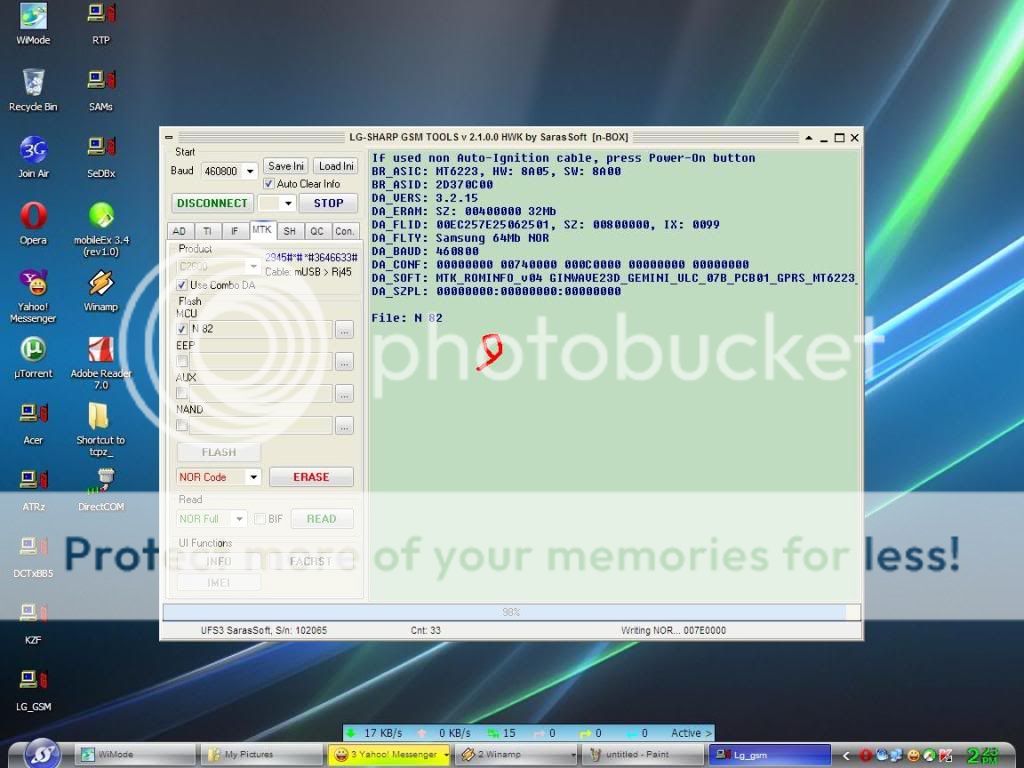

J JannatLui Well-known Member Joined Sep 1, 2010 Posts 2,836 Likes 14 Dec 17, 2010 #5 5. Wait until the process is complete Flashing
J JannatLui Well-known Member Joined Sep 1, 2010 Posts 2,836 Likes 14 Dec 17, 2010 #6 6. We Waited a minute (while Eating Bread and drinking Tea)
J JannatLui Well-known Member Joined Sep 1, 2010 Posts 2,836 Likes 14 Dec 17, 2010 #7 7. The process of "Flashing" done please prove it, 100000% Tested
