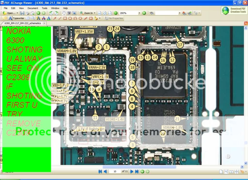

heck shorting in 6300...
1..remove this coil mark in (1)...if u want to check is pf is short,.....
2..remove this coil mark in (2)..if u want to check rf ic is short because rf ic also got +b volt from battery....
3..remove this coil mark in (3)..if u want to check blutooth ic is short because bluetooth ic also got +b volt from battery....
4..remove this coil mark in (4)..if u want to check the v.camdig maker ic ..this v.camdig maker ic got +b from batery....
5..remove this coil mark in (5)..if u want to check the light ic is short....
6..also check the memory card driver ic n3200 it also got +b it can be check by only removing this ic.....
7..at end remove retu and tahvo ic...
all the component which are mark in pink colur these all are coils these are place in series and +b of batery is gone throw them so if u remove the coil u not have to remove ic to check the shorting in pcb it save time and ur ic ....
