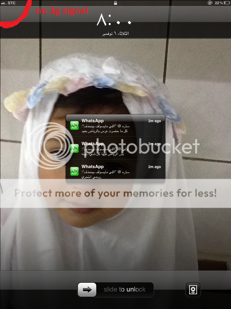

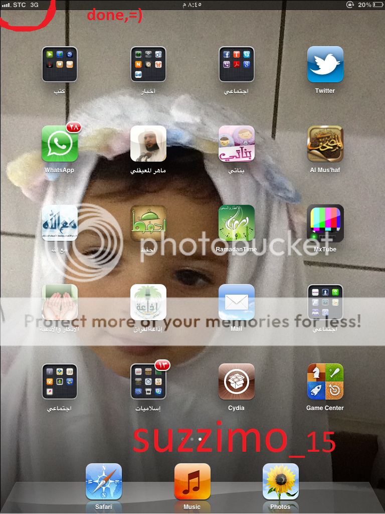

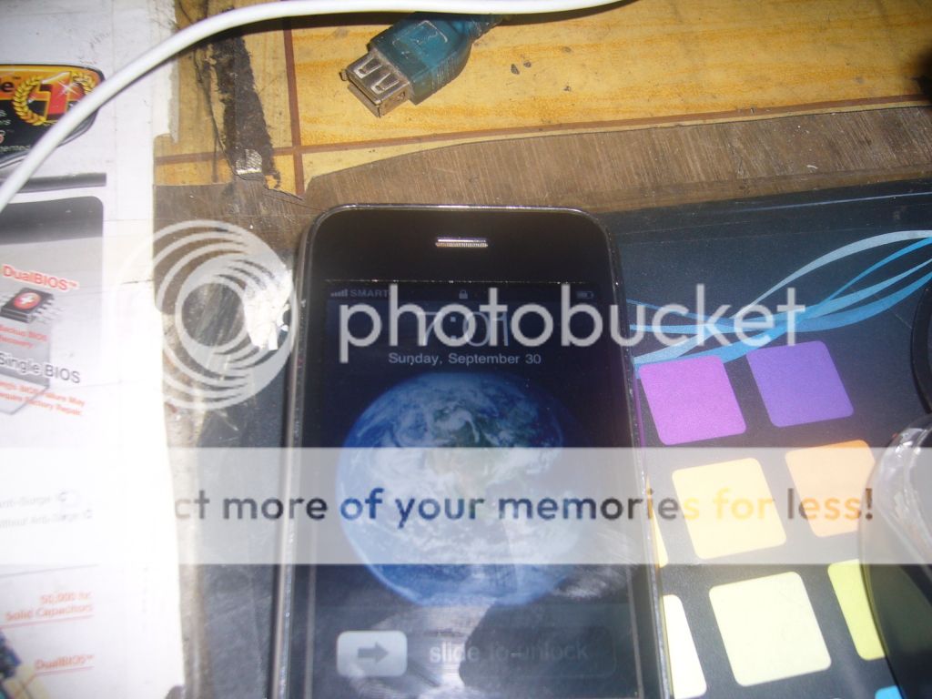

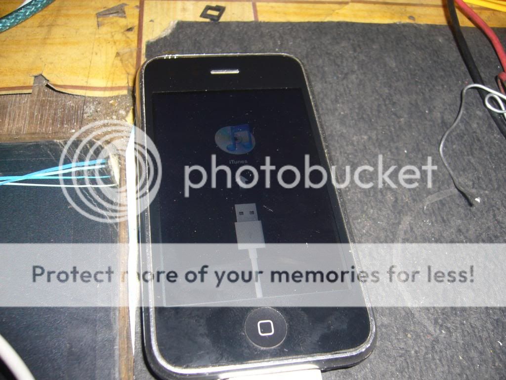

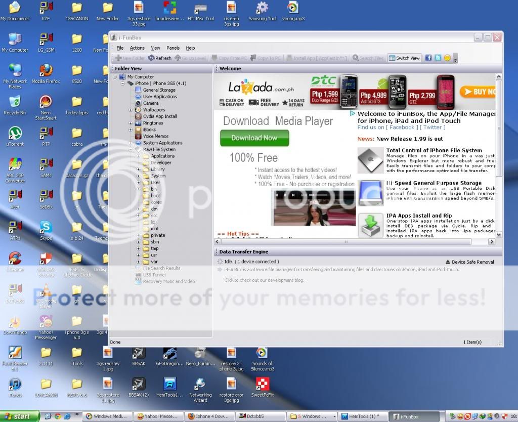

iphone 3gs 32gb version 4.2.1 downdgrade sa 4.1 version success
jailbreak..........
go cydia runing.....
go unlock no wifi ifunbox.......
unlock i phone...
after that 3time power

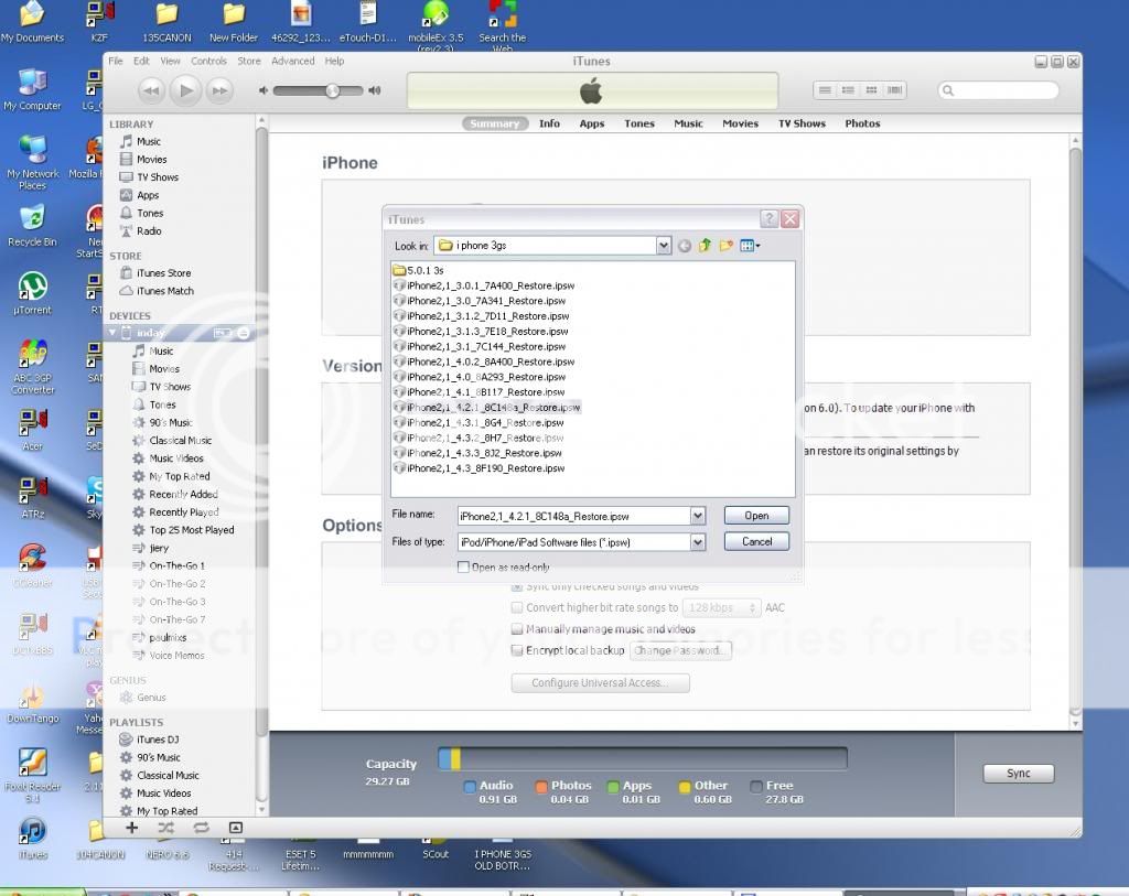

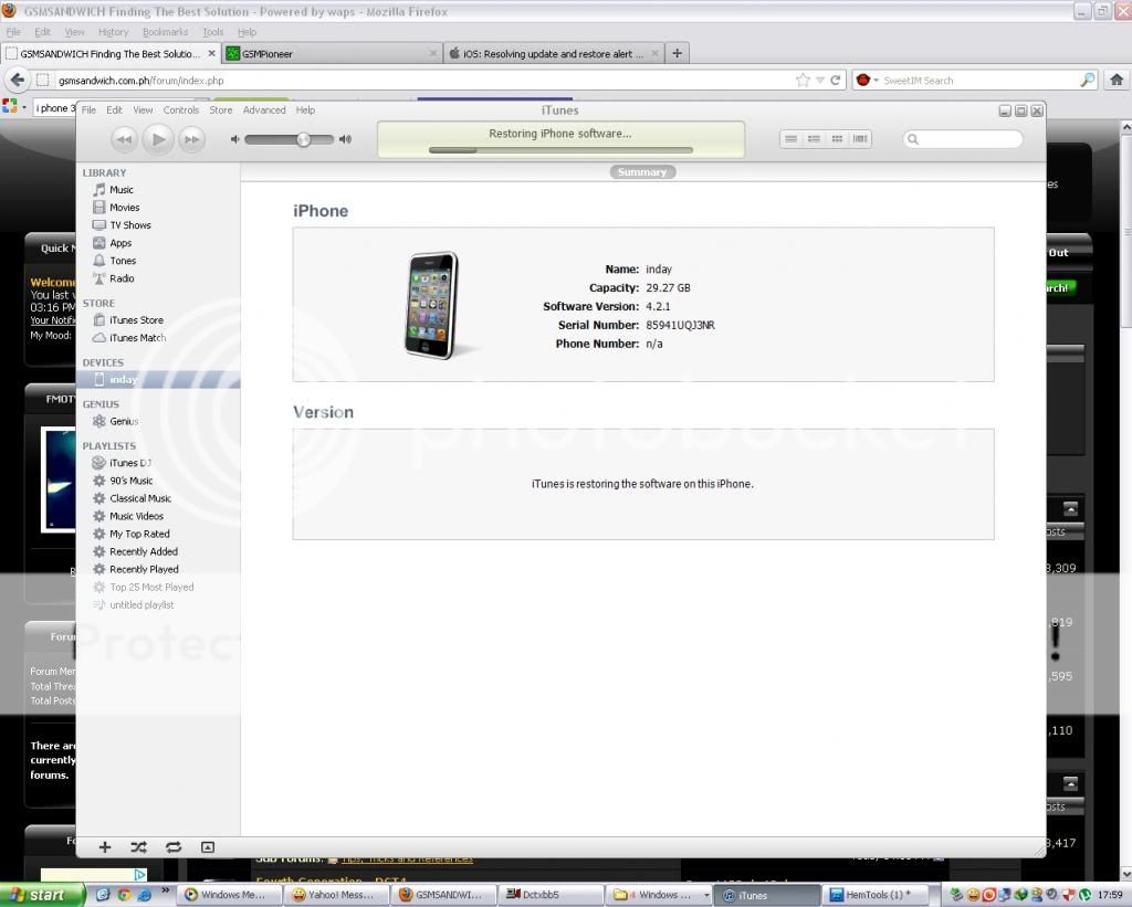

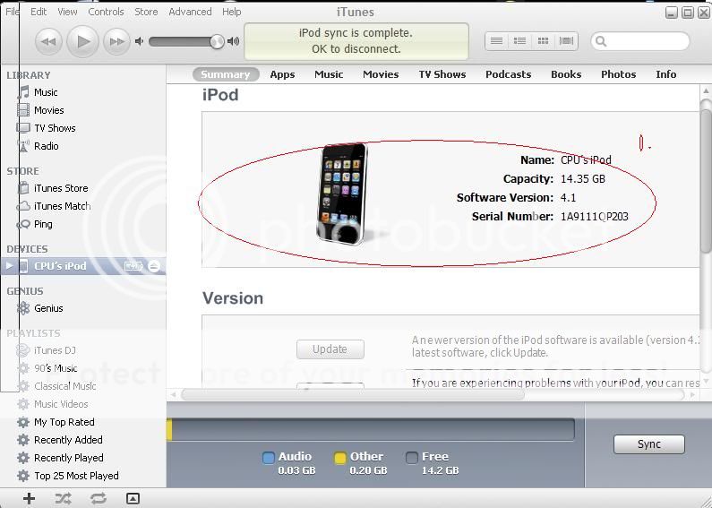

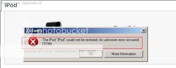

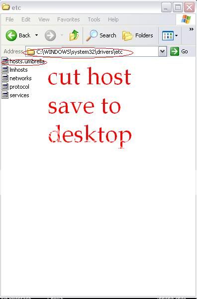

procedure :

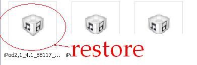

1.restore update itunes error 3194
2.dl firmware ipod2,1_4.1_8b117
3.go to drive C..click windows click system32
4.go to drivers click etc
5.cut to destop ''host''
to itunes update to restore..
ipod firmware here

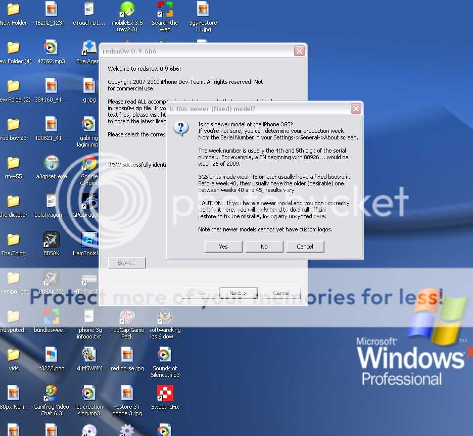

Step 2: Run redsn0w and click browse, give it iOS 4.1 or iOS 4.2.1 you downloaded in step 1. Remember, if you are on Windows 7 or Vista and having problems running it, change the compatibility mode, by right clicking on the file and clicking properties. From the options check the compatibility tab and change it to XP or Lower. Also, try to run it as administrator if nothing else helps.
Step 3: Wait for the file to be identified, once done click next. Choose “Install iPad Baseband” from the options. A popup message will pop up with a warning, click Yes to continue.

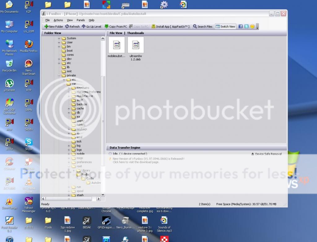

Step 7: You can use the Cydia > Ultrasn0w to unlock your iPhone 3GS or iPhone 3G.Tap the “Sources” button You can also go straight to Search tab and type in “ultrasn0w”. if you find it just tap on it and install it and skip rest of the tutorial.
Step 8:Go to “Edit” and then “Add”. A Popup box will appear, now enter this URL Source in it “[Only registered and activated users can see links. ] and tap on “Add Source”. This should update Cydia by adding this URL source.
Step 9:Once this source is in, go to the search tab and type “ultrasn0w”. An application should show up, tap on install at the top. This application will unlock your iPhone 3GS or 3G on baseband 5.14.02 or 05.15.04 and you can now use your device on any carrier.
