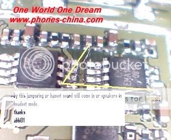

sigmatel s3 headset solution 100%working
this prob comes when inserted a wrong charger in the set
a pin seen below comes from cpu for headset when a wrong charger is inserted then then this pin totaly short now the solution is that remove this pin shorting or
1.change cpu with other and reflash phone with origional flash
