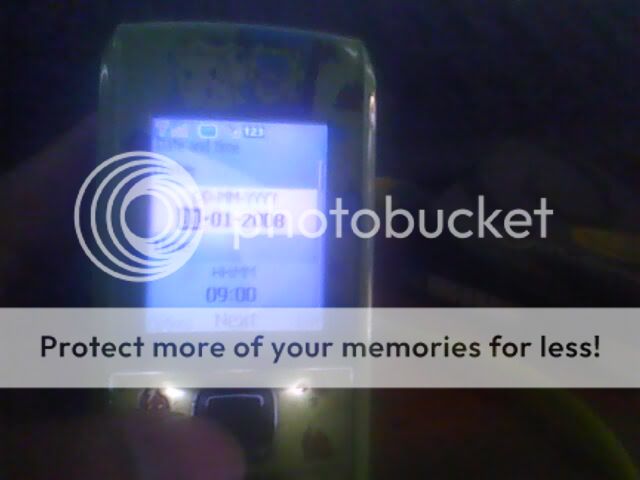

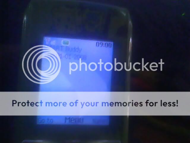

1680c whitescreen done by cyclonebox
procedure
open cyclone
click dct4/wd2/bb5
wait for boot box
click dct4
use universal cable set 5.1k
click mcu ppm cnt to add flashfile
click checking bus
click flash
click unlock
here logs

here result

CP Extract Failed -> CP Server not exists
WARNING: Failed to extract CP
Box VPP disabled
Booting UPP...
UPP ID: 3162 [HW_UNKNOWN]
rm394__05.63.ppm_el, Type: Flash Image, Algo: DCT4, DCT4 ALGORITHM
Flashbus Write baud set to 100Kbits
u3_2nd.fia, Type: 2nd Boot Loader, Rev: 7.4.79.0, Algo: DCT4
Box VPP disabled
Internal Phone VPP Selected
PLL Factor: 3
FlashChip[0]: 0x0001317E @ 0x01000000, AMD, SectorSize: 128kB, Ext: 00419221
FlashChip[1]: 0x0001317E @ 0x02000000, AMD, SectorSize: 128kB, Ext: 00419221
Signature: AD7EB61A1BBE0BE27D586BE4DBEE6514
Flashbus Write baud set to 1.0Mbits
Flashbus Read baud set to 51Kbits
u3_amd.fia, Type: Algorithm, Target: FlashChip[0] 0x0001317E (256Mbits), Rev: 7.4.79.0, Algo: DCT4 ALGORITHM
Nominal VPP Voltage: 9V, Detected: 0.04V
MSID-Crypted: 84054A395F32343E99171FABF9
MSID-Plain: 3E4EBAE900C1060DA9000000
FAID-Crypted: B9BE58BB4FE581B94FA04BC6
Flashbus Write baud set to 6.50Mbits
1 Region(s) to erase
Erasing NOR Region [0x01C40000-0x01FFFFFF]
Erase taken 14.516s
Writing 79 blocks...
All blocks written OK! Time taken 48.594s
Terminating flash session
Box VPP disabled
Processing post-flash tasks...
Post-flash tasks finished...
Flash successfully finished!
MCU Version V 05.63
MCU Date 20-06-08
Product RM-394
Manufacturer (c) Nokia
IMEI 353527021307389
Mastercode 1314524343
Proceeding with RSA Unlock...
Warning: Failed to read SP Info, Assuming defaults
Asic 11
HW Signature 808F1E50A3EC5748
Simlock Server SIMLOCK SERVER
Simlock Key 5555555555555555
Simlock Profile 5555555555015555
Simlock Aux 000B5555
Simlock IMEI 00553535270213073800
Simlock Key Cnt 0
Simlock FBUS Cnt 0
Asking card to sign HW Signature...
Signed OK (6089DB73CE80FF9170F5967D877BB2527A8BCED0)
Calculating SP...
Writing SP...
New SP Accepted OK!
Phone unlocked OK!
here result
DIGITAL -AMIT
