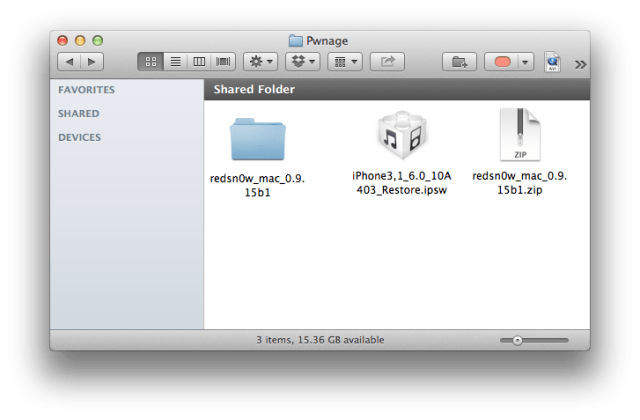

Step One
Create a folder on your desktop called Pwnage
Download the latest version of RedSn0w 0.9.15b1 from here and place it in the Pwnage folder. Likewise, download the firmware you would like to upgrade to from here and place it in the Pwnage folder.
Extract the RedSn0w zip file by double clicking it.

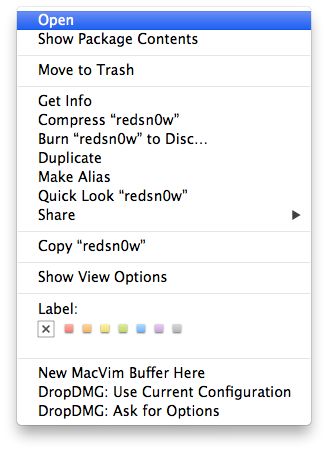

Right click or control click the RedSn0w application that you extracted in Step One and click Open from the popup menu that appears.
answer: Update iphone 3G[s] & 4 Without Updating Baseband using redsn0w [Solved]

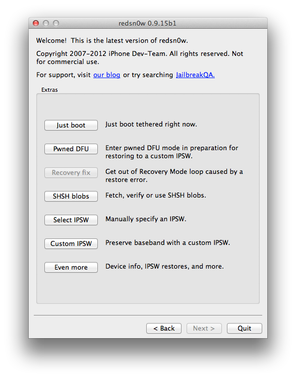

Step Three

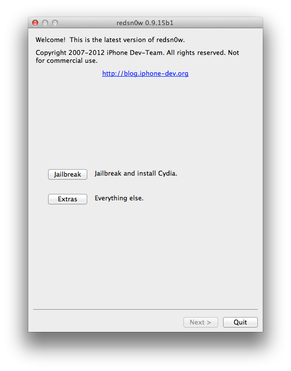

Click Extras from the RedSn0w menu.

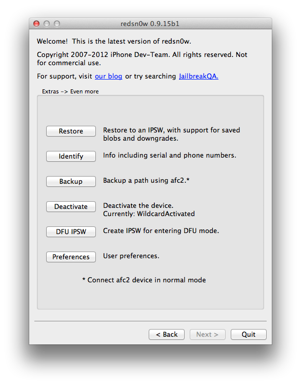

Step Four
Click Even More from the Extras menu.

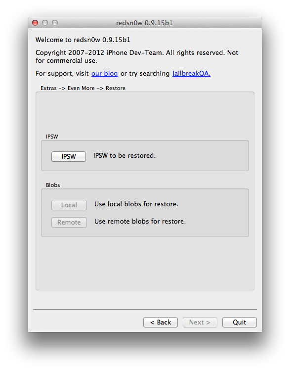

Step Five
Click the Restore button from the Even More menu.
Step Six

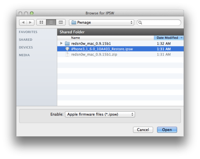

Click the IPSW button.
Choose the firmware you would like to update to from the dialog box that appears and click the Open button.

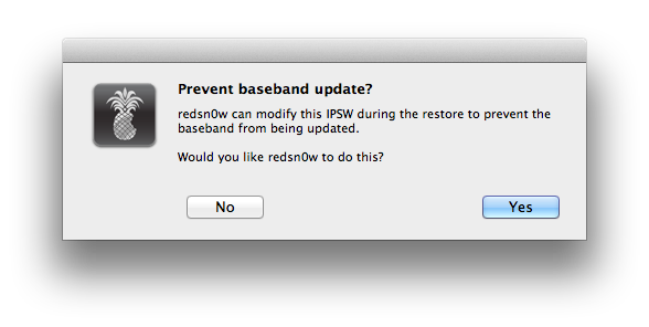

Step Seven
You will be asked if you would like to Prevent baseband update. Click the Yes button.

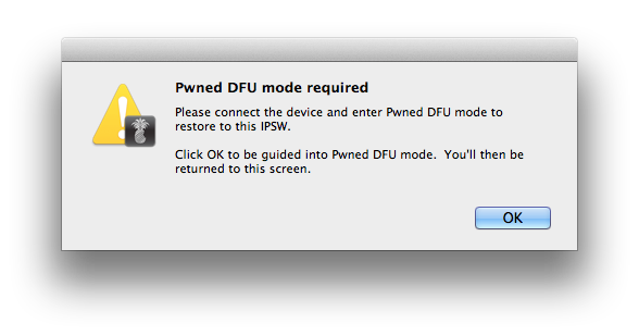

You will be told that Pwned DFU mode is required. Click the OK button.

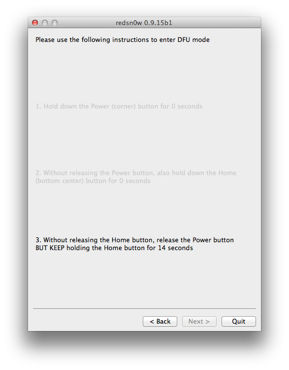

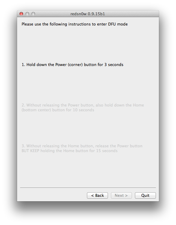

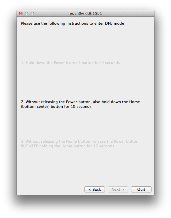

Step Ten
RedSn0w will now guide you through the steps to get into DFU mode.
Hold down both the Home button and the Power button for 10 seconds.
Release the Power button and continue holding the Home button until RedSn0w detects the device.

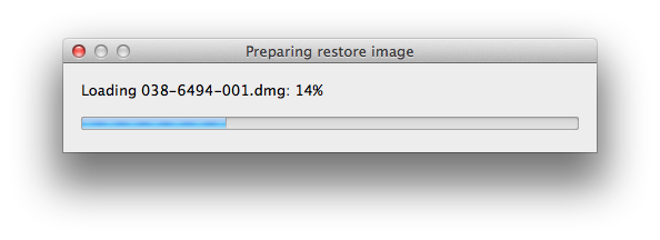

Your device will be detected once in DFU mode and exploited with Limera1n.
Redsn0w will then prepare a restore image.

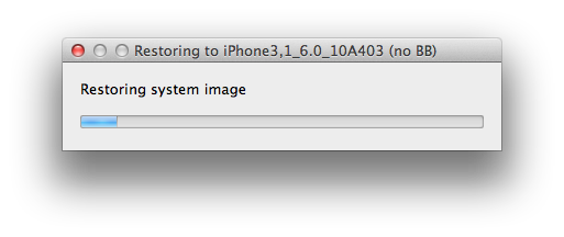

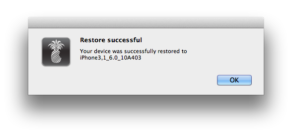

Step Twelve
Redsn0w will now restore the device to the new firmware.
