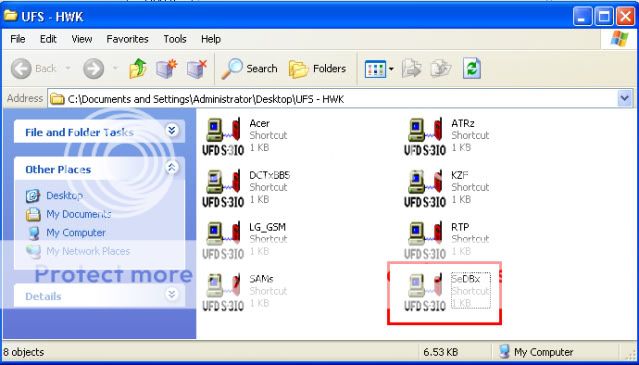

SeDBx is one of the members in the family of HWK-UFS Sofware specifically designed to deal with newer SE units to compliment the unending list of supported models.
Here are the UFS Softwares that include SeDBx.

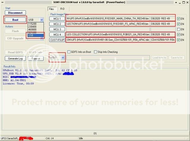

Now, let us identify some of its major control.
SeDBx INTERFACE:
First thing first, you have to put the phone into Flash Mode.
How ?
There are two options:
1. Via normal mode - using RJ45 cable.
2. Via USB mode - the usual DCU-60 cable.
I think there is no need for me to elaborate on the usage of these tools, you should use your common sense. (the sense which is not common
In the case of USB mode ... if ask for drivers, phone drivers can be found on the following location:
X:\Program Files\SarasSoft\UFS\UFS_DBX\USBFlashDriver
where X is the name of your Directory.

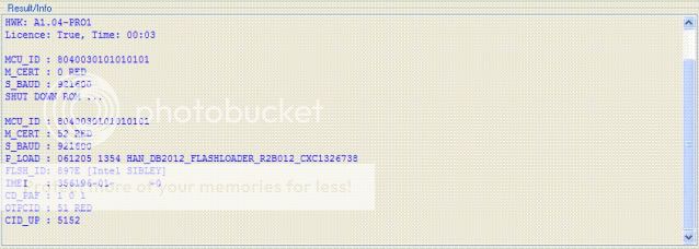

You can now press Boot and the phone will be attached in your assigned mode.
Successful Phone Boot displays Phone's Information on the Result Info Window ...

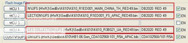

FILES USED FOR FLASHING:
The following is the correct setup for SE K610 model CID49. (sample lang yan ha
It will vary depending on the type of model your working with.
FLASH FILES DISTINGUISHED:
MCU 1 = Main Flash File (Largest MCU file in terms of size)
MCU 2 = File System (Larger MCU file in terms of size)
MCU 3 or 4 = Update Agent (UA) (Smallest MCU file in terms of size .... i.e. FOTA/EROM/CERT)
CUST\FSUP = This is a customization file.
In SETool .. it is equivalent to "Complete Phone". This file is needed or phone will encounter configuration error.
This file has two classifications namely BiB and BIC files
BIB - are files used to convert the phone from one market region to the other, example of this is changing language.
BIC - are files used if you only want to upgrade the phones software version.
MCU FILES doesn't follow that particular order ... but for simplicity purposes it should be wriiten that way.
If you intend to flash the phone ... all you have to do BY NOW is to click the "FLASH" button.
Update Agent (UA file) is not a required image, you do not have to update this, unless you are changing the CID version, in this case UA Update IS REQUIRED)
