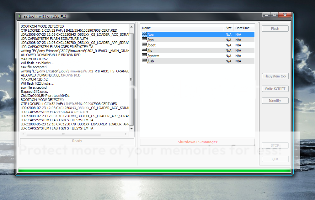

With A2uploader you can now flash the phone with firmwares, customize your phone, de-brand your phone, add files to phone FS-FileSystem, upload flash menus and change menu icons and perform all customizations possible on the file system. With A2uploader you can’t patch your phone yet, you can use jjpatcher to patch your phone though.
Flashing The phone.
This part discusses how to flash the phone with firmwares.
The phone firmware consists of 2 parts, the Main firmware, and the FS firmware. Main firmware contains the phone operating system. Where as the phone file system contains lots of files needed for the phone to work properly. The phone FS also contains preloaded content like images and factory ringtones. With A2uploader you can flash your phone with the latest firmwares. You can flash both main and fs. Or only one of them, as you need. The main firmware has the extension .mbn and the FS firmware has the extenion .fbn !

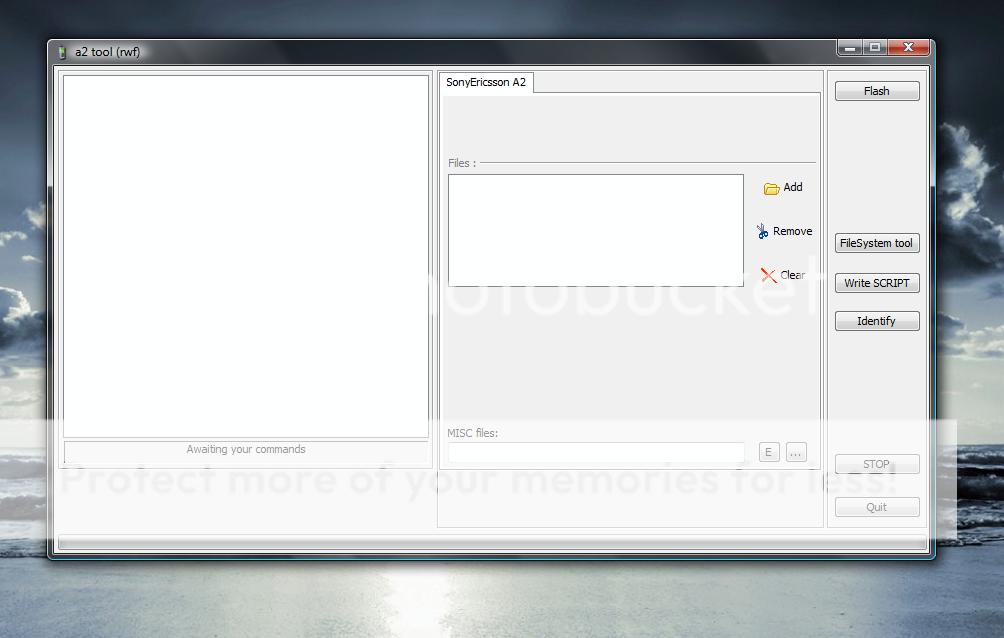

Start A2uplader.exe
Click ADD button.
Select the firmwares you want to flash.

Click Flash in A2uploader.
Connect your phone holding C or 2+5.
Wait for some time.
Disconnect phone after flashing is done. It will say Elapsed:xxx secs.
Re-insert battery and start your phone if you necessary.
You should connect your phone holding C, but if your Phone Start Button is C, The connect your phone holding 2+5.
Example: G502. Start button is same as C key.
Imporant Warnings:
If you flash your phone FS, then all the data in your phone will be erased, All your SMS/Contacts/Pictures in phone memory. So before flashing your FS firmware you should backup every thing.
Also If you Flash your FS, then you will need to upload CDA files to phone file system. You should upload Customize.xml and preloaded_config.xml to /tpa/preset/custom/. If you forget to upload CDA/Customizaiton/CustPack files after flashing the FS, then you will get a configuration error are phone start. If you forget, don’t worry, just upload them this time before starting the phone.
While flashing the phone, don’t press the STOP button. Don’t close A2uploader, or don’t let your computer hang. Flashing the firmware half way may break your phone, and your phone might not start.

Start A2uploader
Click File System Tool.
