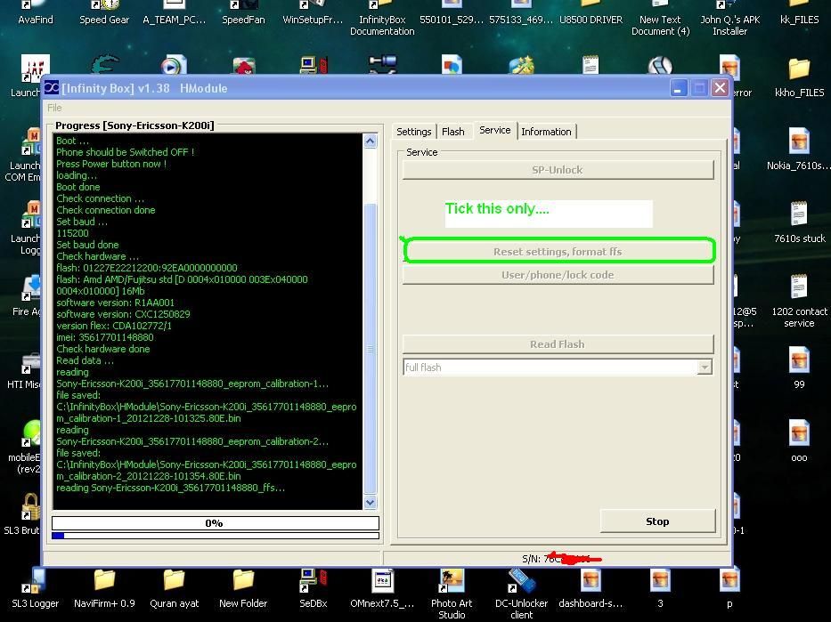

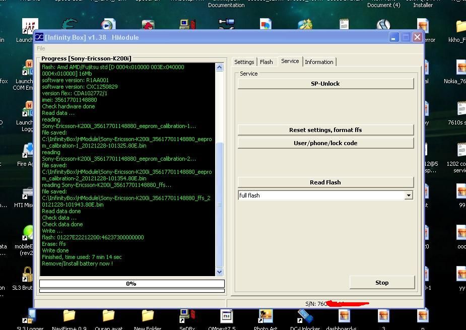

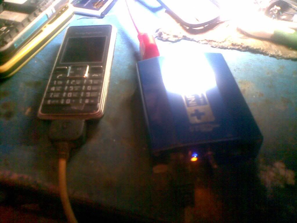

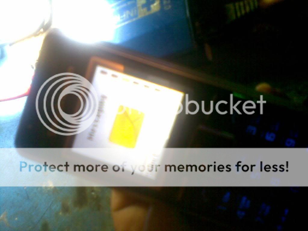

PROCEDURE:
1.Open Infinity Shell and select Sony Erickson and RUN SW.
2. Connect J100 infinity Cable,tick FORMAT TAB.
3. After Tick Format Tab Insert The Battery and Press On Key.
4. Wait until it Success.
Testing and Finish:
