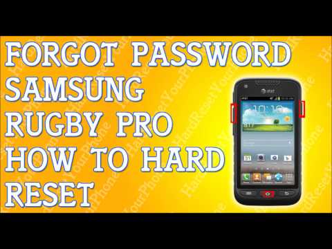

Samsung SGH-I547 Galaxy Rugby Pro AT&T Hard Reset Steps:
- Make sure that your Samsung SGH-I547 Galaxy Rugby Pro AT&T is Off, And has no SIM or Memory cards are inside.
- Take out its battery for 10 seconds, Then put it in again.
- Press and hold Volume Up + Home Keys, Then press Power.
- Keep pressing the above keys until Samsung logo appears,Then release Power key only.
- Wait until you are into Factory reset / System Recovery menu, Then release all keys.
- Use Volume Down key to scroll down and select Wipe Data / Factory Reset option.
- Use Power button to confirm the operation.
- You need to use the Volume Down key again to select "Yes -- delete all user data"
- Use Power button to confirm the operation one more time.
- After performing the hard reset, Select Reboot System Now option, And confirm it using Power button.
- Now the phone will reboots, Wait for it to be fully on and then you can start using it.
