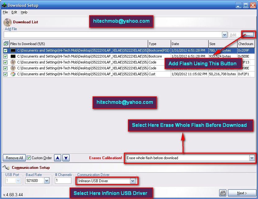

Step1: Open Flasher "FlashTool_E2.exe" (link is given below)
Step2: Select flash File Using Given Method
S5220xxxxx_psi.fls
S5220xxxxx_slb.fls
S5220xxxxx_BSY.fls
S5220xxxxx_CDS.fls
S5220Oxxxxx_CSC.dffs
Step3: Erase Calibration Select "Erase Whole Flash Before Download"
Step4: Communication Driver Select "Infenion UsB Drivers"
Step5: Press Next

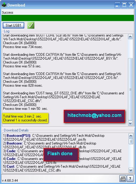

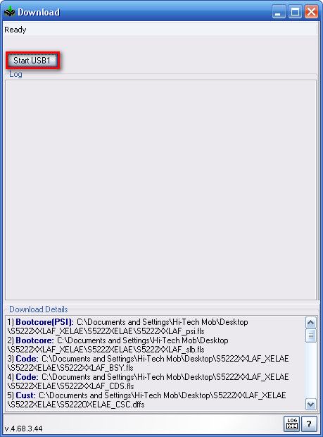

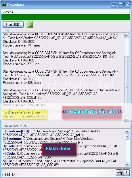

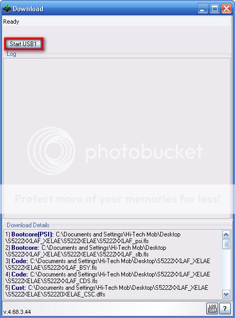

Step6: Then Press "Start USB1"
Step7: Then Insert USB In Mobile Without Battery Wait 2Sec Until Synchronise show Then Insert Battery
After Flashing Reset E2P Using Code *2767*3855#
