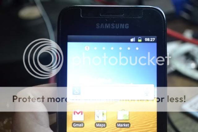

samsung i9003 Dead boot done!!!

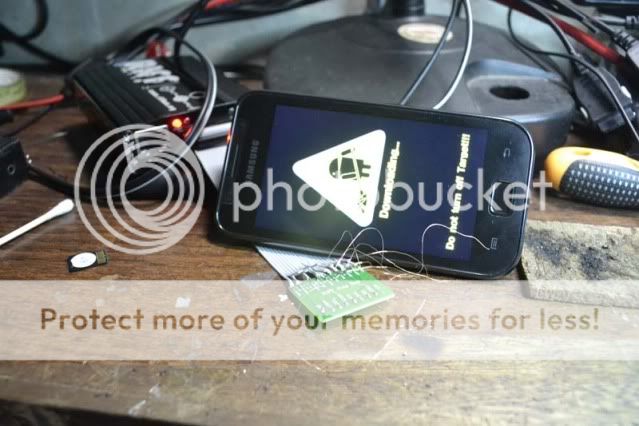

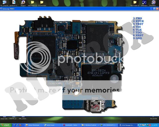

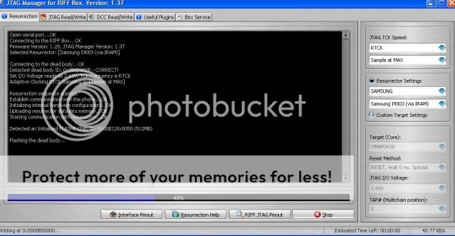

First create the magic card then insert to phone
click ressurect

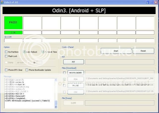

Flash it using Odin
Tools: Usb Cable for nokia like (5130)
Open samsung tool select I9003
Check >> re-Partition
Click PIT Tab and put this file >> latona_20110114.
Press Volume botton Down >Menu botton>power botton
Then START wait fo the PASS the CLICK RESET
Press Volume botton Down >Menu botton>power botton Again
Click PDA Tab and put this file
I9003DXKF1-REV08-ALL-low-CL1020446.tar.md5
Click PHONE Tab and put this file
MODEM_I9003DXKB2_REV_00_CL863799.tar.md5
Click CSC Tab and put this file
GT-I9003-CSC-MULTI-OLBKB2.tar.md5
Wait Until PASS finish..
the upgrade to Gingerbread 2.3.5
I9003DXKP9_I9003OLBKP7_I9003DXKP7_HOME.tar.md5
Done
