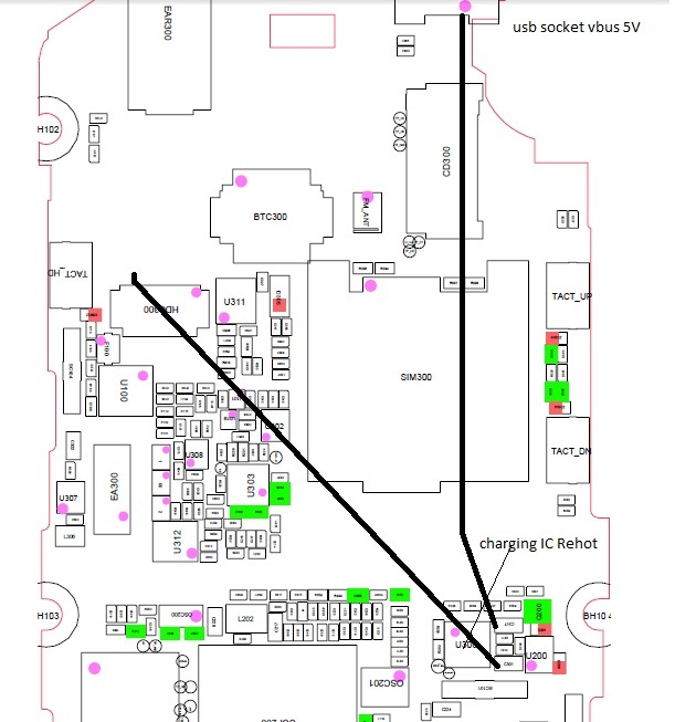

I have got one SAMSUNG C3303 showing Charge pc connectivity as soon as I switch on the mobile. I tried the following things :
1. Cleaned the Charging Jack very well with good quality thinner.
2. Resoldered the 7 pins connected with the PCB.
3. Changed the Charging Socket perfectly.
Now it's not taking any charge at all and also no sign of pc connectivity on the LCD.
Please give me the solution.

kindly change charging diod and your problem will be solve 101 % tested

after these all job plz try to use with original charger faced the same and solved with replacing with original charger plz post result.............good luck

check charging connector 3rd track problem solved......... i try this 100000%

Charging Jack remove 100% but not charging your mobile
