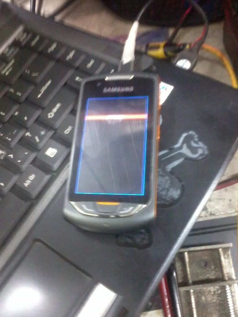

Problem:Camera Failed After Reprogram
Action Taken:
Readcodes At Usercode No Luck sa Z3x....cannot detect....
Tools:
USB Cable 5310

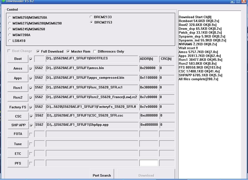

Multi Loader 5.62 http://www.4shared.com/file/yEs1I2GK/MultiLoader_V562.html
Flash File S5620AEJF1_SFRJF1.rar
Procedure:
1.Boot The Phone Into Download Mode:
Press.....Volume Down + POwer ON
2.Connect USB Cable
3.Load Flash File
4.Press Port Search Then Click Download.
5.Wait Until Finish.....
SCREENSHOT.

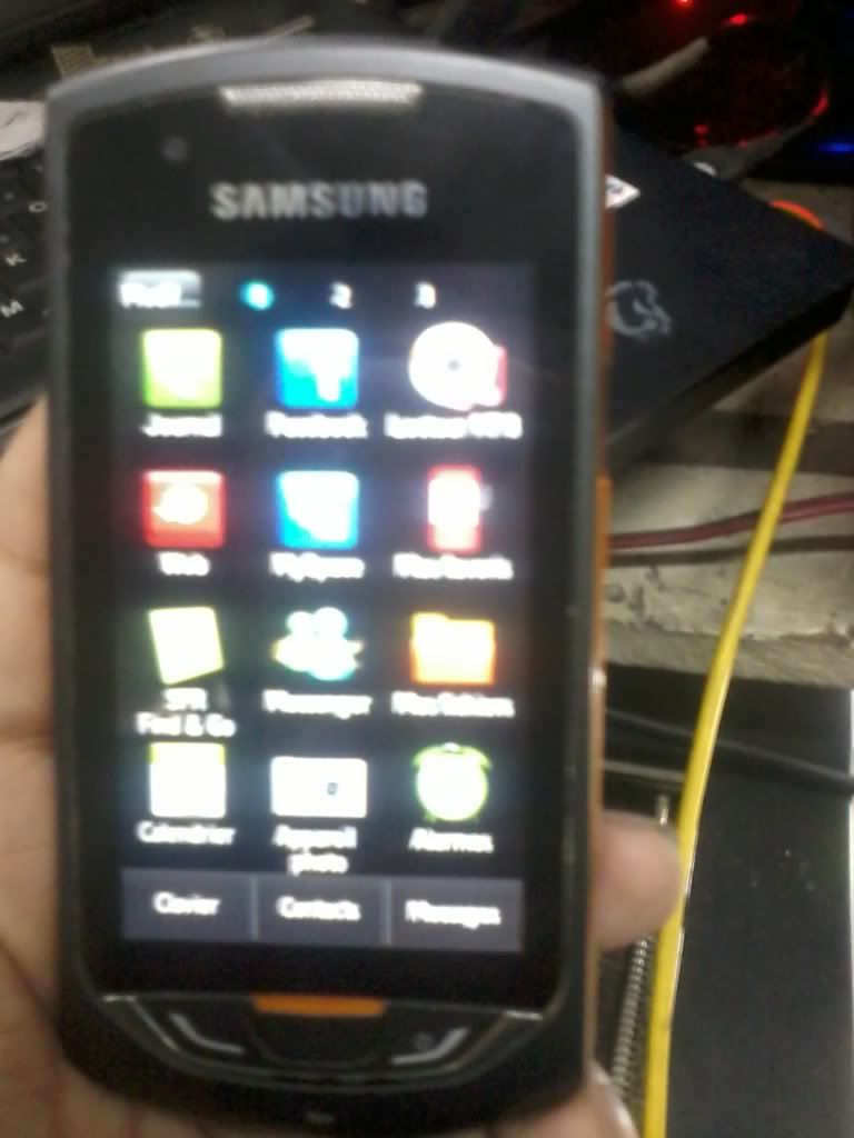

after all my suffer, its finish......
