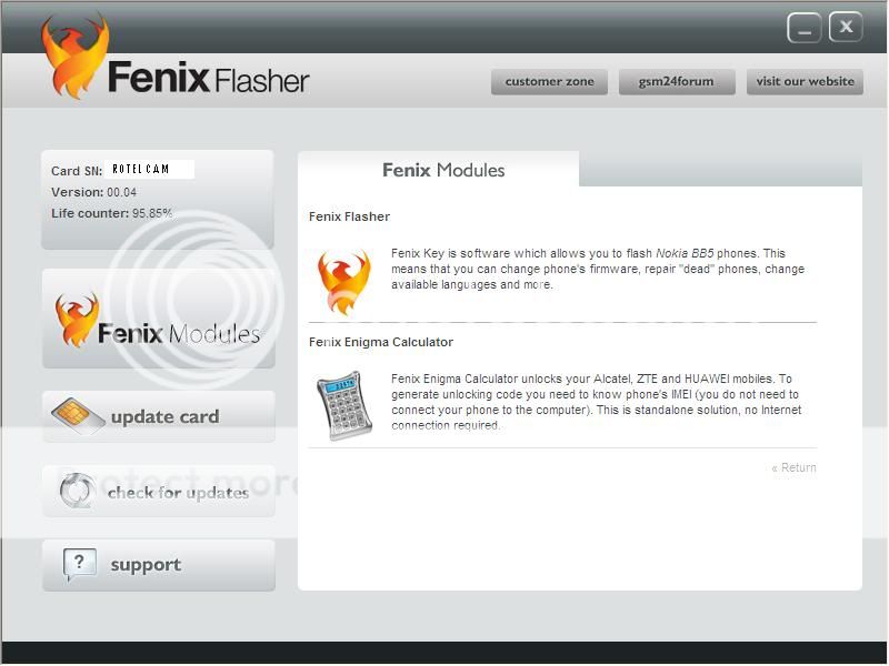

Lets put in this thread all our success stories with Fenix key.

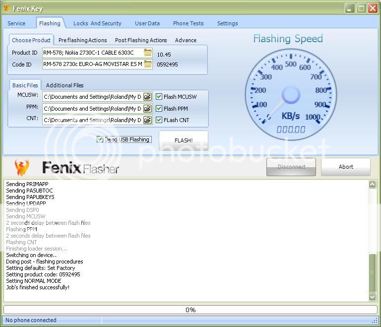

In this all can find easy already done phones with this evolutionary Dongle by Lavarow Team.
2730 - RM-578 Flashed ok in dead mode.

Job's finished successfully!
  Best Regards
RotelcaM
