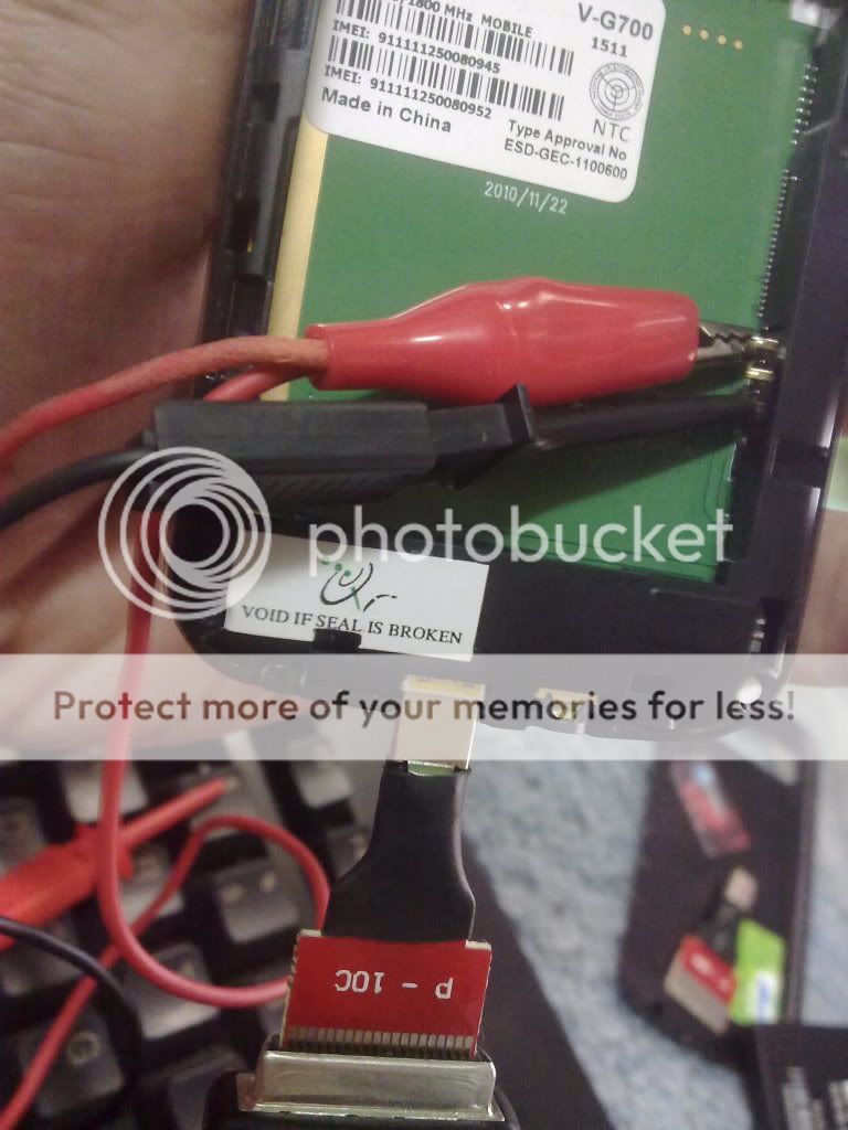

Open Dragon
Select Com Port
Select MTK
Tick Read Info
Select Flash Type & *****
Click Start Button
Use P10-c Jigs
Connect Phone (press power shortly)
After Reading Info
Tick Format
Then Click Start Button
wait till flashing complete

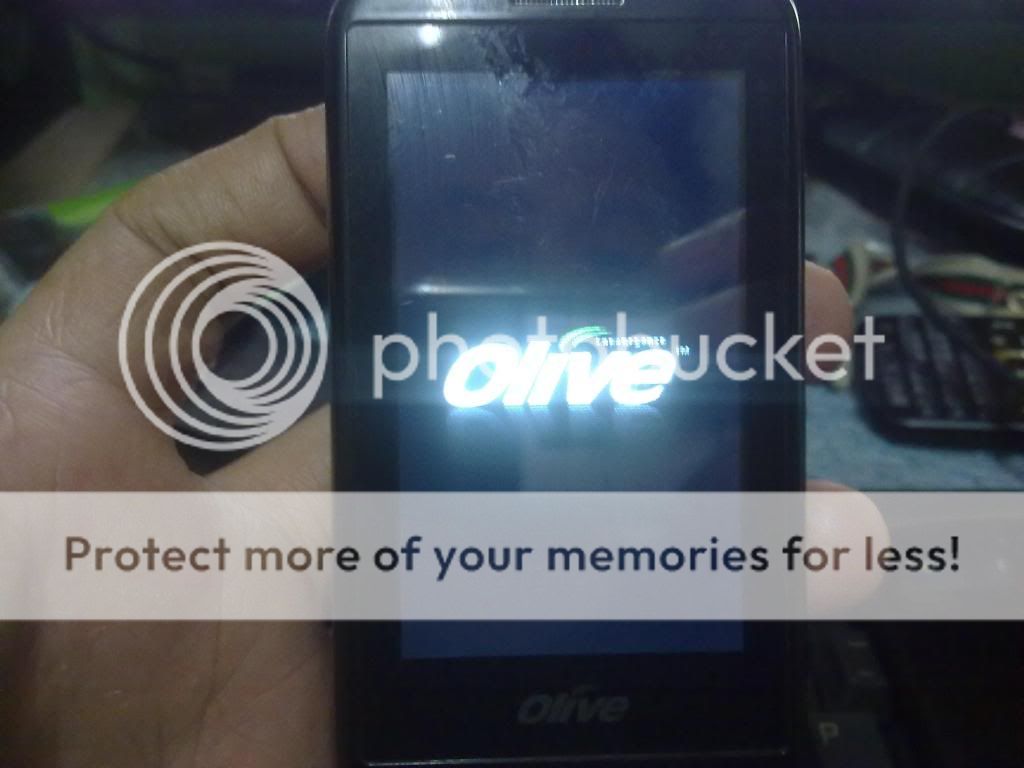

Model Olive V-G700
Hang lang po d2 sa Olive Logo
P-10c Jigs
Read Info
Format

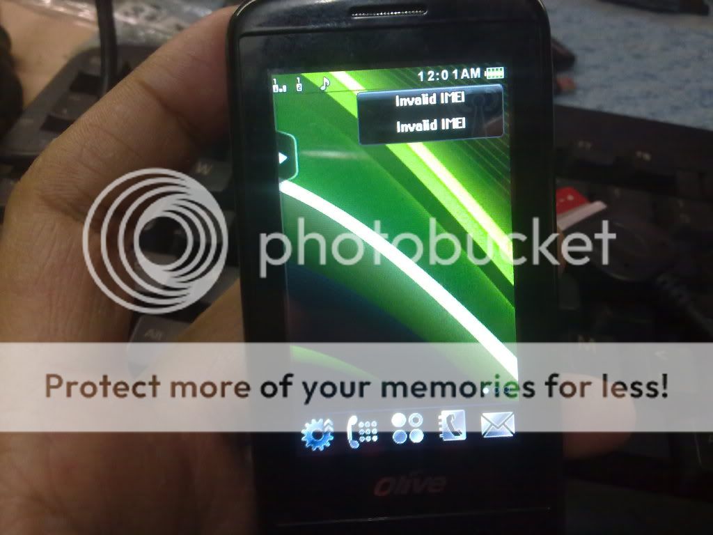

After Format Invalid Imei
Olive V-G700 Hang Up On Logo DONE...

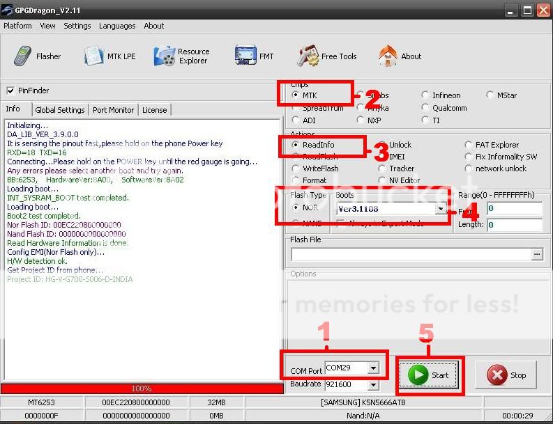

Open Dragon
Select Com Port
Select MTK
Tick Read Info
Click Start Button
Use P10-c Jigs

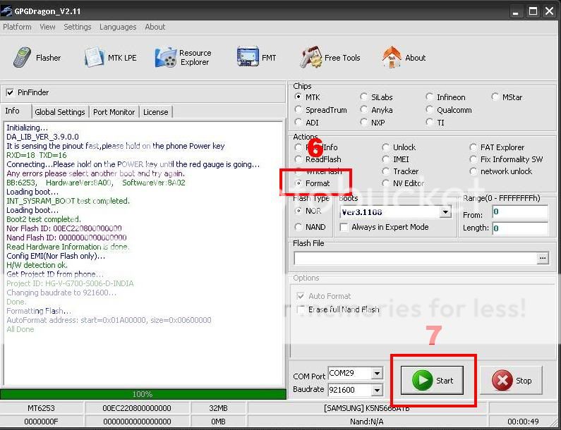

After Reading Info
Tick Format

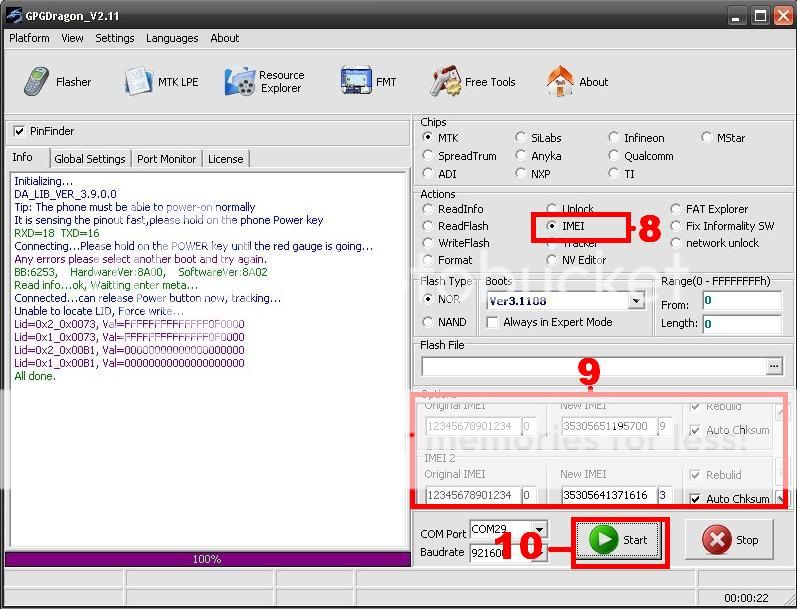

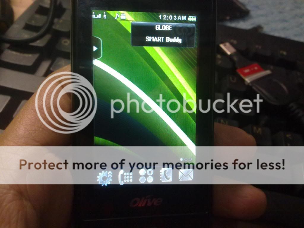

Just Rebuild Imei:
tick Imei
Check both (rebuild & auto chksum)
And click Start Button
Wait till Done
Finished Product
