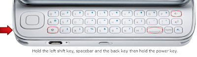

*NOTE if you own a nokia n97 then the second option is:
2-c). Hold the left shift key, the spacebar and the back key then the power key, hold them until the device asks for the country etc.N97 Diagram
If your device fails to boot up or gives a contact the retailer message then a hard format on boot will usualy sort the problem.
