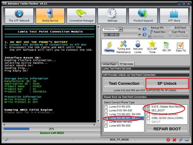

Nokia Lumia 800 unlocked done via TP by ATF Nitro
Phone is from UNITED KINGDOM
CABLE USE:
- modified RJ45 cable from old nokia fbus cable of twister box
- mini USB 5310 cable or CA-101 usb cable
PROCEDURE:
-Disassembled phone first
- Now soldered TP and connect modified RJ45 cable to ATF box
- and make MINI USB as your power supply that connected to PC.
- Test point
- run ATF software
- select model 800 : RM-801
- click TEST CONNECTION
- put check LUMIA 800 RM-801
- then click SP UNLOCK
- after unlocking process assemble the phone
- power on phone with any simcard
- enter 00000000 as your PIN
PHONE UNLOCKED DONE

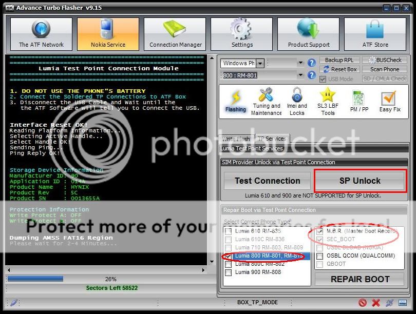

- now using GLOBE sim card
CABLE USE:
PROCEDURE:
- Test point
- run ATF software
PHONE UNLOCKED DONE
