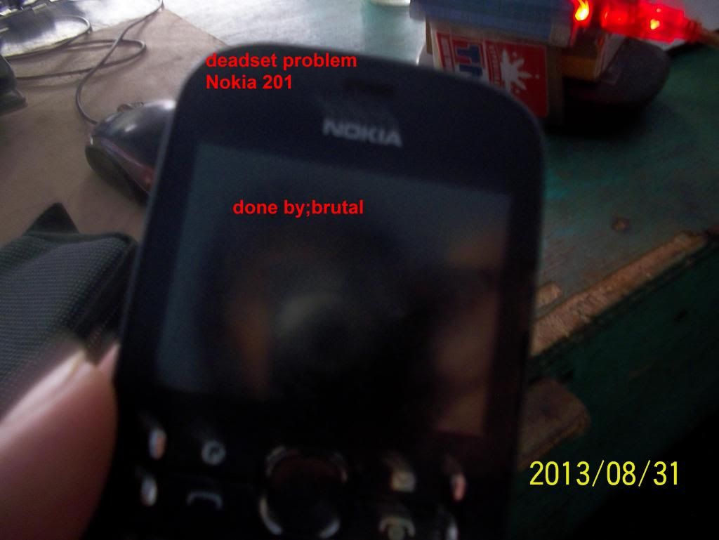

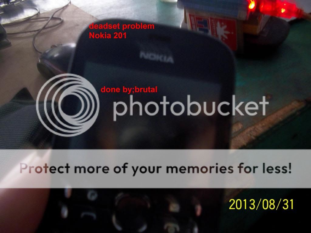

nokia asha 201 deadset done by hwkbox..
hi, goodmorning..
MODEL- nokia asha 201
PROBLEM- deadset
TOOLS- hwkbox

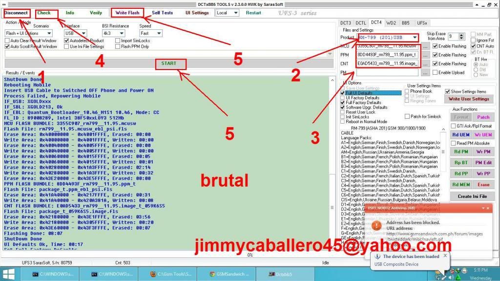

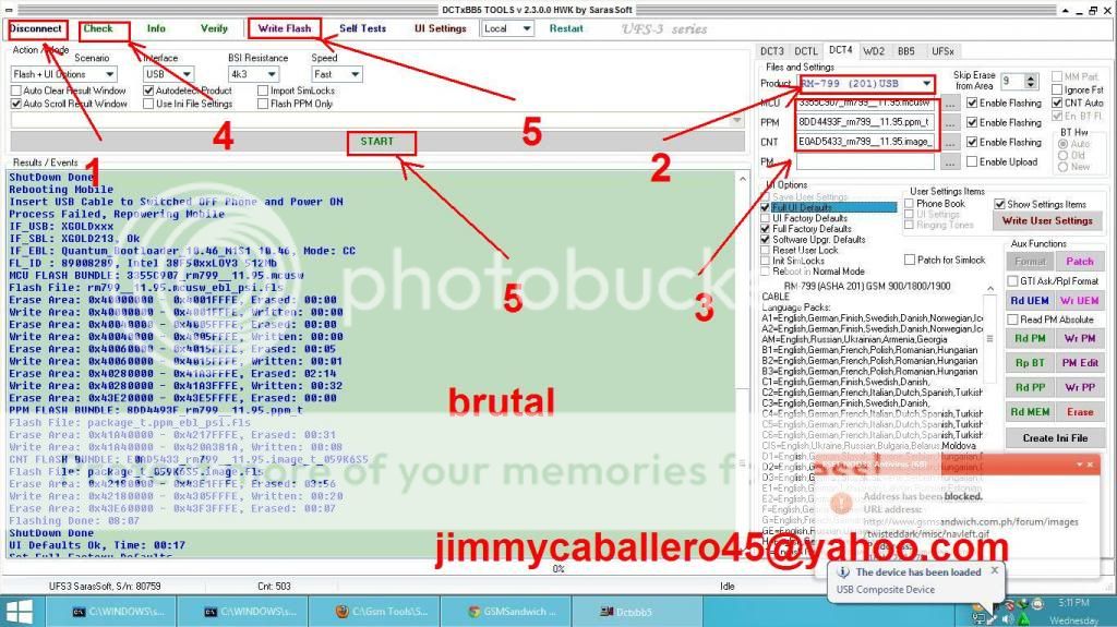

ACTION TAKEN heres the picture..
logs..

procedure see by numbers..

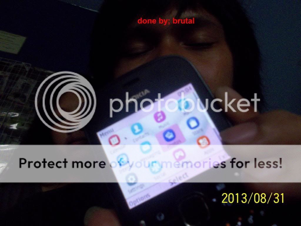

after procedure done..
testing
finish..​
