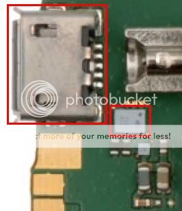

2)usb flashing time computer show usb error?
must check usb connector usb controll driver(remove usb esd)

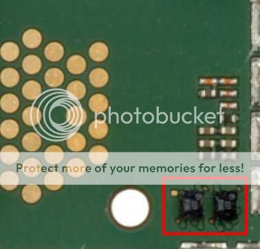

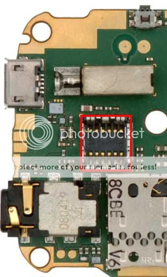

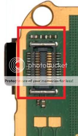

B1)open handset then check display connector or change display(display also make this problem)
2)remove camera and power on phone with battery,phone still same problem(nokialogo then trun off)???

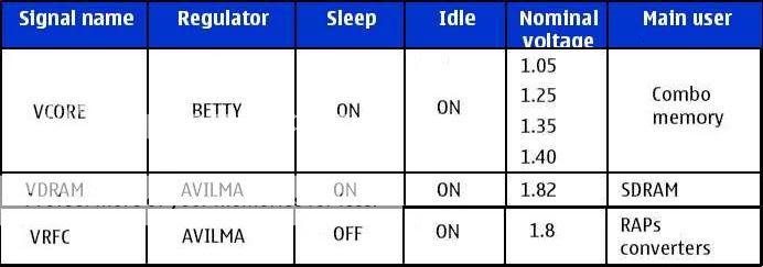

3)check vcore,vio,vdram vrfc volt
this 4 volt controlled by combo ic
vdram,vrfc,vio volt controlled by AVILMA
Vcore controlled by BETTY
this 4 volt is prefect???then one thing is conformed avilma betty working fine

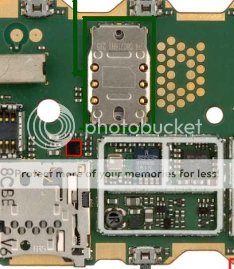

4)reflow or change keypad ic
5)Remove MMC ic

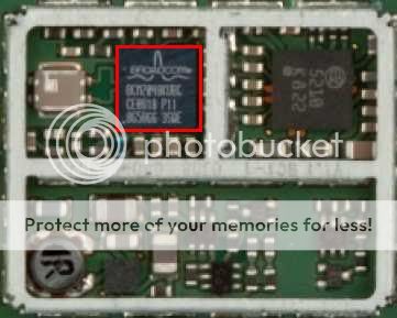

6)BT ic also make this problem(6120 75% nokia trun off bt ic)
