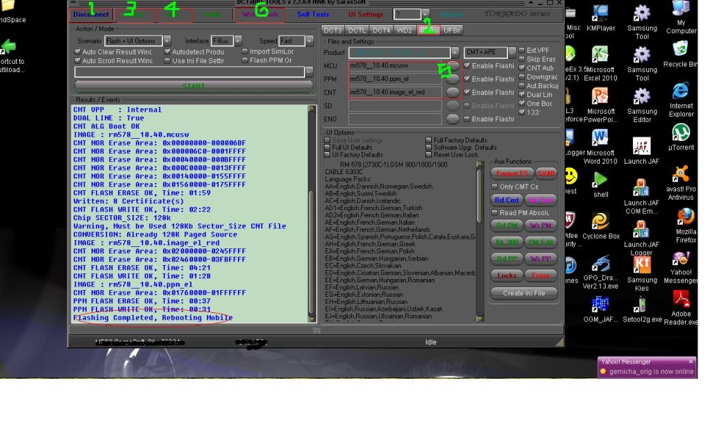

nokia 2730c-1 on retart problem???
status:
on retart

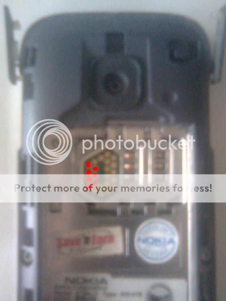

with pinout
action taken:

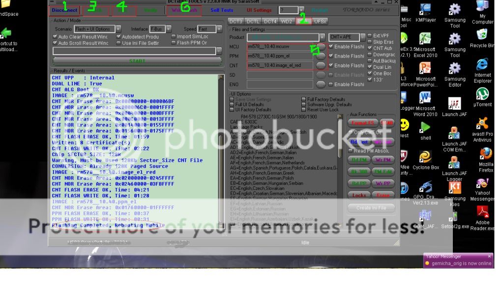

open hwk box din cable ufc 7pin
*click connect hwk
*click select bb5
*click check
*click read info
*click reload file version 10.40
*click write flash
1ST BOOT : C0,07 [Rm-578] [2.2.0.0]
CMT ASICID: 000000010000022600010006030C192101023000
EM 1 ID : 00000296
EM 2 ID : 00000B22
CMT PUBID : 16100110BD1B8D568F57B9B158687542620C1BA8
CMT MODE : 00
CMT HASH : 9DDBFCFE6E73CED7D8C6268C8EB85723
CMT ROMID : 273F6D55DFAAF68F
CMT 1ST Boot OK
CMT FLID0 : 00898982-00008A31, Int NU48F512
CMT MCID0 : FFFF0000-00000000
CMT 2ND Boot OK
CMT ALGO : RAP3Gv3_algo_v1331.fg, Ver: 1.33.1
CMT KSIG0 : 8669C77551AE1280331BBAE6FD0C7CB3D3F44CC1
CMT VPP : Internal
DUAL LINE : True
CMT ALG Boot OK
IMAGE : rm578__10.40.mcusw
CMT NOR Erase Area: 0x00140000-0155FFFF
CMT NOR Erase Area: 0x01560000-0175FFFF
CMT FLASH ERASE OK, Time: 01:59
Written: 8 Certificate(s)
CMT FLASH WRITE OK, Time: 02:22
Chip SECTOR_SIZE: 128k
IMAGE : rm578__10.40.image_el_red
CMT NOR Erase Area: 0x02000000-0245FFFF
CMT NOR Erase Area: 0x02460000-03FBFFFF
CNT FLASH ERASE OK, Time: 04:21
CNT FLASH WRITE OK, Time: 01:28
IMAGE : rm578__10.40.ppm_el
CMT NOR Erase Area: 0x01760000-01FFFFFF
PPM FLASH ERASE OK, Time: 00:37
PPM FLASH WRITE OK, Time: 00:31
