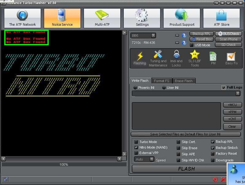

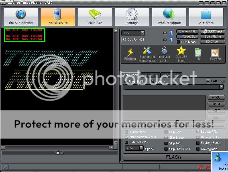

J josher Well-known Member Joined Sep 5, 2010 Posts 6,745 Likes 176 Aug 27, 2011 #1 Go to device manager Box Eeprom Damaged Go This Root Folder Open Mprog(Careful Dont Connect any Other boxs(ONLY ATF)
J josher Well-known Member Joined Sep 5, 2010 Posts 6,745 Likes 176 Aug 27, 2011 #2 Go This Root(C:\AdvanceBox Turbo Flasher\Driver\MProg 3.5 Release\Templates) And Select This New Eeprom File After Update Eeprom Open ATF Exe (Look Here) Aft Said Need To Update New Atf Driver!!!! Go To Device Manager Then Update Ur Atf Driver C:\AdvanceBox Turbo Flasher\Driver\ATF_NEW_DRIVERS After Make Update Driver We Must Restart Ur Pc.Now Box Ready To Use And Serial Number Restored
