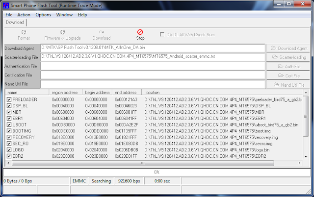

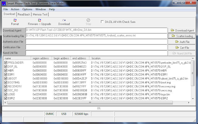

- First of all open SP Flash Tool, then click Scatter-loading button to load the correct scatter file
(MT6575_Android_scatter_emmc.txt or MT6577_Android_scatter_emmc.txt, depending on which phone you have) for your device and ignore any message that may appear.

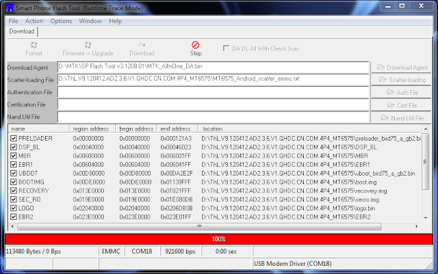

- Press F9 (or hit Download button) and connect your phone into the computer via USB data cable.
The process will start and a red progress bar will appear.

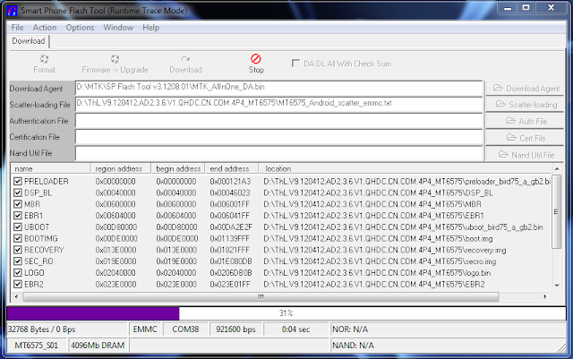

- After the red progress bar is complete, there will appear a purple progress bar.
- Right after the purple progress bar is complete, a message will appear underneath it:

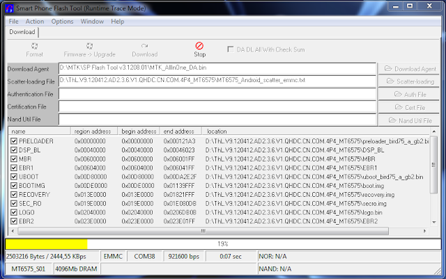

“Please insert USB cable in x seconds” and then the download will start right away (you will see the yellow progress bar filling up).

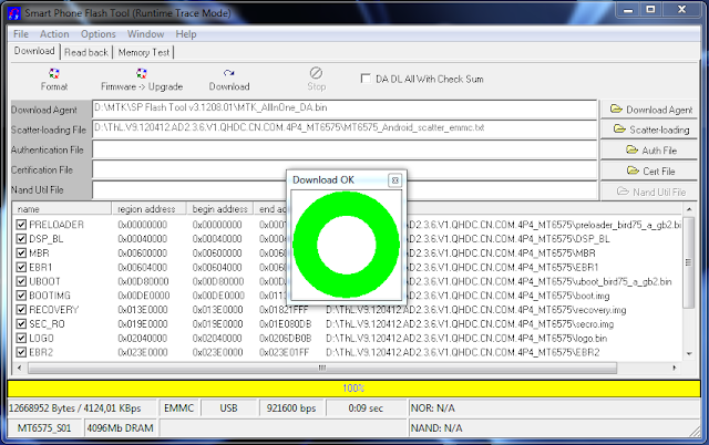

- When the yellow bar is complete, you'll get a popup with a green circle and Download OK message,
which means that the process has been successfully terminated.
