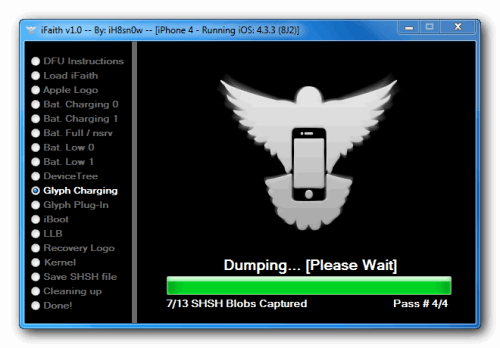

These are instructions on how to dump the SHSH blobs of your current firmware even if Apple is not signing.
For instance, you can dump the SHSH of the current firmware on your device, so long as the device is susceptible to the Limera1n jailbreak (Everything but the iPad 2) Apple does not have to be signing the SHSH in order for you to dump the blob.

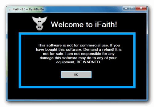

A disclaimer will appear. Read the notice and click ok to proceed.

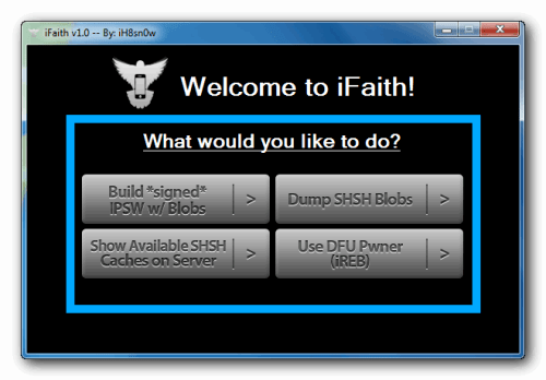

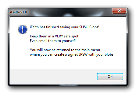

Click the Dump SHSH Blobs button
Step Five
Read the information and click Proceed when you are ready.

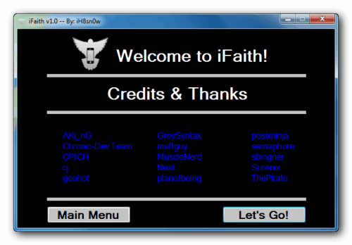

Finally, click the Let's Go! button to start the dumping process.

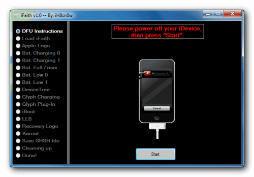

Follow the DFU Instructions to place your device in DFU Mode. You can find more on entering DFU mode here.
Press Power and home for 10 Seconds
Release the power button, but keep holding the Home

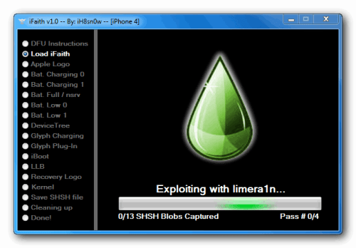

*Note the iPod Touch 2G and iPhone 3G will not work since they will always be jailbreakable. The iPad 2 will not work because it is not susceptible to Limera1n. A jailbreak is not needed for this.

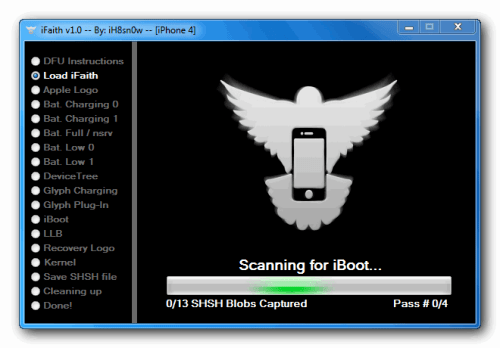

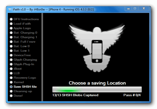

Step Five

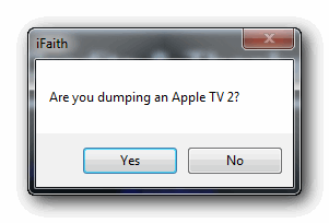

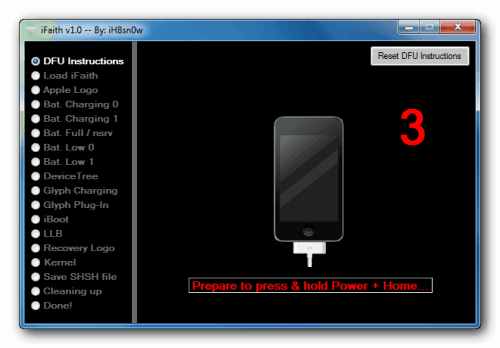

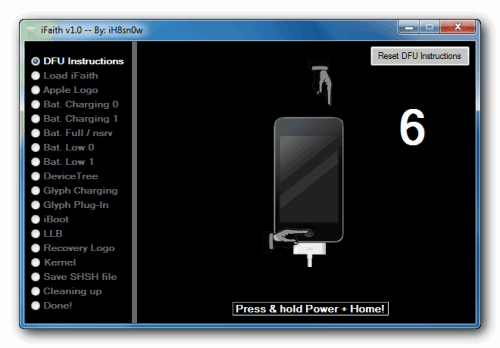

Step Six
If you are dumping an Apple TV 2, indicate it when iFaith asks you
