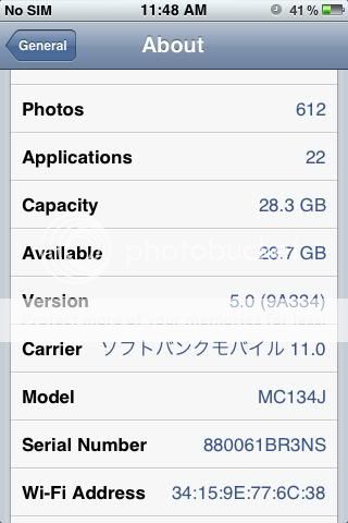

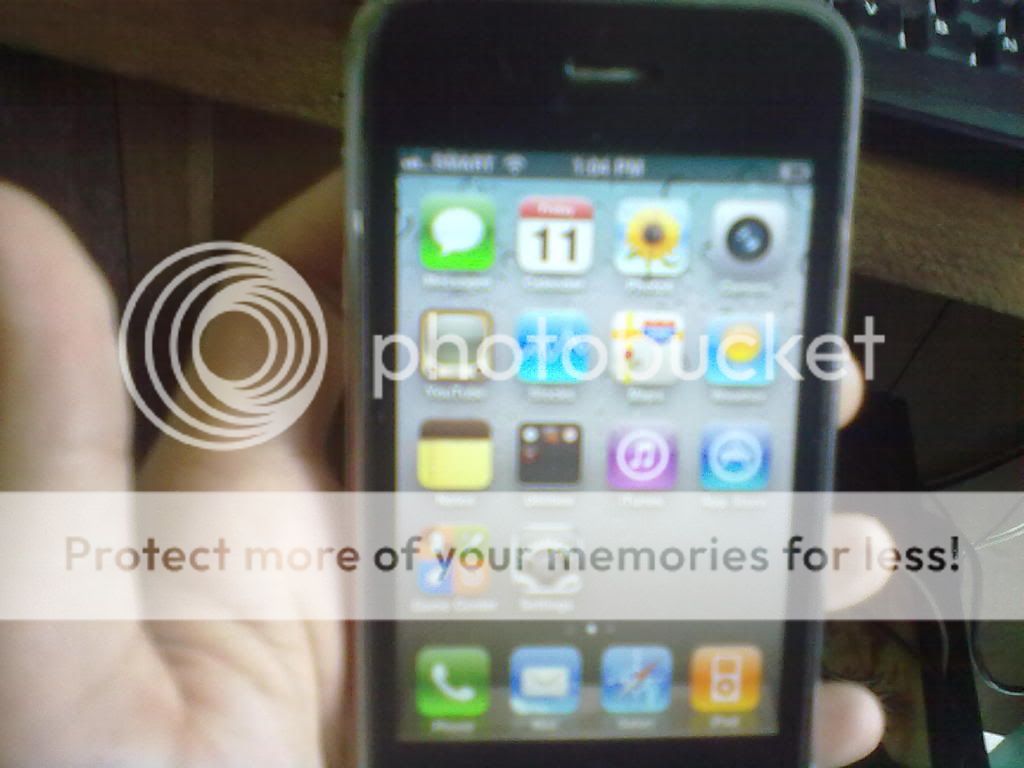

Iphone 3gs 5.0 Downgrade to 4.1 And Unlock done ( Old Bootrom)

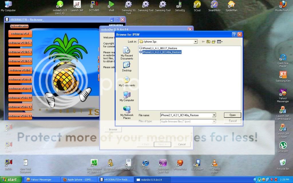

derecho na tayo sa Redsnow

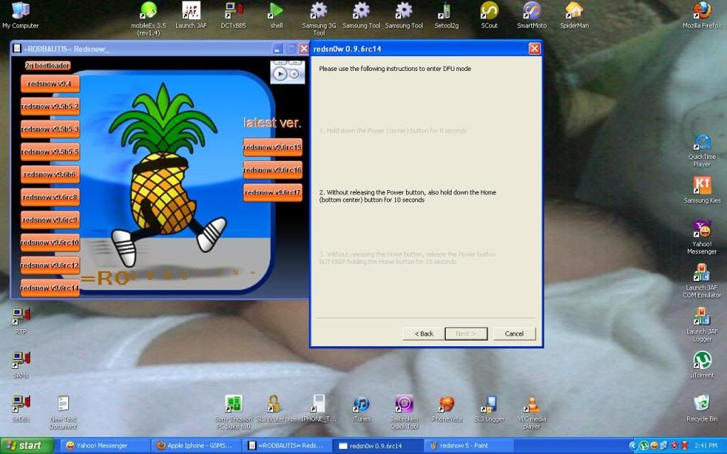

redsnow part 1
redsnow part 2

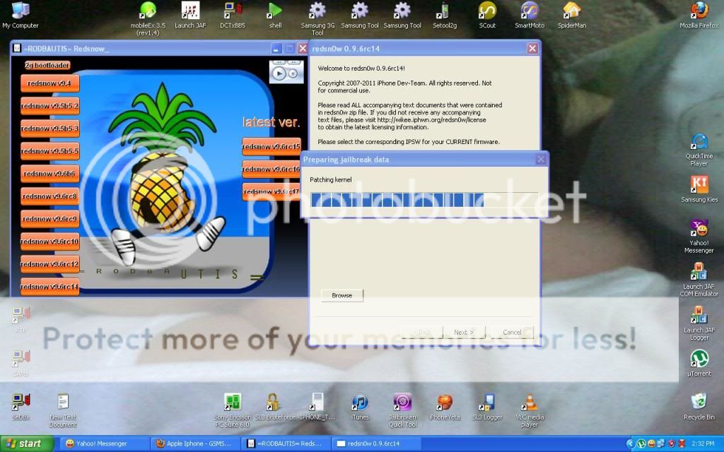

7: Use Redsnow 9.6rc14
8: Add 4.2.1 firmware
9: Read first then click YES
10: Click Nxt

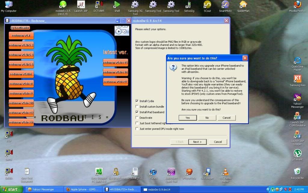

11: Check Cydia and Ipad Baseband then click YES
12: SUNDIN LANG ANG SUMUSUNOD PINDUTIN ANG POWER BUTTON NG TATLONG SEGONDO PAKTAPOZ NG TALONG SEGONDO WAG NYO BITAWAN ANG POWER BUTTON SABAY PINDOT NG HOME BUTTON NG SAMPONG SEGONDO PAGKATAPOZ NG SAMPONG SEGONDO BITAWAN ANG POWER BUTTON TAPOZ PATULOY SA PAG PINDOT SA HOME BUTTON 30 SEGONDO
Done

Done
