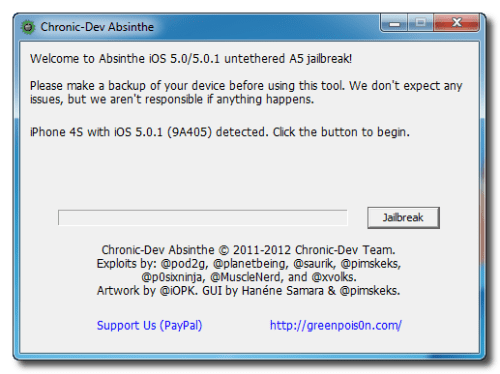

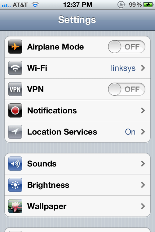

As prompted, connect your iPhone 4S to the computer via USB. Make sure to remove any passcodes or VPN settings you've previously set.
Step Four
Click the Jailbreak button to begin

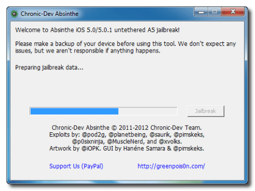

The application will take you through several steps of the jailbreak: Sending initial data, waiting for reboot, waiting for device to finish booting, Preparing jailbreak data, and Sending payload data.

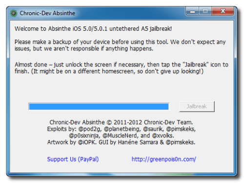

You will be informed that the jailbreak is 'Almost done'.
Step Seven
On your device, locate the Absinthe icon and press it to complete your jailbreak. It could be on any homescreen.

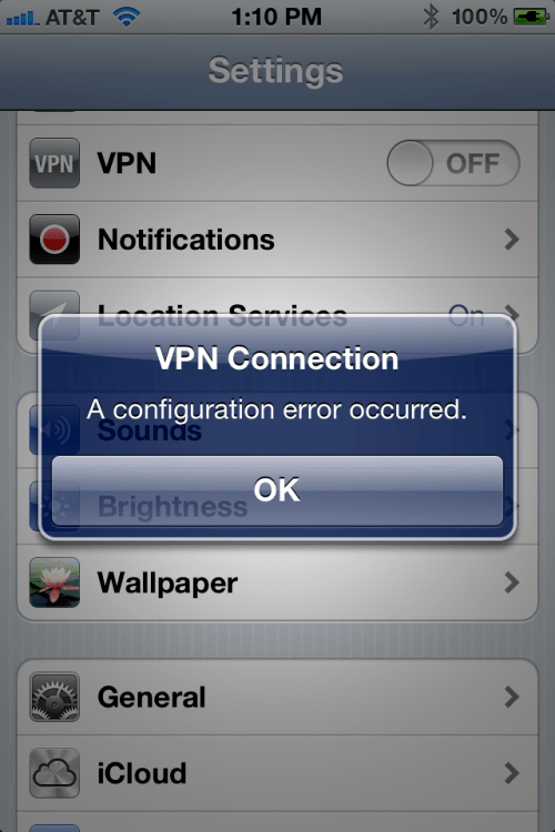

If the server is down and you get an Error establishing a database connection message then tap the Settings icon on your springboard and turn on VPN.

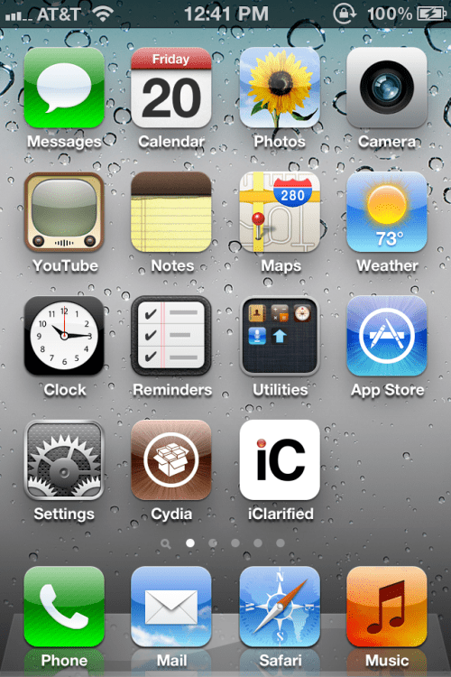

You will get a configuration error; however, after about a minute your device will reboot with Cydia on the Springboard!
