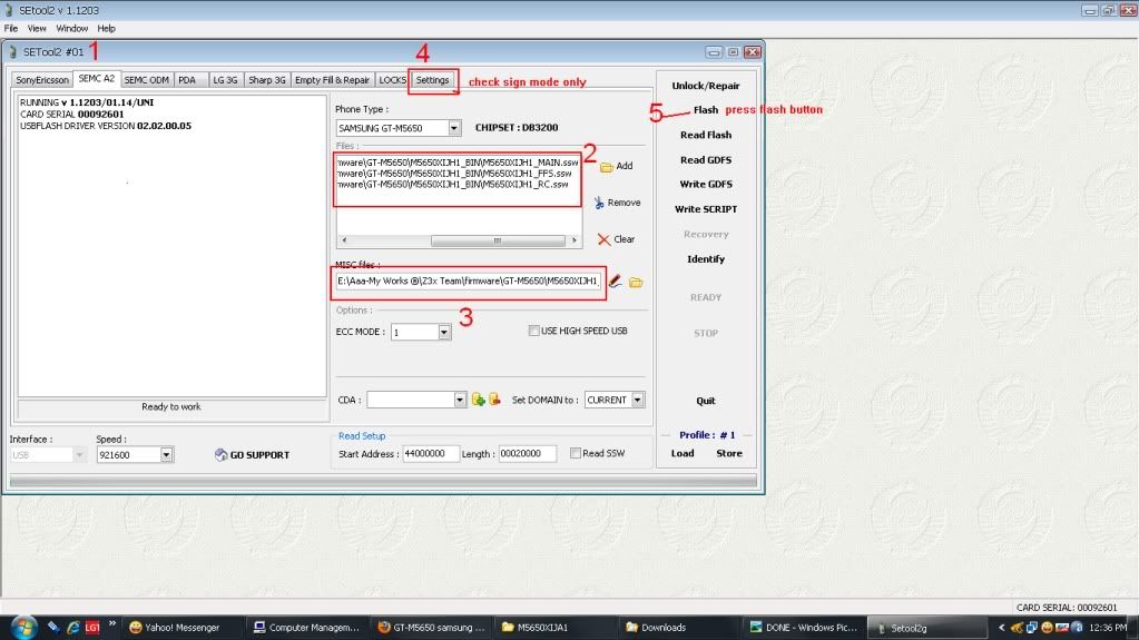

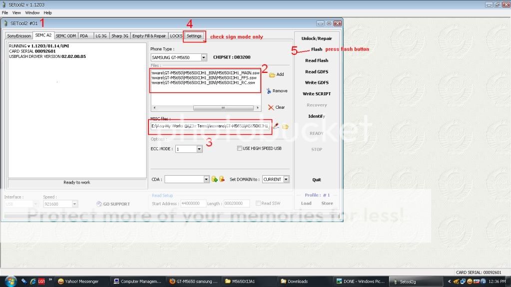

PROCEDRE:
1.open setool Goto semc a2
2. load firmware download here
4. put gdfs in MISC files. kasama po yan sa firmware pag na extract.
5.in setting check sign mode only
6.press and hold (volume down + camera) then insert micro usb
7.press flash button wait until finish
Note: kelangan fully charge ang battery kc kung kalahati lang ang laman ndi madedetect ang phone.
Step1:
Step2:

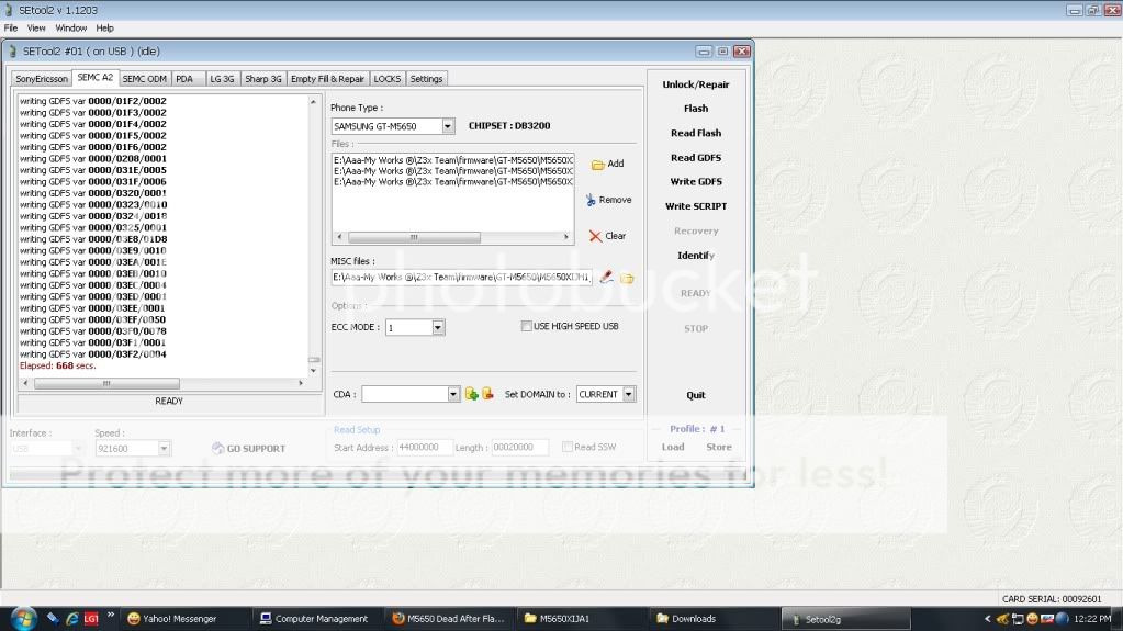

Hintayin Lang Matapus...

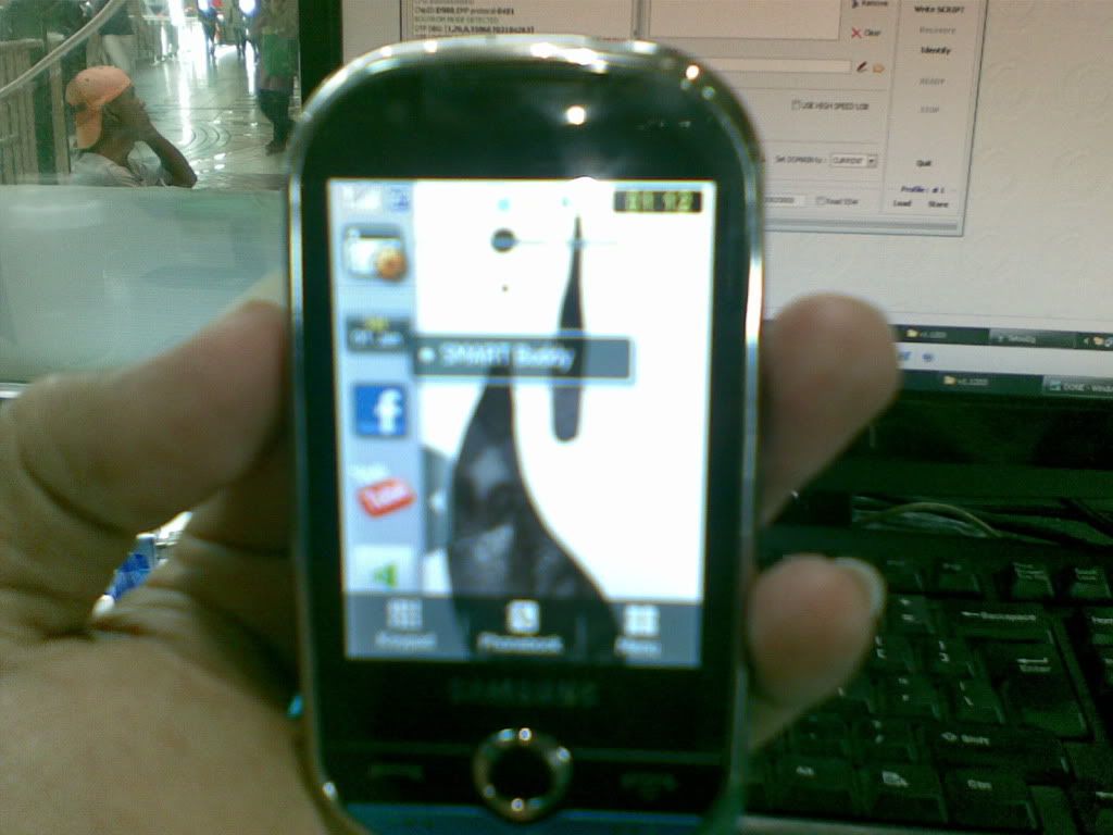

Done"
