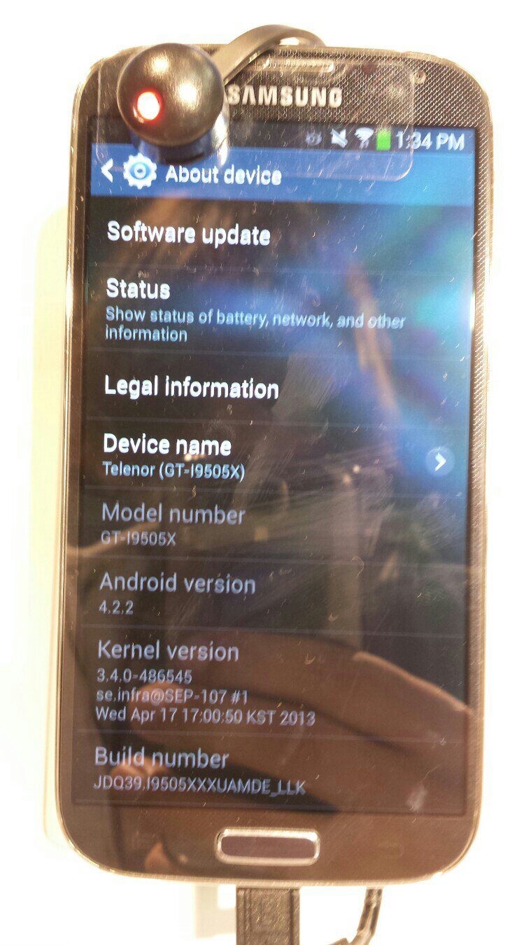

@NOTE : Don,t Flash Any Firmware To this Demo Phone
Becoz I9505 & i9505x Both not Same
and After Flash you will be lost The Phone Wifi
