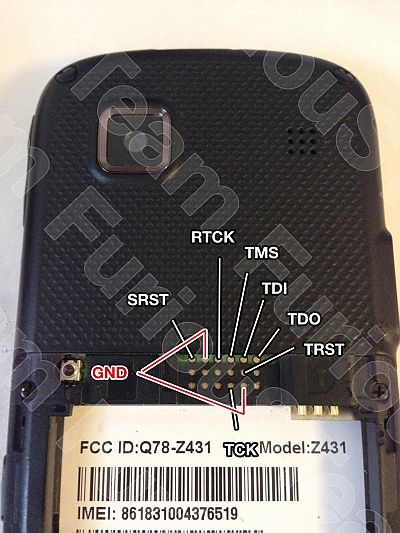

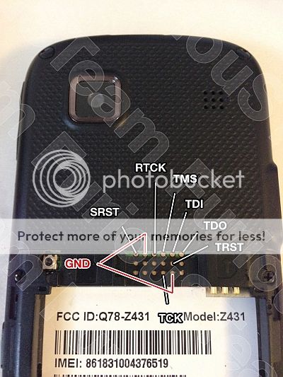

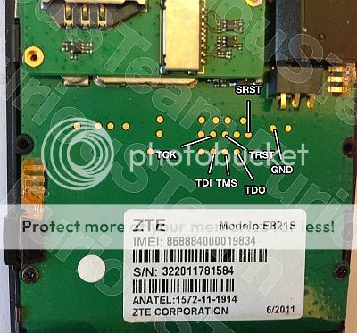

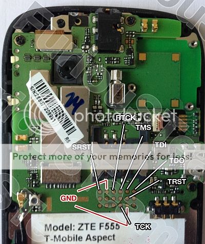

ADDED JTAG PINOUTS AND REPAIR FILES FOR DAMAGED PHONES (ORT JTAG/RIFF) :
[x] Z221, Z331, Z431, F555, F160, F100, E821S
HOW TO REPAIR USING ORT JTAG / GPG ORT ?
[x] SOLDER THE WIRES AND POWER SUPPLY THE PCB OVER USB
[x] START ORT V1.93 AND CONNECT THE PHONE
[x] CHECK 'RAW MODE' AND 'AUTO-ERASE'
[x] SELECT THE PROPER FILE FROM \REPAIR FOLDER (ex. F555_ASPECT_REPAIR_0x00000000_RAW_AUTOERASE_ORT.bi n)
[x] PRESS 'WRITE' AND ENJOY AND REPAIRED PHONE IN SECONDS
NOTE: IF PHONE HAS OTHER FAULTS ( NO IMEI, INCORRECT MENU, RESTARTS) THEN DO THE ABOVE STEPS BUT INSTEAD USE FULL FILES (ex.F555_FULL_RAW_ORT.rar)

JTAG PINOUTS
ZTE F555 / T-Mobile Aspect
ZTE Z431
E821S_S50_SKINNY_JTAG
