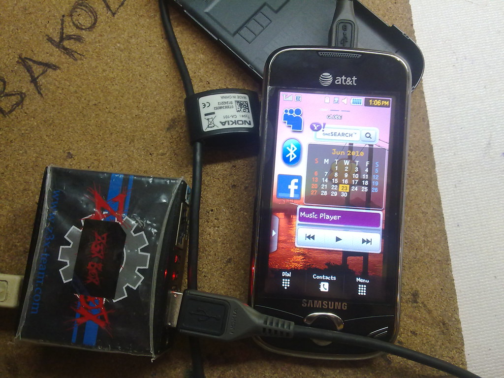

First Unlock A897 in New 3g tool's Of Z3X!
Tool's;
-Z3x Box [ Samsung_3G_tool_7.0 ]
-5310 Usb
Procedure;

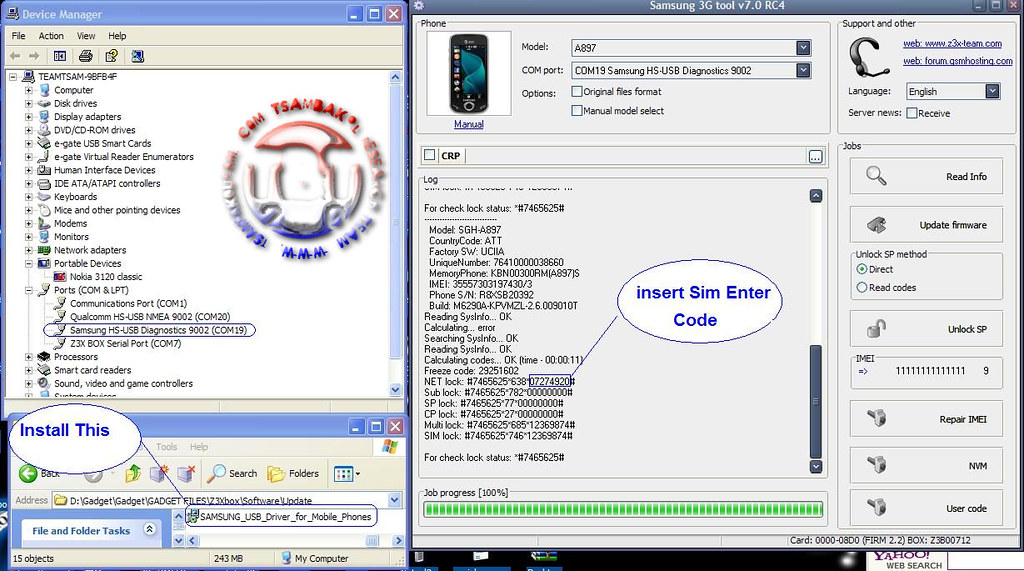

- Update your Box card firmware
- Install Usb Driver [ SAMSUNG_USB_Driver_for_Mobile_Phones ]
- Dont Insert your USB
- Tap keyboard then type *#782872# to puth the phone in qualcomm USB model
- Type *#197328640# on the phone then select 9-7-3 (USB--DIAG) on the phone
- Press end call to go back to home screen
- Connect the phone to USB cable
- Then type *#7465625# on the phone and leave the locks menu on the screen
- Open Your Z3x 3g tool's Select A897 model
- Select [ Samsung Hs0USB Diagnostics Com port ]
- Open The phone Insert Sim Card then Enter the Unlock Code
Image:
After Unlock :
