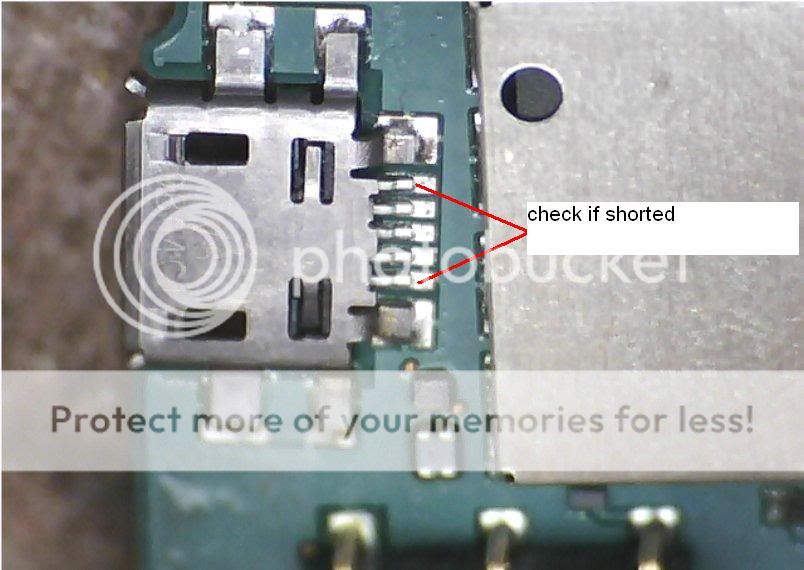

first i try to check charging terminal but working fine i check this
its shorted...

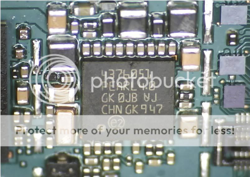

i change pearl ic or power ic same problem

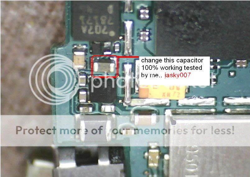

this is your solution
you can take it in n70 check in schematic c2012
