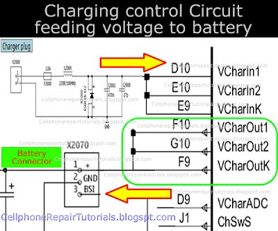

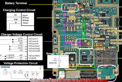

3.3 Power Supply
3.3.1 Power up / down (On / Off)
The process to turn the phone is not the same as ordinary electronic circuits such as radio, etc. TV. At almost the same phone system with a computer, where the process does not turn on or turn off by disconnect power to the power supply. In the actual computer system if given the power, the system has functioned only in the inactive state, when in analogikan to humans in a state of sleep, which the system will be ready whenever given the command to activate all systems. That's because when the phone has the battery then plug in battery voltage will go straight to the IC power supply, while at the same power supply IC will provide voltage to the processor. SW circuit On / Off cell phone you can see in the image of this diawah.
3.3.1 Distribution voltage
Circuits in cell phones there are many subsystems, which each sub-system has a voltage supply needs of different and at each voltage when the system will be given when necessary. Power given by the first mobile phone battery, the voltage from battrey will continue to power supply IC, the IC power supply voltage supplylah all will be provided depending on needs.
3.3.1 Battery Charging
Mobile phone battery charging process is very thorough at all, whereby the charging system will be computerized. Battery voltage will be in diteksi by the IC power supply and CPU, if the battery in a full state of the phone will reject the filling of the transformer charger. This charging system is processed by charging IC.

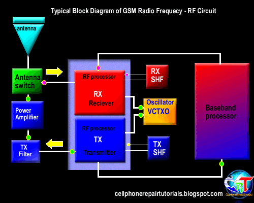

3.4 Transmission of information data
Basically, a transmission system in communication systems, there are two systems, the reception (receiver) that serves as reception of data or voice information, alphanumeric data and graphics from the base station to the mobile phone. While the transmitting (Tx) functions as a voice or data transmission information, alphanumeric data, graphics and network registration process
3.4.1 The registration process network
3.4.1.1 Initialization
The first time you make phone calls called by the initialization process. This occurs when you first activate your phone. You'll get a connection from the site terdekekat sell, then the cellular network will perform checks your account or membership is still active or not, then your calls will be processed further.
3.4.1.2 Inspection frequency list
Your phone will check the list of frequencies on your SIM. Inspection covers carrie frequency flow quality, then look for Broadcash Control Channel or BCCH. Each BCCH will transmit a unique data markers, membedan between AMPS and GSM. In the AMPS system uses a dedicated radio frequency system in each cell, whereas on all GSM frequencies can carry information, but more important is the channel used to stream data rather than radio frequency
3.4.1.3 Identification of information
Base station or Broadcash Control Center will continue to deliver for the identification of information about the sell the site. The identity of the wireless network is Carreier itself, then the area code location, and frequency yag used, as well as information about the surrounding cells. All information is used to determine whether your phone is active and in need of service. BCCH is not a radio frequency didedicated. BBCH will use the channel that will carry information in the form of bits at all frequencies within a cell.
3.4.1.4 Control Channel Control Inspection Broadcash
Cell phone radio frequencies will conduct examination bradcash control channel, where your phone will send a signal to review whether the signals are still within range. The phone will be like a radio scanning the entire list of BCCH frequencies one by one and check the signal reception. Measurements will be conducted at each level of the channel. Cell site will send a strong signal to your phone. Meanwhile in broadcash control channel is a mobile data stream from the monitor did ase station called frequency control or frequency control channel burs burs (FCCB). Your mobile phone signals will synchronize with the system provider with wireless connection means. Once your phone has been communicating with the base station, then everything is ready for use.
3.4.2. Transmitting information data
3.4.2.1. signal processing of voice data, graphics, alphanumeric.
While mobile phone users are communicating, then the sound wave signal generated by mobile users will travel through the air. Gelobang voice signal will be received by the microphone to be converted into electromagnetic waves. And will proceed to the audio processor to be strengthened and processed.
If mobile phone users to sms, then type the command on the keyboard by mobile phone users will be processed by the CPU (Central Proccesor Unit)
3.4.2.2. changes in the digital signal into an analog signal (D / A converter).
In this section the data signal information is converted into an analog signal form. Because the RF section is still using an analog signal is shaped in part while the main processor in the form of a digital character. This needs to be an adjustment between two different characters that can be interconnected.
Furthermore, the data signal information already in will continue to convert the RF section.
3.4.2.3. Mixing the data signal with the carrier signal.
Information data signal will be sent to the base station, surely there must be a data signal carrying the information. Therefore, the information data signal will be mixed with the carrier by the RF signal processor. Carrier signal on GSM technology has a 900-1900 MHz frequency range, these waves are initially generated by the VCO, where the VCO will generate a wave of 3420-3840 MHz, which would then be in if the RF processor.
After the data signal information mixed with a carrier signal will then proceed to the section is called the modulation penguatan.sistem.
3.4.2.4. Strengthening end
Signal data information that has been mixed with the carrier signal will be received by the base station, while the distance to the mobile phone base stations far enough. Then the signal has to be really strong to be received by the base station. Then the signal must be reinforced by the PA Power Amplyfier. When strengthening the end of the delivery is not functioning properly then the phone will not be able to register network to the operator, this is caused because the base station can not receive the data signal information from mobile phones.
3.4.2.5. Distribution of Transmission lines
Once confirmed then the signal will be continued to the antenna switch for connecting to the antenna. Antenna switches can be in analogikan like airports, where in the data transmission of information in cell phones, there are two pathways, namely receiving and transmitting. So without the antenna switch on the received signal with the signal to be emitted will collide with each other, because there is only on GSM technology, there is one lane with a system called TDMA.
3.4.2.6. Transmitting to the base station
The next signal will be emitted through the antenna to the base station. Antenna will determine the outcome of the broadcast, then the signal is weak or strong depending on the quality antennanya.
3.4.3. Receipt of information data.
3.4.3.1. Receiving data from the base station
Signal emitted by the base station information to be received in advance by phone antennas. And then be forwarded on to the antenna switch for forwarded to the LNA.
3.4.3.2. Distribution of transmission lines
In order for transmitting signals do not collide with the signal reception, it will be first divided transmission signal by the antenna switch.
3.4.3.3. Strengthening early
So that the signal can be received well by the RF signals emitted by base stations will be strengthened first by the LNA (Low Noise Amplyfier). LNA not only functioned as a reinforcement, but can enable the cutting noise (sigh).
3.4.3.4. Separation of the carrier signal with the signal information
Signals generated by the LNA still mixed with a carrier signal, in order to be processed by the DSP (Digital Signal proccersor) then the data signal information must be separated first by the RF processor. This system is called the frequency.
3.4.3.5. changes in the analog signal into digital signal (D / A converter).
In this section the data signal information is converted into digital signal form. Because the RF section is still using an analog signal is shaped in part while the main processor in the form of a digital character. This needs to be an adjustment between two different characters that can be interconnected.
Furthermore, the data signal information already in the convert will be continued to the main processor (CPU). When the data signal is a voice tersubut information will be continued to the audio amplifier.
3.4.3.6. Strengthening the end of the voice signal
When the data signal information is voice data, it will be reinforced by an audio amplifier terlabih first before continuing to the speakers. Audio signal will be converted into electromagnetic waves, then needs to connect to the speakers so that the electromagnetic signals into sound signals which propagate in the air to be heard by people ears.

How does Charging Circuit Works from a Battery Charger to charge a Mobile phone Battery
This lesson is also important for charging problem troubleshooting for knowing which parts or components has being used to make a charging circuit. Many mobile phone technicians had been asking me, how does mobile phone charging circuit works?
How does a battery charger can charge a mobile phone battery?
To tell the truth many of them has never heard of this even they already fix thousands of mobile phones in their years of cellphone repair careers." and I am one of them.
I don't know but I know how fix it, its so easy" that's what we've oftenly said.
Well, we all know that all mobile phones are all battery operated handsets that needs to charge the battery so that it will continue working, failure to charge it will result to unable to power up the mobile phone handsets.
Here's a brief explanation of how charging circuit works,
I prepare this simple idea and diminished some electronics technical terms so that everyone without adequate knowledge on electronics technical terms might can catch up with this.
A charging circuit is composed of the following stages or sections.
1. Battery Charger Circuits - Although this is not found on mobile phones PC board circuit and have separate circuit but definitely this is also part of charging circuit; without this, the charging circuit is not complete and will not work completely.
This circuit is all parts and components that being mounted on any mobile phone charger, this is the one that converts AC (Alternating Current)voltage to DC (Direct Current)voltage.
What is AC Voltage? This voltage is a power source that we used in our household appliances to work and operate, this voltage can cause risk of electric shock and very dangerous to humans when being touch.This kind of voltage has an alternate polarity.
What is DC voltage? This voltage is a low level voltage which typically found on any kind of batteries.
This kind of voltage have two polarities, the negative and the positive.
Here's how the battery charger works, the 110 or 220 AC volts coming from the electrical outlet at home or etc. will be converted to a desired DC voltage like 4.5 to 6 volt DC because the phone only accepts and can be operated into small amount of DC voltage.
A DC voltage output of a charger is only an artificial DC voltage, why is that? because only a battery cell can produce a 100% pure DC voltage.
2. Protection Circuit- this circuit is composed of a Fuse, Inductor coil Diode and Capacitors, before the DC voltage reach to the charging voltage control circuits the protection circuit is the one that control and check if that voltage is in exact amount. Let say the desired amount of DC voltage is only 5.6 volts above that point the fuse will be blown out to stop the voltage to flow so that it prevents damaging to another corresponding circuits.
In a protection circuit below of Nokia BB5 mobile phones a diode is the one that measure the amount of voltage from the battery charger, this diode has a reaching point of desired voltage to measure of how much amount of voltage will be allowed to flow within that line, when exceed to that desired point of voltage the diode will then cut it off.
like for example if that diode is being designed that only allows only 7 volts from the battery charger to flow on that line. Now, above that desired voltage let say that the voltage becomes 8 or higher the diode will then be reacts and destruct itself, this is what then so-called shorted component; so that the current will flow directly to ground and will not reach to the following or corresponding circuit. If the diode will cut off or shorted the fuse will tends to blow and totally cut the voltage line. The inductor coil's role is to filter unwanted voltage saturation, it rejects abnormal voltage modulation caused by electrostatic interference.
3. Charger Voltage Control Circuit - This is the stage where the charger voltage and current is being stabilized, amplified, rectified, regulated and other voltage purification process is being held in this area before it feeds to the battery. This kind of circuit commonly being pack in a chips together with another circuits.
A failure of this certain area will result on charging problem status. This area mostly called by most technician as a Charging IC it is because this circuit is inside in a particular IC chips, but eventually this circuit also accompanied by many other circuit types and not exclusive to a certain charging area.
This pictures shows is the next corresponding circuit from the protection circuit area. The voltage from charger is now then feeds into three terminal inputs of the charger voltage control circuits.
in this figure shows after the voltage stabilization and purification process the voltage is now then feeds to the battery terminal.
4. Charging Control Circuit - this is the area where the charging process is being monitored, this is the one that sends information to the application processor to start or stop the charging process. This area is part of Power management circuit, so-called POWER IC by many technicians.
In this picture that there are two terminal signal from the voltage control that sends data to the Charging control circuit, this two data signals will inform to the charging control circuit that a charger voltage is being entered or plug-in. After this charging control circuits receives the data it will then analyze and convert that data into digital signal then sends it to the Application processor.
The application processor which is the brain of all the circuits now then decide if all the data's are in correct or in right information to begin the process,
It always relies on the data that sends by the charging control circuit, then decide all data and completely process it.
Okay now lets take an example and apply this particular method on a mobile phone circuitry component layout, I have here a Nokia N95 board, which is a good way to start with, while we still working on advance training. Now, try to analyze and compare all of those previous picture above and combined them into each corresponding stages or section, in this manner you can build an step by step tracing procedure on how to deal charging problem issues.
In the picture above shows, how and where the voltage flow from a charger voltage source through the entire PC board circuit. This is the the method where you can start and manage how to locate and trace each and every component to find possible problems regarding charging problem issues.
Understanding how RF circuit Works on Cell Phones
In cell phone repair it is very helpful to understand how the RF circuits works , for this is a big help when
troubleshooting No signal problem issues.
RF stands for radio frequency , this frequency is used to transmit and receive the data signals from a mobile phone.
Here's a brief explanation on how does RF circuit works on mobile phones.
This is for GSM RF circuit only, although the WCDMA circuit and WI-FI circuit have similarity on this but I will try to explain both of it hereafter.
See the block diagram below. Observe how the frequency data signal feeds from a certain parts of an RF circuit design.
A breakdown or failure of each certain part will result to signal loss and the capability to generate, amplify, control , process, send and receive the desired radio frequency during transmission process.
Click this bar to view the full image.
In mobile phones transmission there are two types of operation took place, the receiving operation and the transmitting operation.
In normal mode, RX part is always active in receiving operation the antenna switch is always open its gateway through to the RX circuit, It is always ready to receive and intercepts the radio waves and wait for the desired frequency signal to catch up.
During transmission like making a call or sending a text message the antenna switch will close the gateway of the RX and open the gateway of the TX in order not to interfere the data signal during transmission.
All data that has been receive and before to transmit or send, all this data signals are feeds to the baseband processor.
An explanation of an RF Circuit Parts and what possible problems if a certain part is damaged.
RF Receiver - ( RX radio receiver )
The rf receiver are called RX, this circuit is design to receives, and process the data signals from the airwaves during transmission process. A failure of this circuit will result to unable to receive data signal during transmission.
RF Transmitter - ( TX radio transmitter )
the rf transmitter are called TX which is the one that process, amplify the data signals from a mobile phone .
Once failed to initiate a failure to transmit radio frequency signal, this will result to unable to send data signal during transmission. .
Power amplifier - RF amplifier
The power amplifier is used to amplify, boost up the radio frequency signal before it feeds to the antenna before it thrown over the air waves during transmission. If damaged will result to signal loss.
The Antenna is used to intercepts and thrown the radio radio frequency in the air during transmission
When electricity is "thrown" into the metal of an antenna, the metal reacts to the electricity at an atomic level in the form of a wave.
if damaged or due to a corroded terminal pads, will indicate a show a poor signal or low level frequency signal.
Antenna switch
The antenna switch is used as a gateway that controls and manage the frequency to pass through, it switch the RX frequency signal and TX frequency signal during transmission process. literally the antenna is the signal catcher and likewise the signal thrower. If damaged the gateway to the antenna will be closed and result to network signal indication.
Crystal oscillator
Generates a desired frequency that feeds to the RX and TX circuits. In mobile phones a Voltage controlled Oscillator (VCO) and Voltage Controlled Temperature Compensated Crystal Oscillator (VCTXO) is used in rf circuit.
If damaged the RX and TX will not work and the RF cicuit is at full failure.
SAW filter
Surface Acoustic Wave filter used as an rf synthesizer to purify a desired level of frequency. If damaged result also to no network signal indication.
An example of the RF circuit components layout on a PCB board.
The rf circuit components are often covered with shielding metal case unlike the baseband processor parts which is oftentimes not. This is because frequency is very vulnerable with unwanted radio waves interference and destroys data signals. Using the shielding metal will minimize the radio waves interference.
