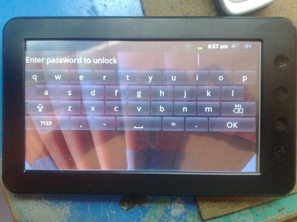

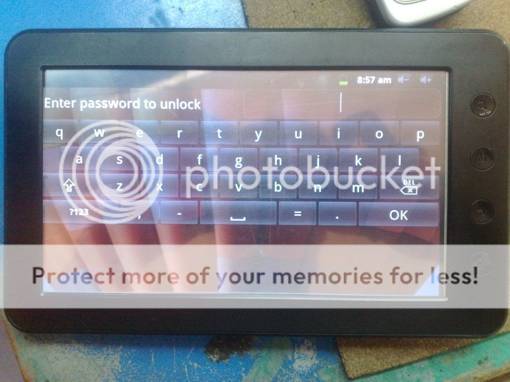

Unit and problem:

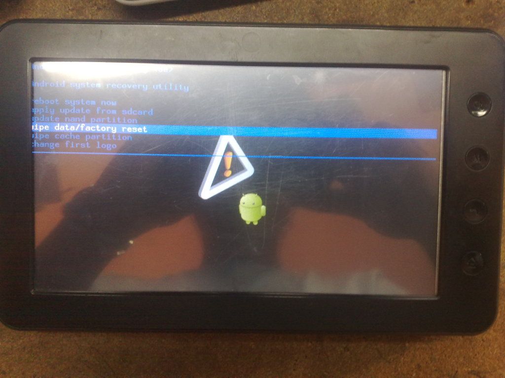

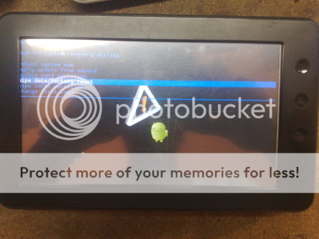

Fully turn off the unit...

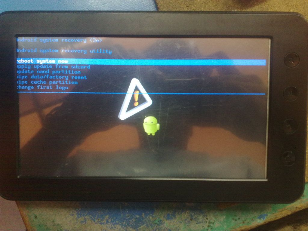

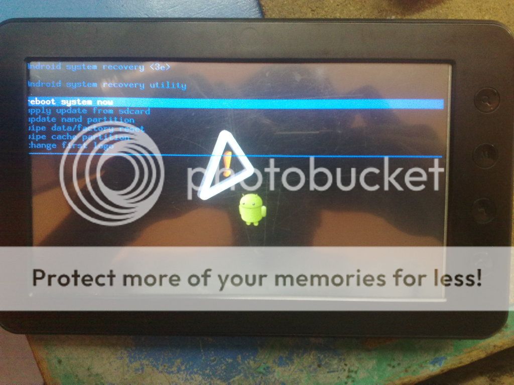

Press and hold BACK BUTTON together with POWER SWITCH...Until this is appeared...
choose wipe data/factory reset

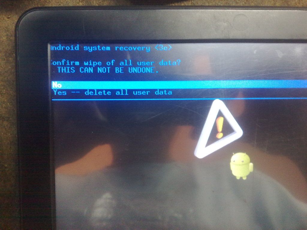

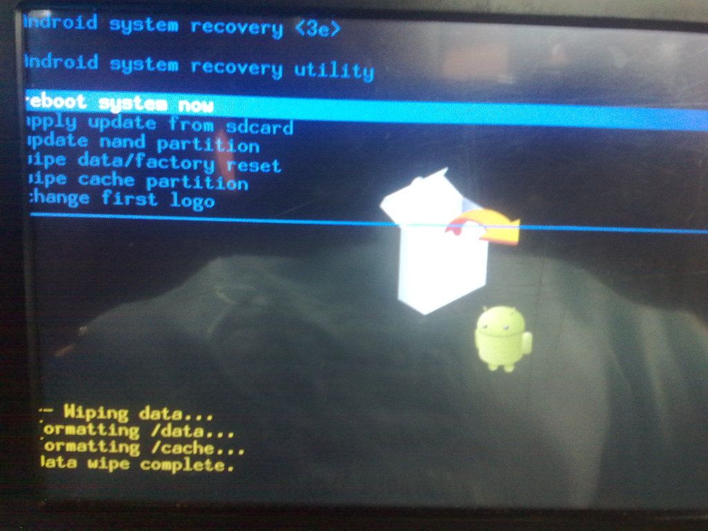

choose yes...

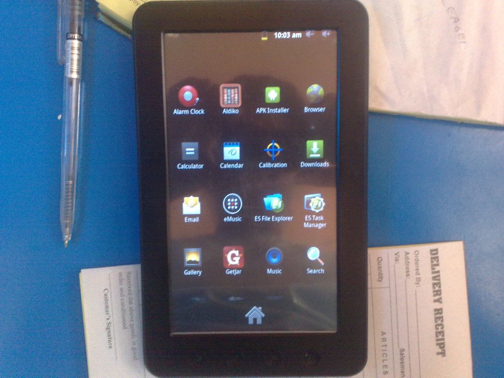

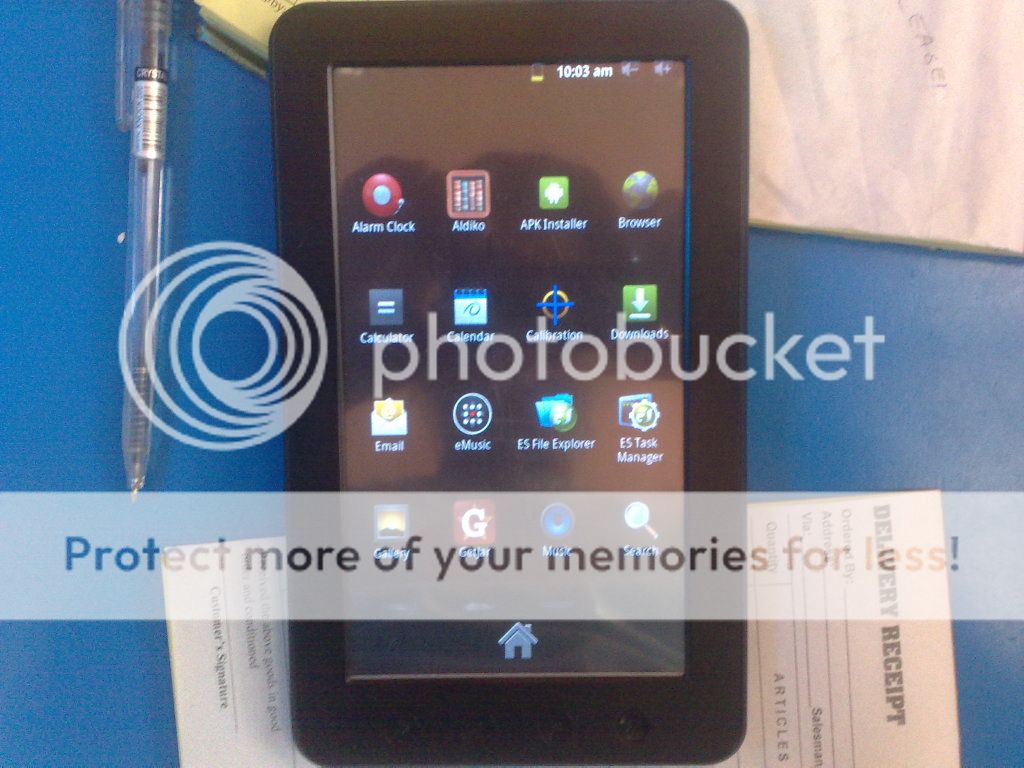

then reboot
and your done....
