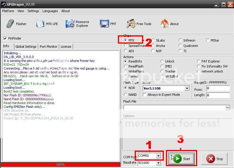

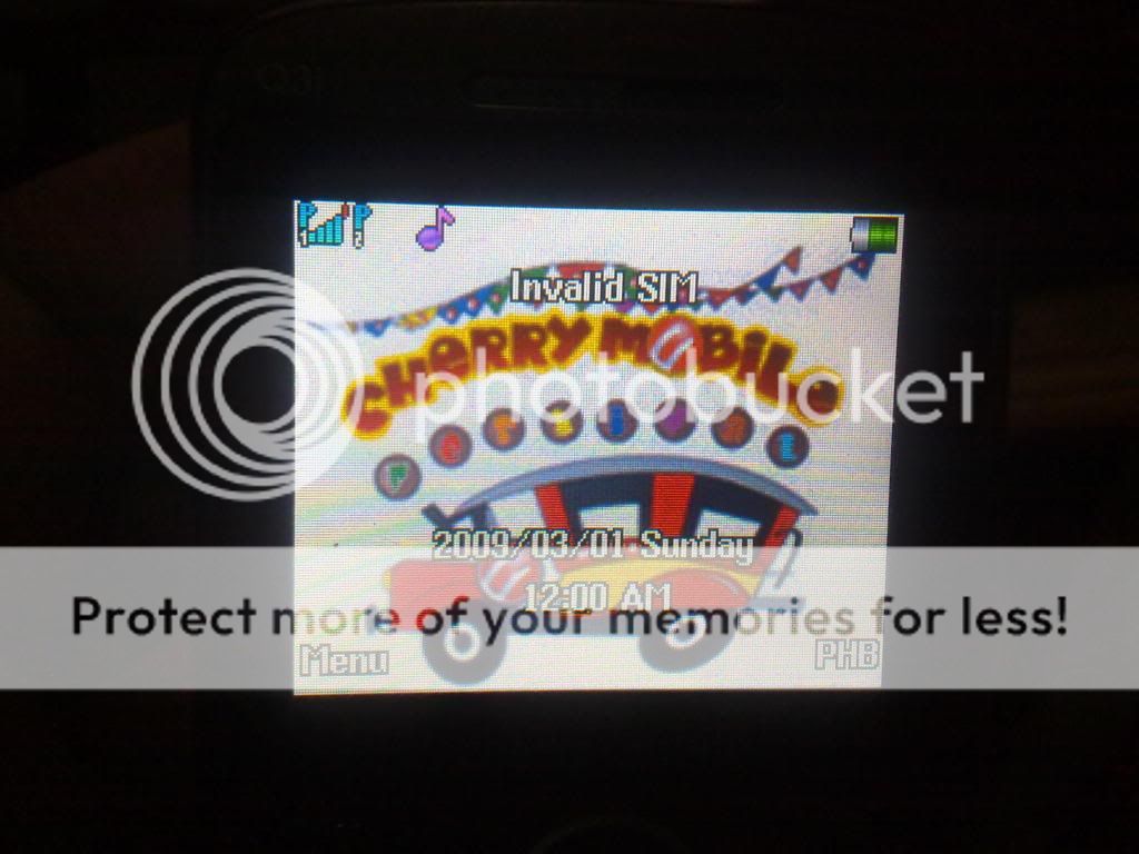

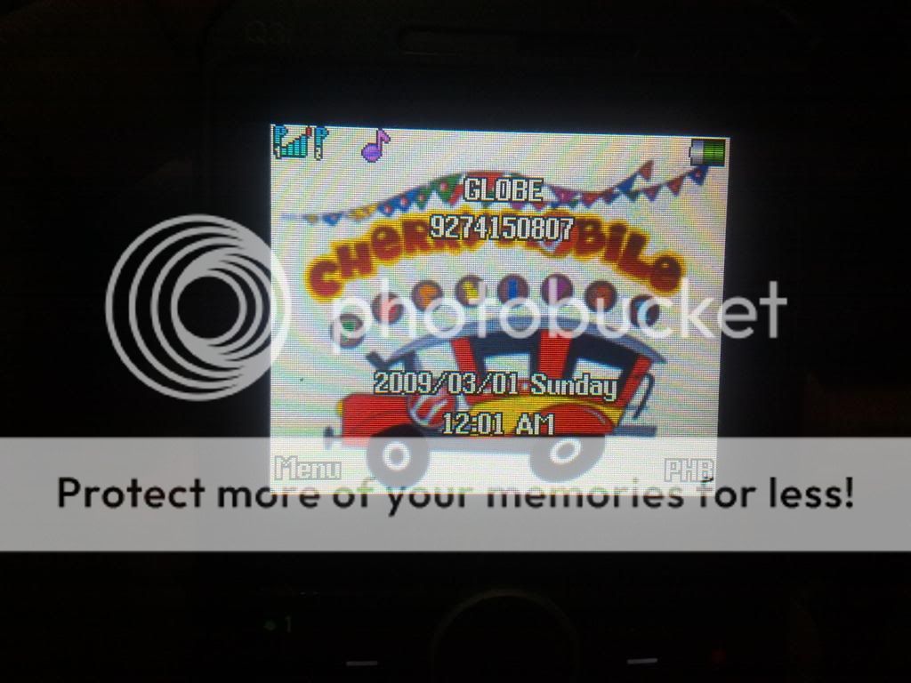

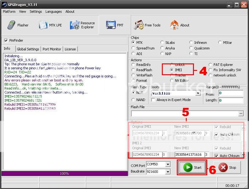

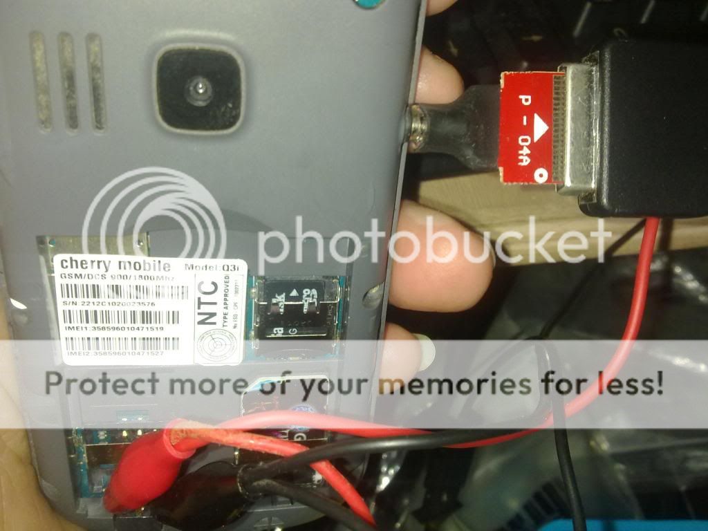

Q3i Procedure:
Open Dragon
Select Port
Click Start
Select MTK
Tick IMEI
Check Rebuild & Auto Chksum (Both)
Connect Phone (use P-04A Jigs)
Click Start Again
Press Shortly Power Button
Wait till DONE...
Q3i Invalid Sim
Screen Shot
P-04A Jigs
Finished Product

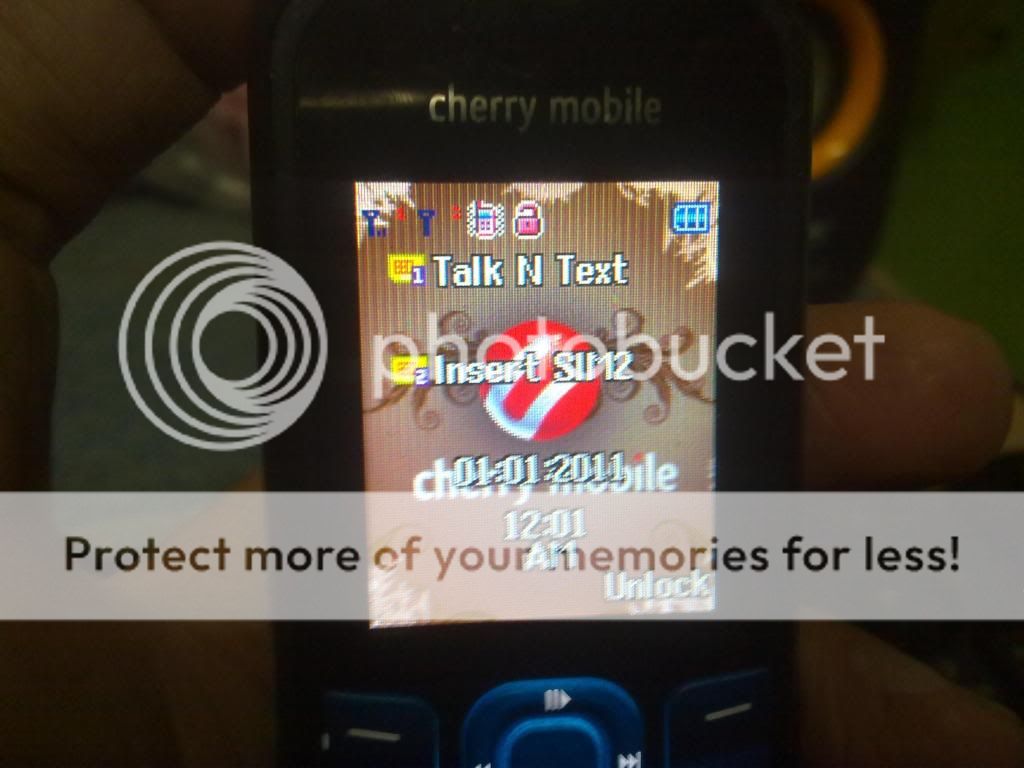

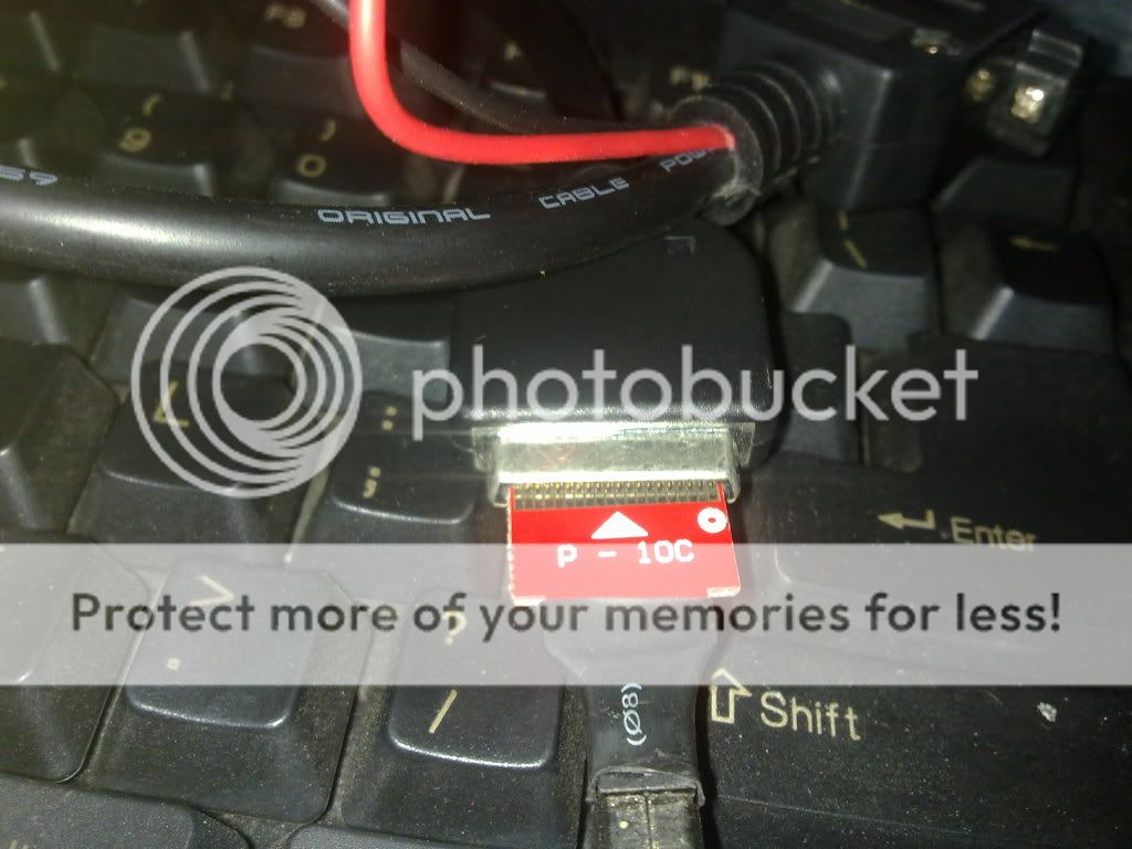

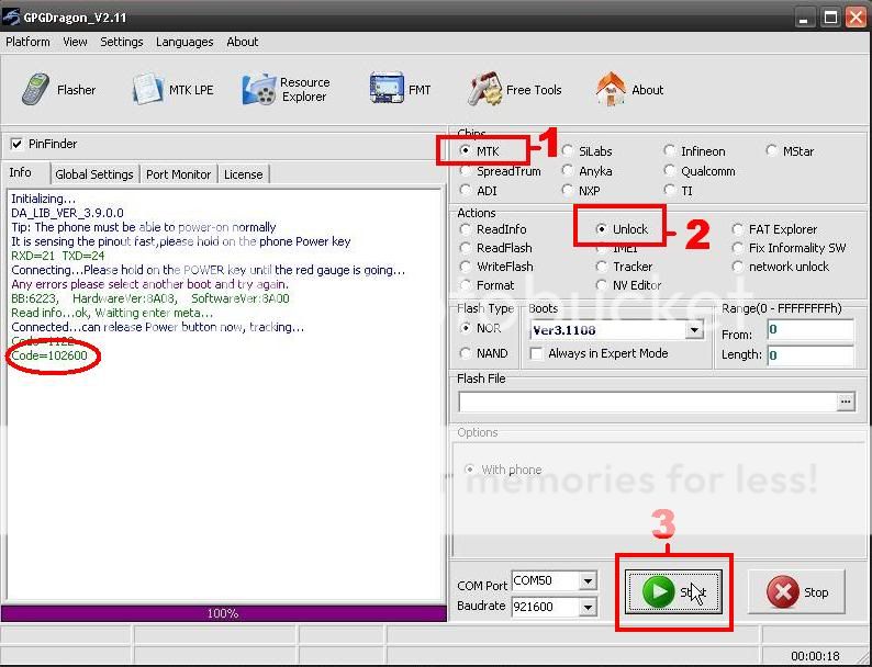

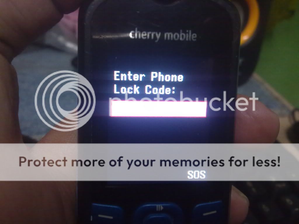

D13 Procedure:
Open Dragon
Select Port
Click Start
Select MTK
Tick Unlock
Connect Phone (use P-10C Jigs)
Click Start Again
Wait till DONE...
D13 Lock Code
P-10c Jigs
Screen Shot
Finished Product
