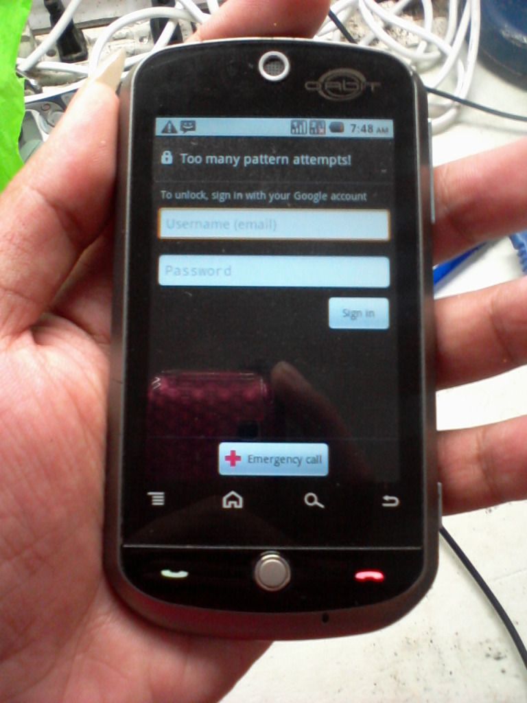

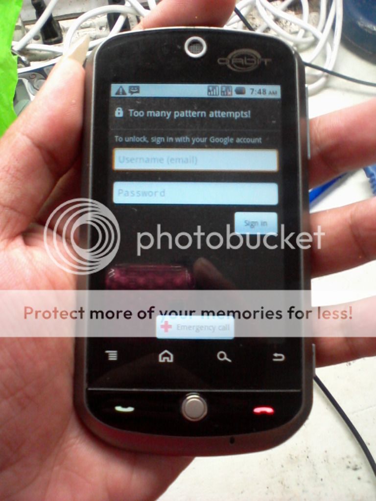

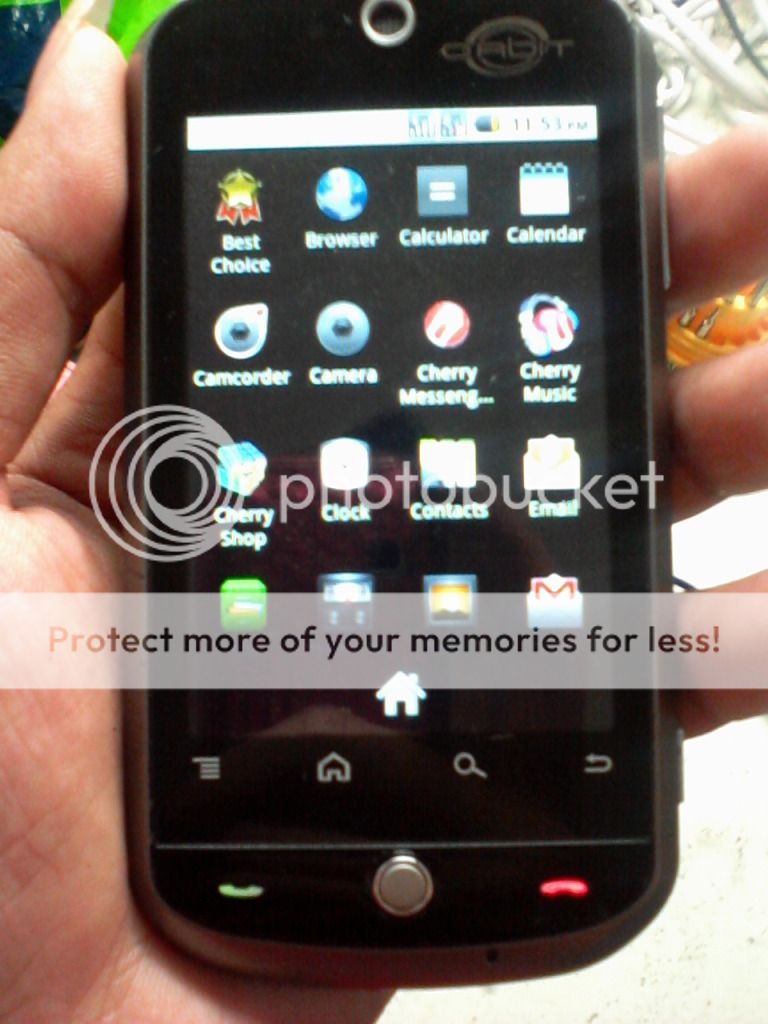

PROBLEM
Too many patterns

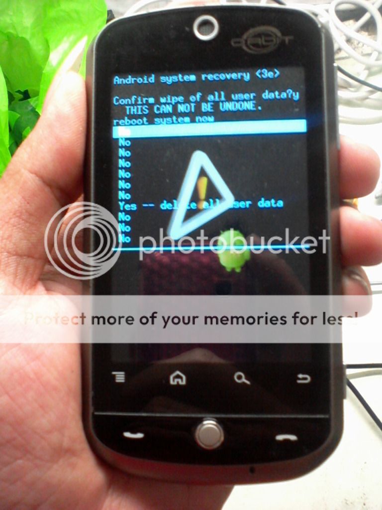

PROCEDURE

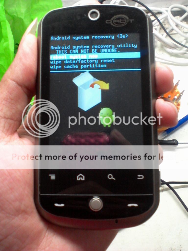

Press Camera button+Power button
1.Select wipe Factory/reset
2.Select YES delete all user data

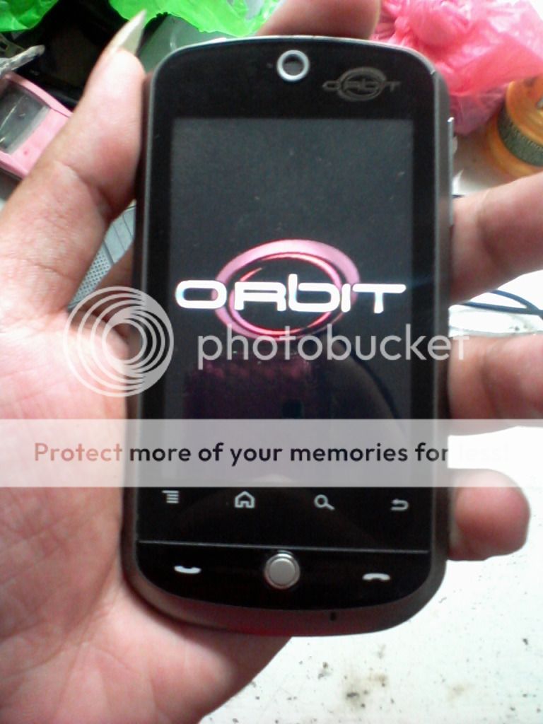

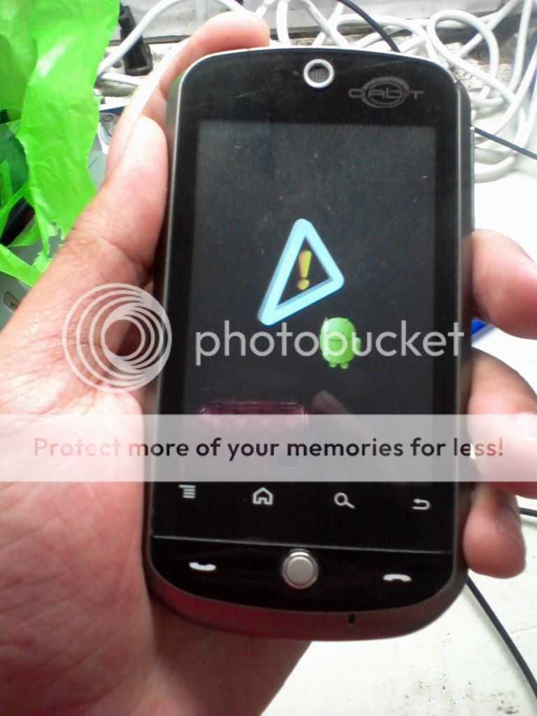

3.Reboot system now

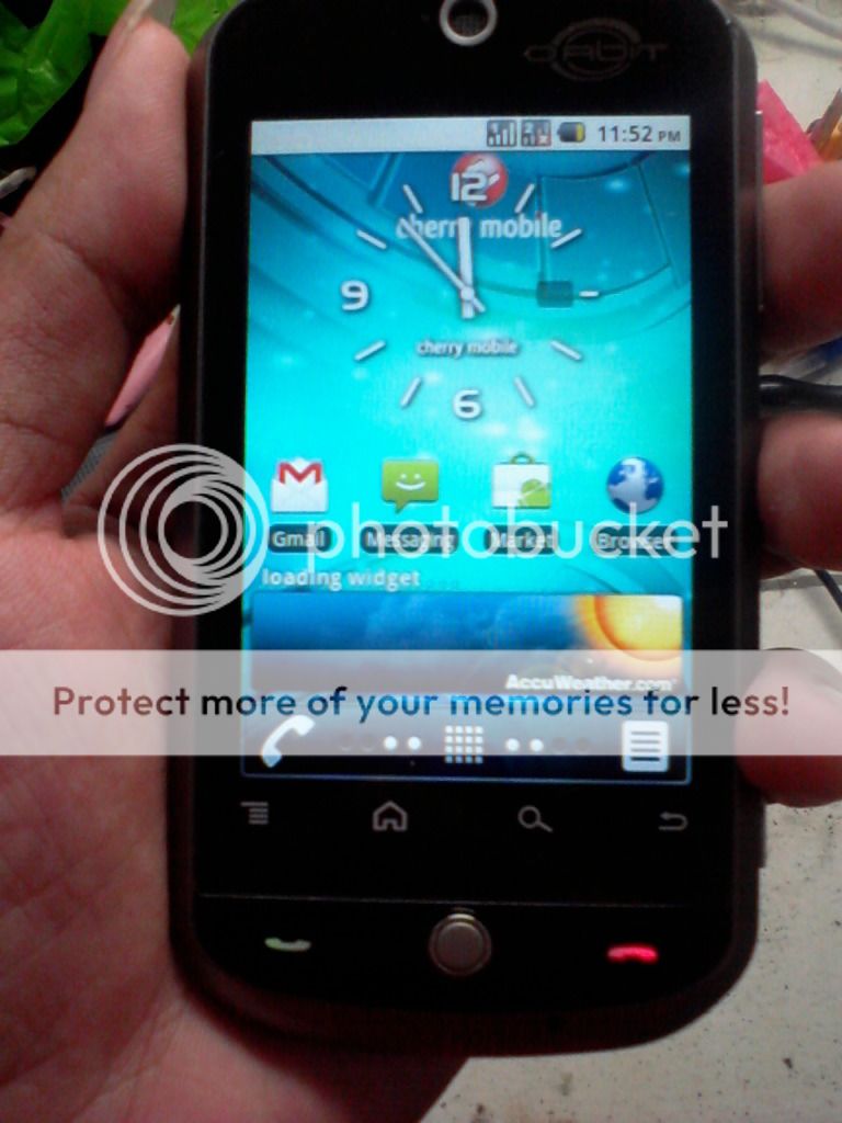

FINISH PRODUCT..
