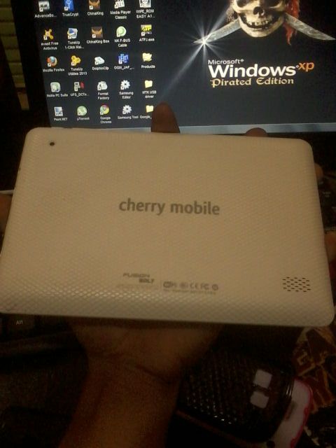

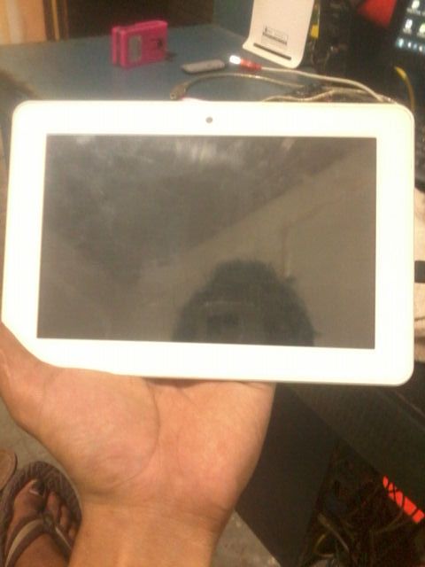

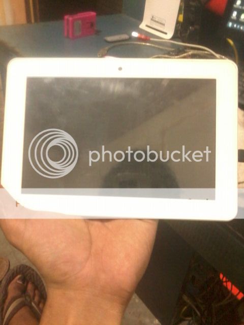

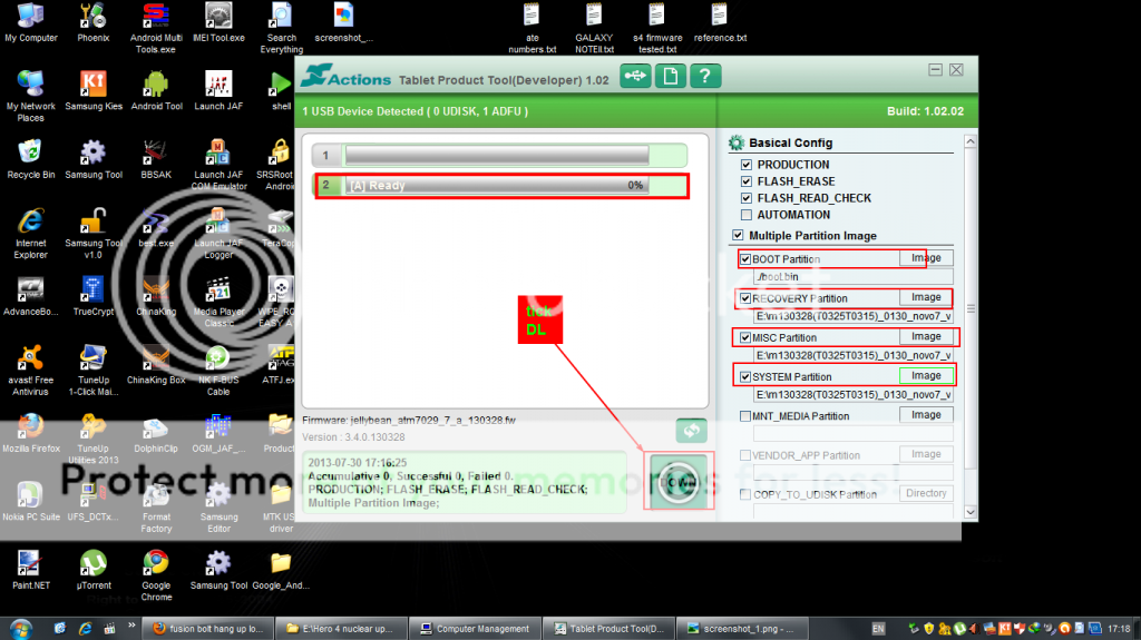

UNIT: C-M FUSION BOLT
PROBLEM STATUS: NO POWER

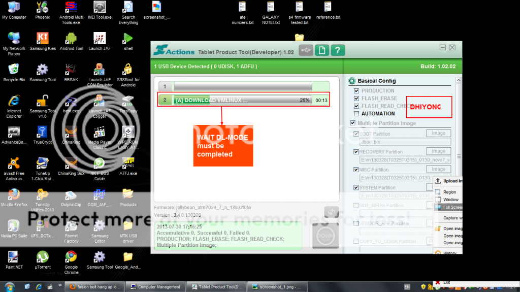

PROCEDURE
AND
instructions:
1.Install Nuclear Upgrade Tool Setup
2.Then Power Of Your Device
3.Press Volume + And Power On
4.Install Driver Located At Nuclear Upgrade Tool Folder
5.After Install Done Open Nuclear Folder Then Product Click Main APP
6.Select Your Firmware ,Recovery ,Misc,System Image

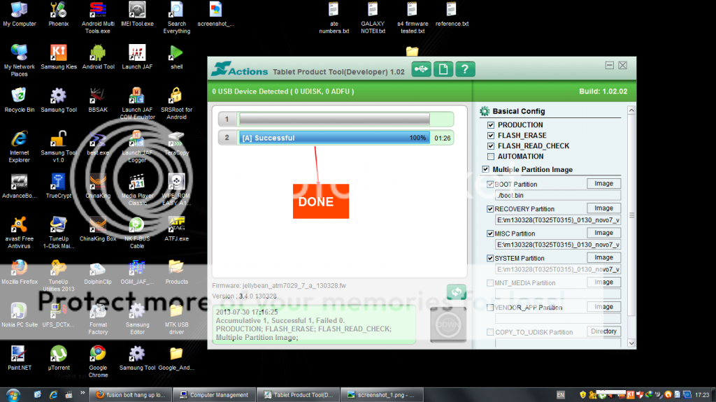

7.Then Click Download Or Flash.......

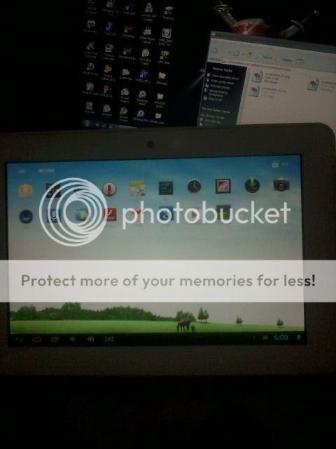

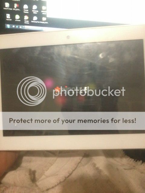

8.Wait Until Successful
FINISH PRODUCT
