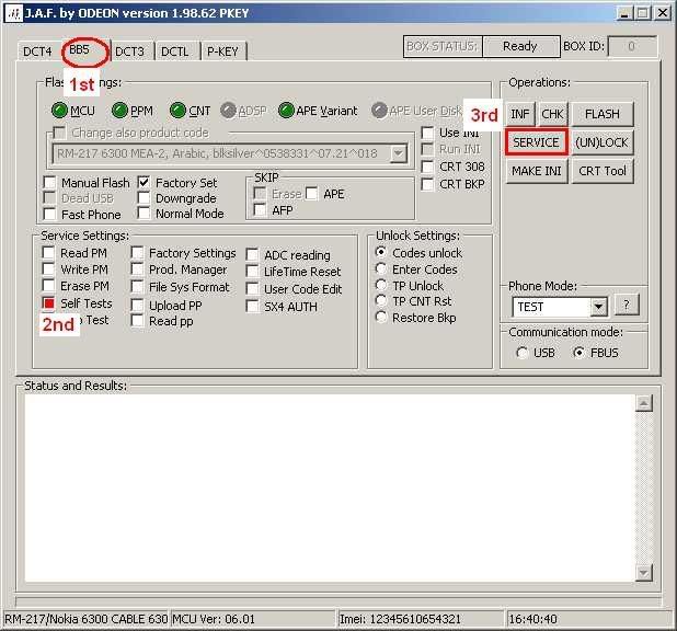

CONNECT JAF
1)SELECT BB5 TAB
2)MARKED SELF TEST OPTION
3)USE SERVICE BUTTON
Click this bar to view the full image.

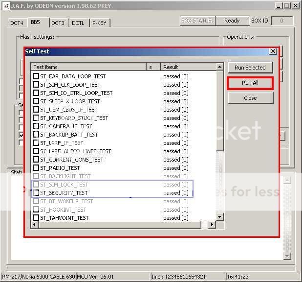

THIS TIME APPER NEW WINDOW
NEXT USE RUN ALL BUTTON(RED MARKED)
SEE BLUE MARKED AREA
Security===passed
Simlock====passed
conact service handsets show (Security===failed)
SOLUTION:::::upload pm
