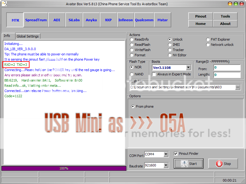

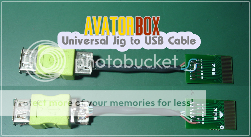

J josher Well-known Member Joined Sep 5, 2010 Posts 6,745 Likes 176 Jan 4, 2012 #1 May be not perfect in your eyes But useful in your works By this cable converter you can use USB cable come with phone as flash cable Tested with MicroUSB 100 % worked [Working as 05B]

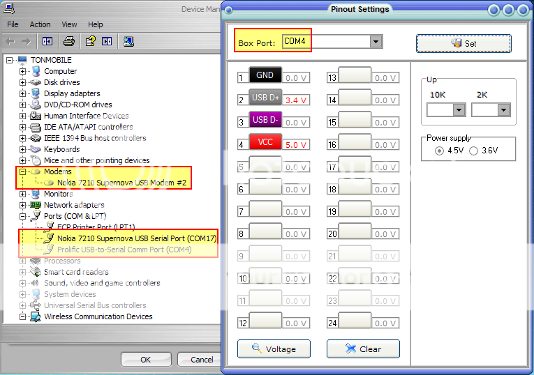

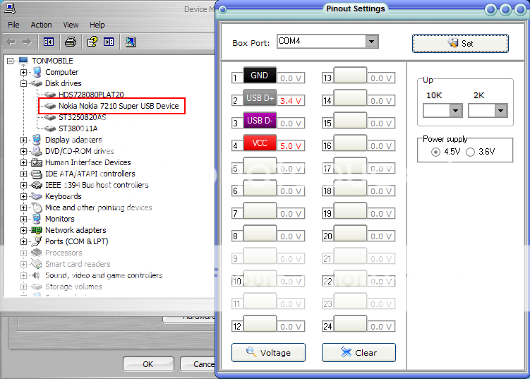

J josher Well-known Member Joined Sep 5, 2010 Posts 6,745 Likes 176 Jan 4, 2012 #2 answer: AvatorBox Universal JIG to USB cable Connect to Nokia as Data Storage Connect to Nokia as Media Connect to Nokia as Nokia PC Suite

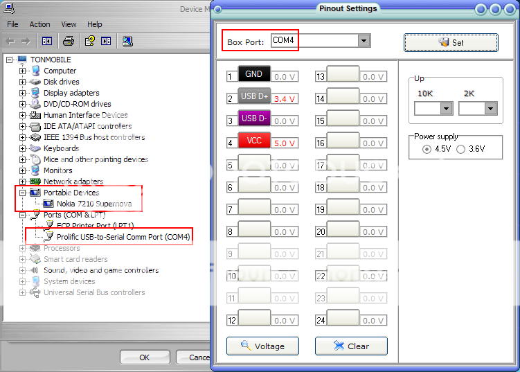

J josher Well-known Member Joined Sep 5, 2010 Posts 6,745 Likes 176 Jan 4, 2012 #3 answer: AvatorBox Universal JIG to USB cable USB MINI as 05A
