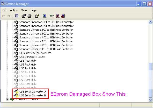

S sanjida Active Member Joined Oct 19, 2012 Posts 285 Likes 6 Feb 18, 2013 #1 Advance box not found ????? what can i do? pls pls check my screenshots:

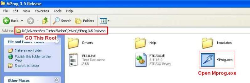

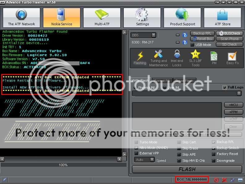

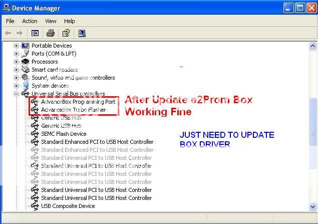

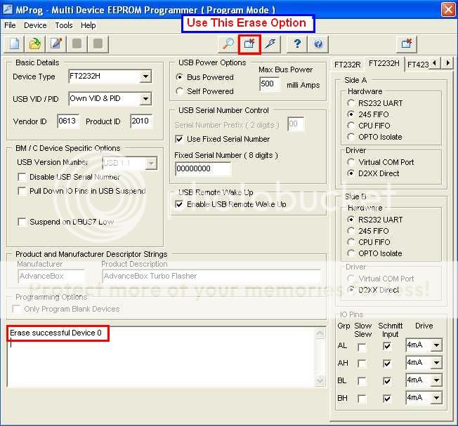

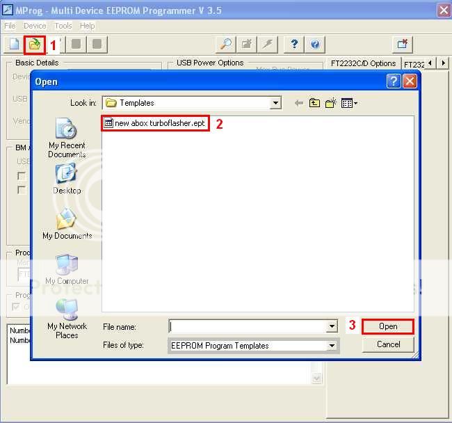

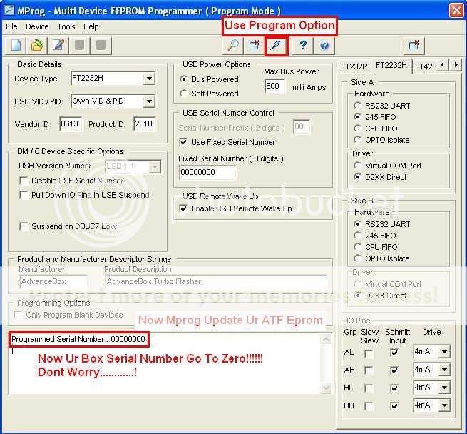

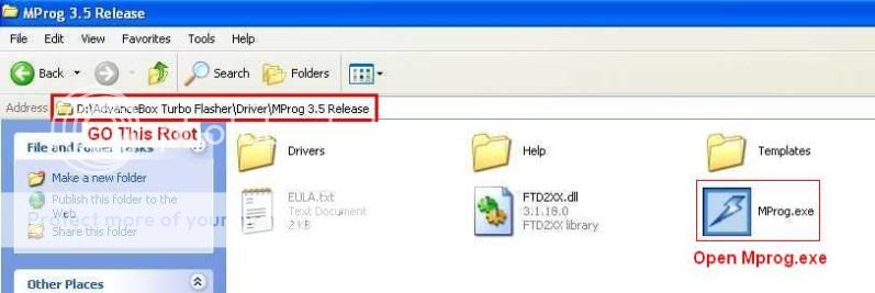

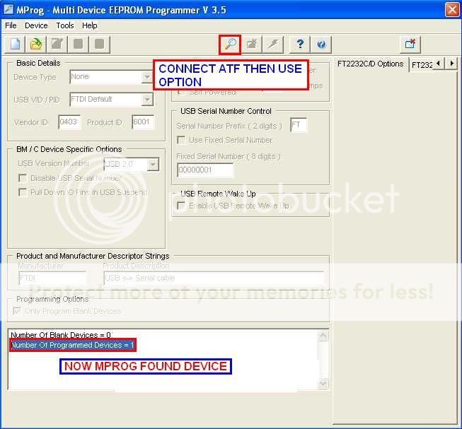

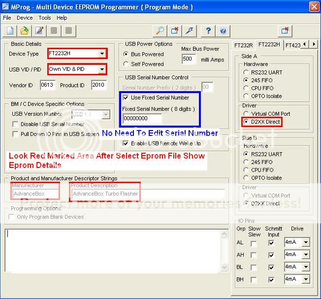

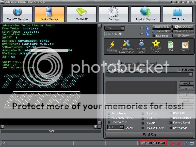

S Shikderg Product Manager Joined Oct 24, 2011 Posts 4,168 Likes 321 Feb 18, 2013 #2 atf not found solution Go to device manager Box Eeprom Damaged Go This Root Folder Open Mprog(Careful Dont Connect any Other boxs(ONLY ATF) Go This Root(C:\AdvanceBox Turbo Flasher\Driver\MProg 3.5 Release\Templates) And Select This New Eeprom File After Update Eeprom Open ATF Exe (Look Here) Aft Said Need To Update New Atf Driver!!!! Go To Device Manager Then Update Ur Atf Driver C:\AdvanceBox Turbo Flasher\Driver\ATF_NEW_DRIVERS After Make Update Driver We Must Restart Ur Pc.Now Box Ready To Use And Serial Number Restored
