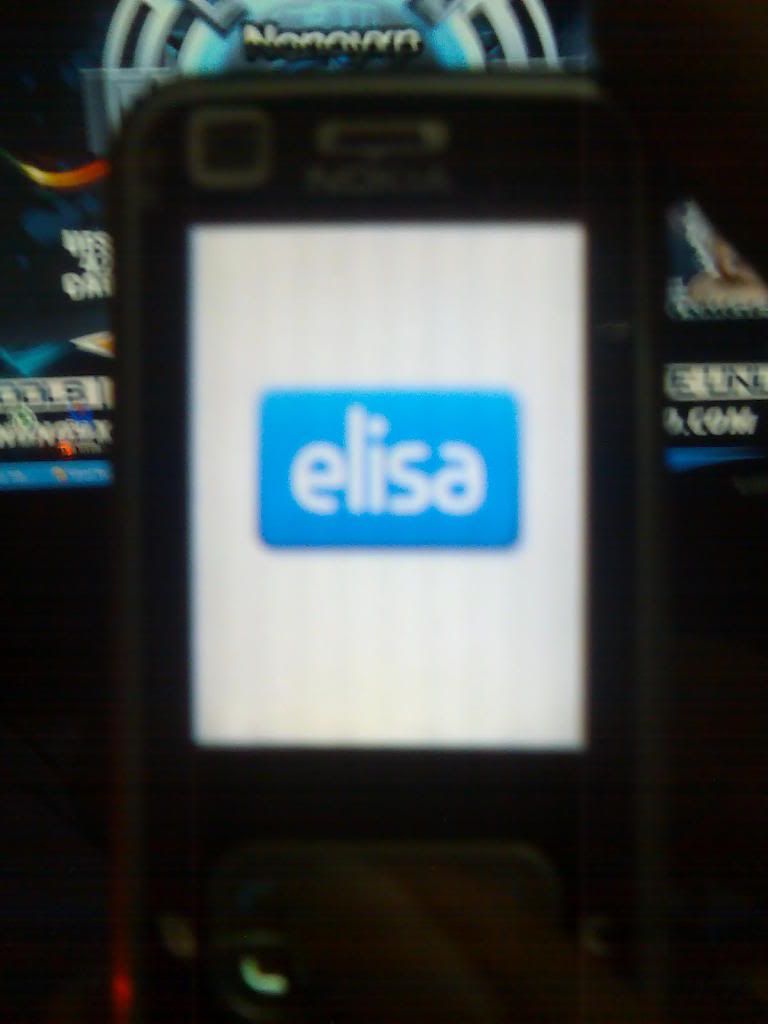

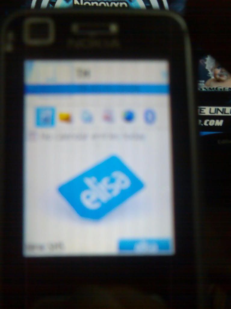

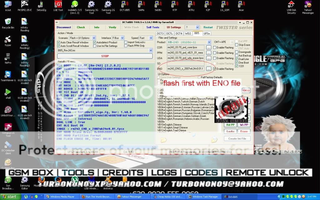

good day po sa lahat i wanna share this 6120c autho off in 30sec.flash ko sa hwk complete flashing kaso mag autho off din in 30sec. kaya flash kuna sa higher version kaso ayaw mag tuloy,,,,,flash ko sa mxkey una ENO file tapos

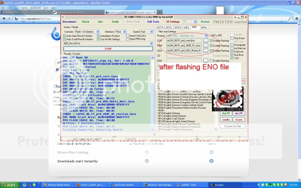

flash the phone with higher version ayun tumoloy na
history:nabagsak tapos mag autho off na in 30sec.

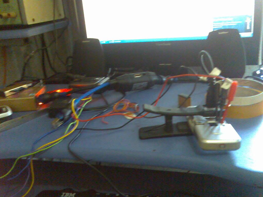

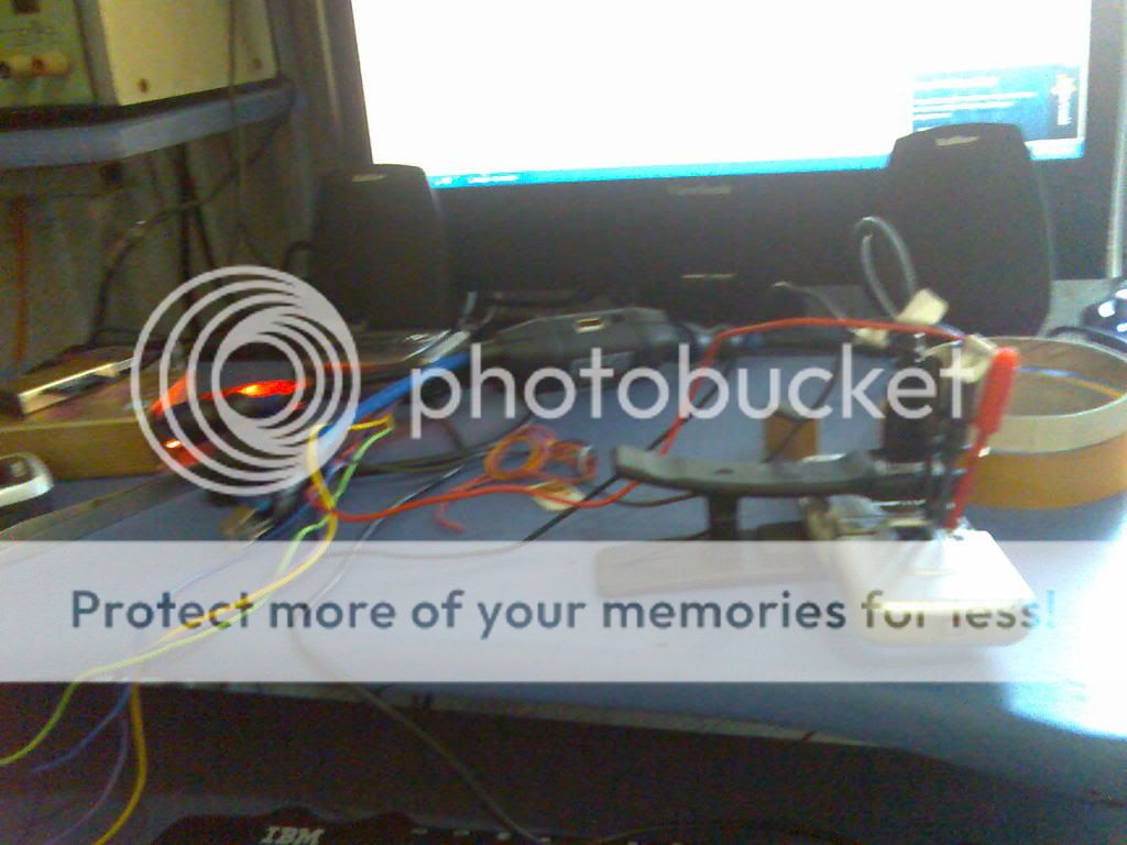

gadget:hwk,mx-key,GPG UFC cable

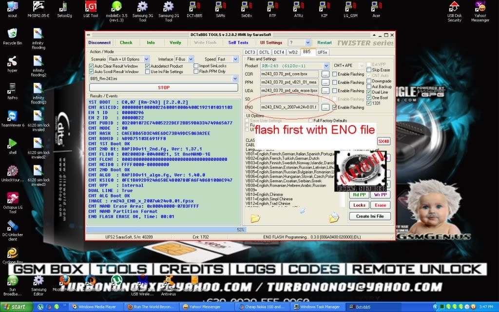

procedure:
flash the phone first with ENO file
thin flash the phone with higher version v.7.20

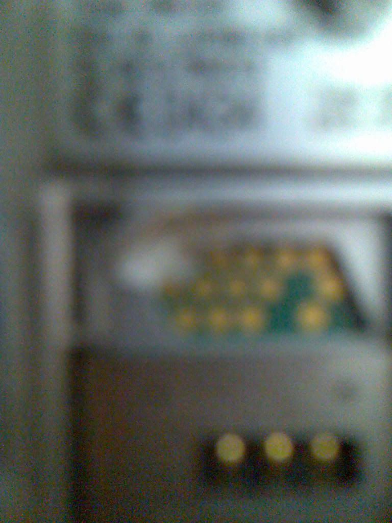

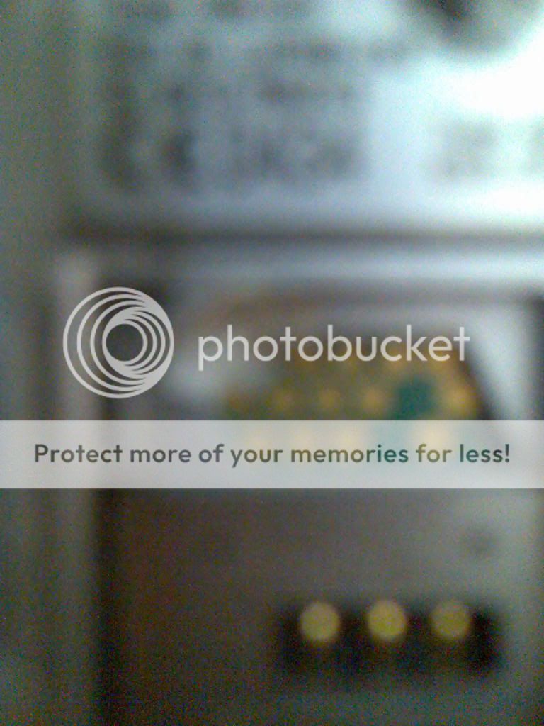

tricks:
tabunan ng tape ang unang connector sa taas
http://i1130.photobucket.com/albums/m535/scoutranger1/Image054.jpg
http://i1130.photobucket.com/albums/m535/scoutranger1/Image055.jpg
http://i1130.photobucket.com/albums/m535/scoutranger1/6120cfd.jpg
http://i1130.photobucket.com/albums/m535/scoutranger1/6120cfg.jpg

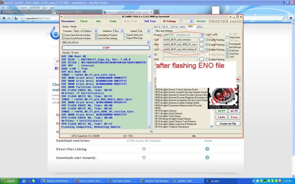

complete flash pero same parin kaya flash ko ang phone sa v.7.20 sa mx-key kasi ayaw mag tuloy ang flashing nya sa hwk
http://i1130.photobucket.com/albums...ranger1/6120csdsd.jpgutranger1/6120cmxkey.jpg
http://i1130.photobucket.com/albums/m535/scoutranger1/Image056.jpg
http://i1130.photobucket.com/albums/m535/scoutranger1/Image057.jpg
flash file v.7.20 with ENO file............GO....
