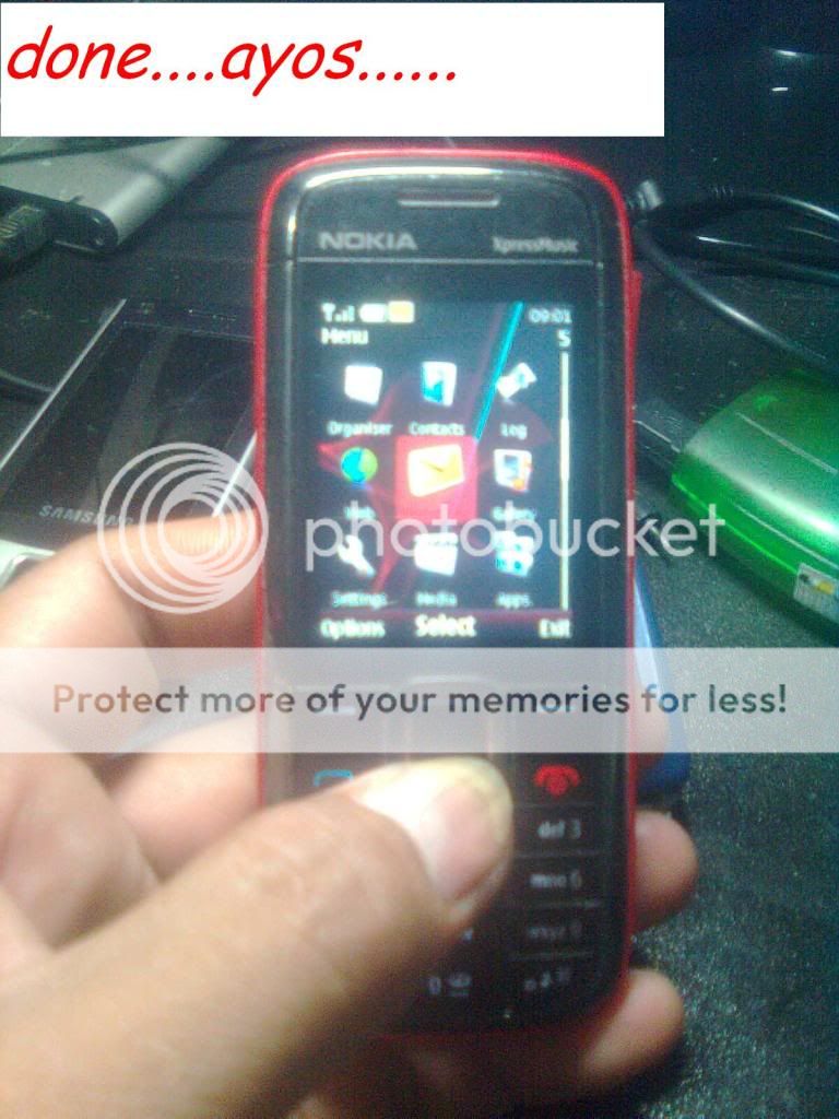

Hi good day to all sir;I have something to share..
Model; NOKIA 5130C-2

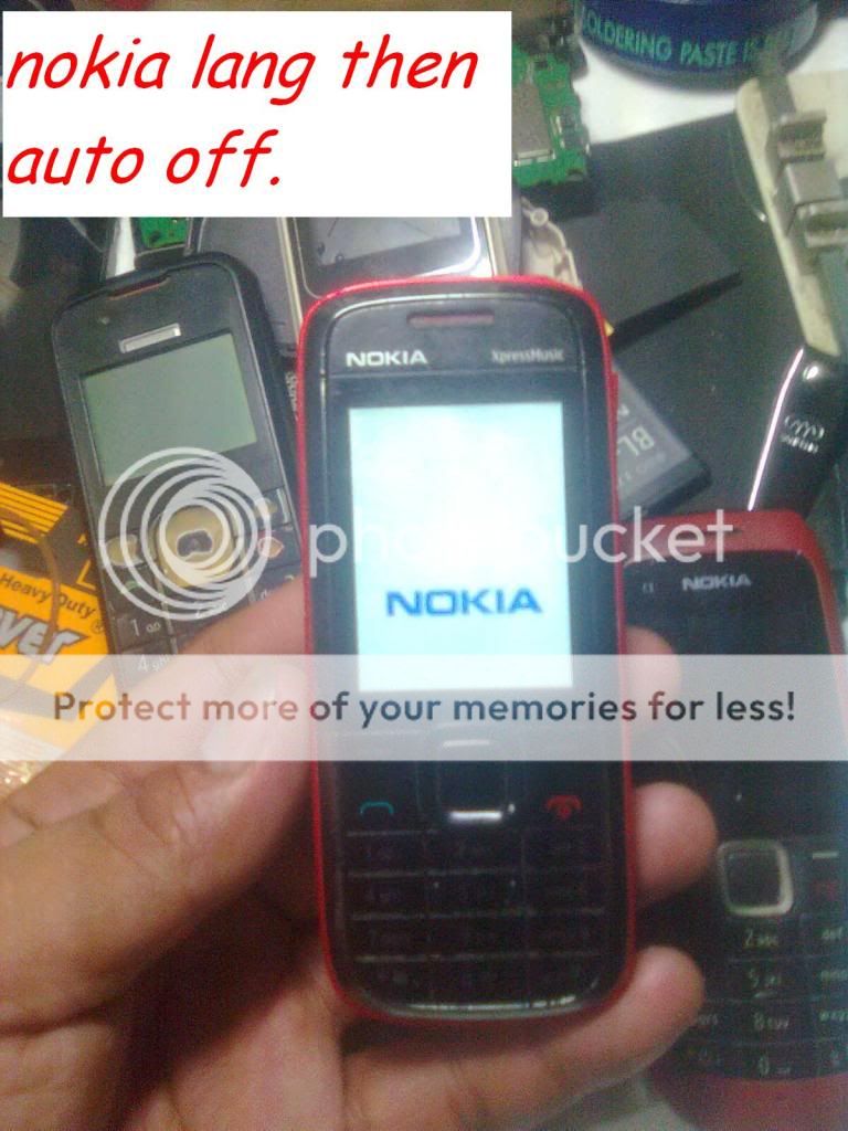

Problem;NOKIA LOGO ONLY THEN OFF.
History;ACCIDENTALLY DROP THE PHONES

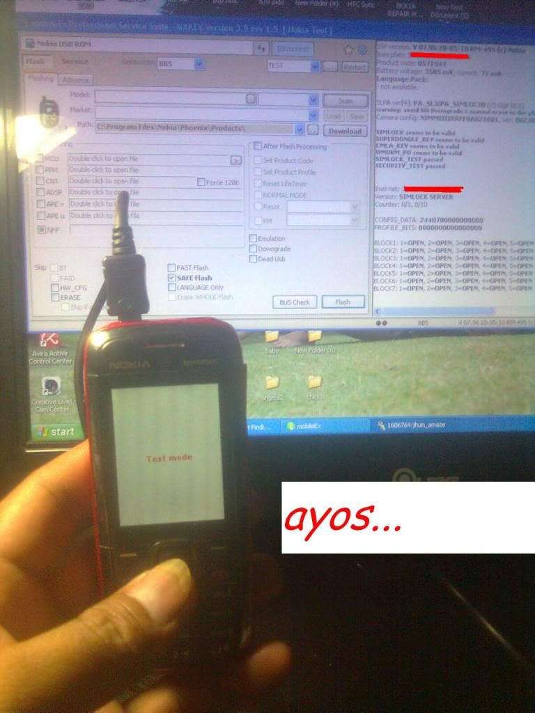

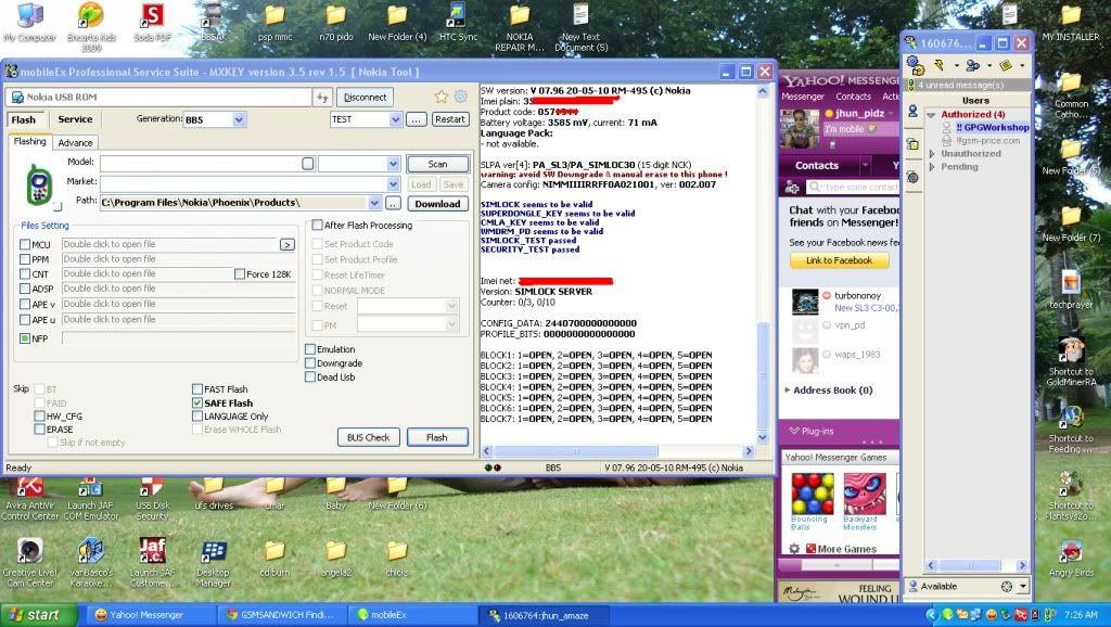

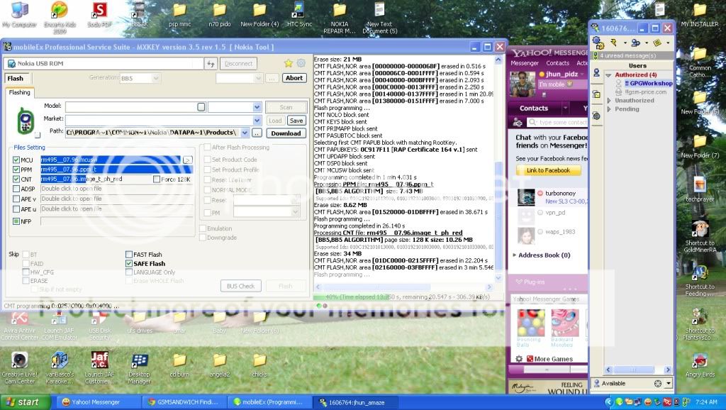

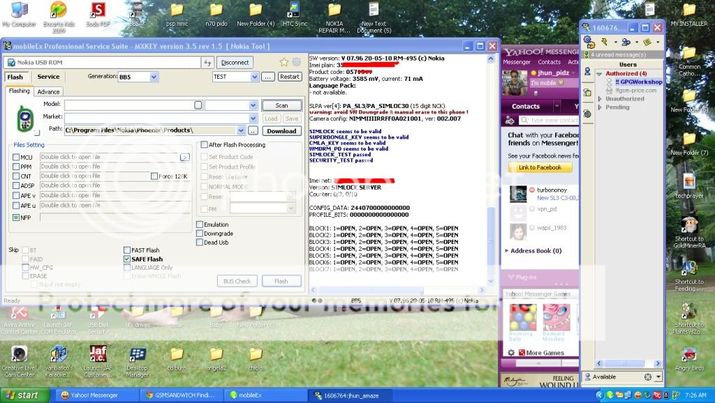

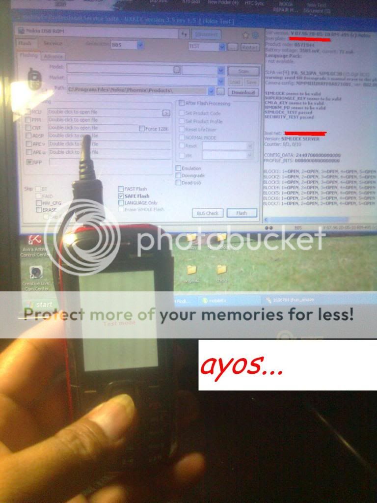

Action Taken;CHECK ALL PART...ok,but not done...So i decide to flash the phone by using mxkey via USB ROM flashing....
HERE THE FLASH FILE, rm-495 v07.96..click me to download
FOR REFERENCE;
1.THE MODEL; NOKIA ONLY
2.FLASHING.
3.FLASHING DONE!
4.TEST MODE.....

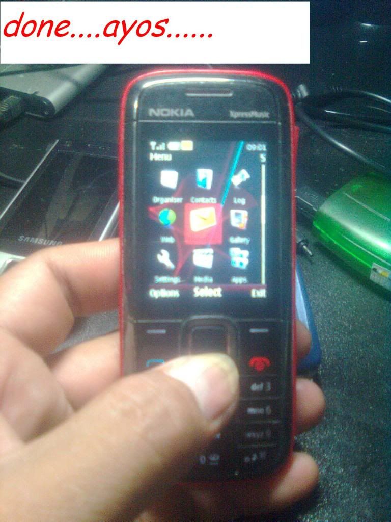

5.FINALY THE PHONE IS SOLVE...
THANK YOU FOR VIEWING SIR...HOPE CAN HELP..sdcbytfgfffdfdg
