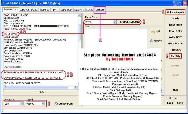

Here are the Steps: Look at the picture closely
Your SETOOL Settings:
Now you may Press Unlock/Repair Button.
Now SETool will inject executor sa fone...

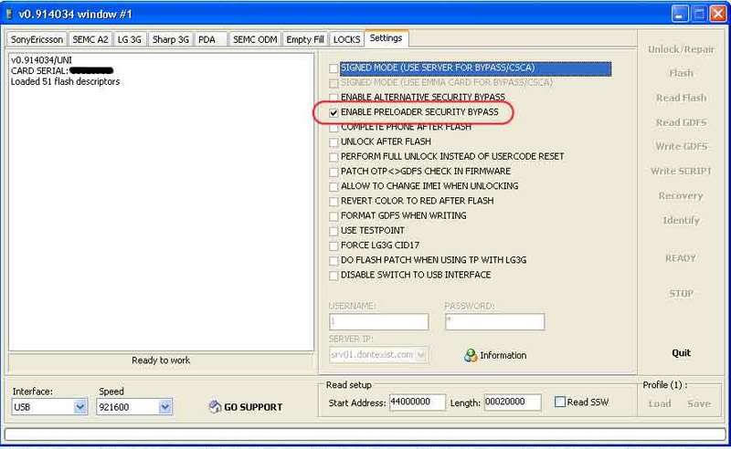

Go back to SETOOL: go to Settings>USE PRELOADER SECURITY BYPASS. Insert your DEAD Fone
Press Unlock. Wait for SETOOL to finish.
