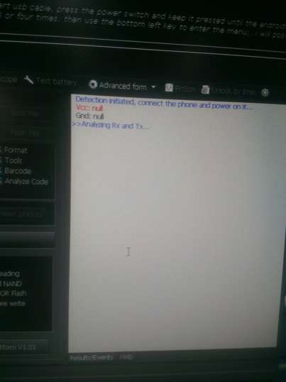

open Volcano Box software & goto Mtk tab, tick on read info & click run
wait for >>Analyzing Rx and Tx..... (like below)

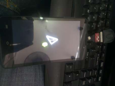

now connect phone to box cable with phone's battery (don't use box power cable) & press Volume Down + Power button untill android logo comes...(like below)
when android logo comes disconnect ur phone from cable & do ur job now......
