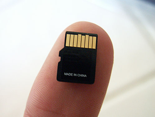

CARD FLASH: Which means using your SD Card to install the firmware, much easier and least risky, however, you need to have the recovery installed.
WHAT YOU NEED:
Micro SD Card, preferably at least 4 GB
Battery, fully charge or not below 70%
WHAT YOU NEED:
STEP BY STEP PROCESS:
NOTE: if you encountered an error where your SD card is not recognized or detected by the phone, please wipe the data or format your SD card (blank) send ROM back again to SD card and then insert on phone.
- Your ROM (in zip format) send it to your SD card, Remember not to unzip, and make sure your SD card is not corrupted (blank is preferable).

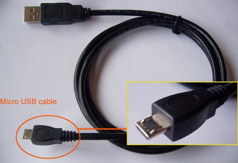

2. Cable Flash
CABLE FLASH: Is much more complex and riskier. When is it used? For example, a ROM update from Android 4.0 ICS to Android 4.1.2 or 4.2 Jellybean. Where you need to install a completely new system from scratch. In this area Card Flash is practically useless.
WHAT YOU NEED
USB Data cable
Computer (windows 7, haven’t tested with Windows 8)
ZIP File (rename it in English)
- Install msxm16 or 6575/6577 USB Driver (older) for dual core versions
- Install USB Driver, try to connect Phone and PC, see if it is detected (go to device manager), if not, reinstall and reboot pc.
- Extract Flash tool (newest one for MT6589) SP_Flash_Tool_v3.1304.0.119 or later
- NOTE: Flash tool is soooo buggy, sometimes it works, and other times doesn’t. If it doesn’t work, you need to install a newer one or sometimes a previous version works. Extract ROM on desktop (you may place all the files on the desktop to make it easier).
- Remove battery from phone, SD Card
- Open Flash tool.exe, click Scatter loading and look for “MT6577_scatter_emmc.txt” all files should be ticked.
- NEWER ROMS (“Samsung5410_Android_scatter_emmc”), doesn’t allow you to continue, please rename to “MT6589_scatter_emmc.txt” (if you have a MT6589 phone). it should look like this “MT6589_Android_scatter_emmc.txt”
- Click firmware Upgrade, Insert Battery (do not start phone) and connect your phone to pc via USB. and leave it be
- Wait until the green circle shows (please do not interrupt) firmware update is done and now you
