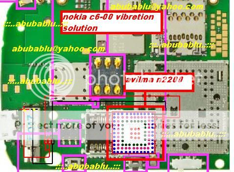

flashed with latest version but same prob (only vibrate when power on)
any idea ?
thnks in advance

answer: c6-00 only vibrate
flash with same product code firmware and post her self test log

after flashing only vibrate
Shikderg
Product Manager
Oct 24, 2011
4,168
321
reflash phone with last version 111.3
if not solve then check with hardware
