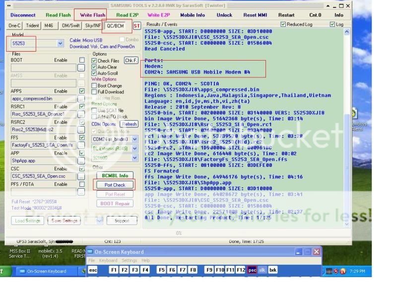

How to flash it, kindly explain here.
Or choose this:
MODEL:
SAMSUNG S5253
PROBLEM:
SAMSUNG LOGO ONLY
ACTION:
FLASHING BY DOWNLOADER V5.65
TOOLS:
multiloader v5.65 http://www.mediafire.com/?ccy1299eymlhl7f
FLASHFILE http://forum.imeisource.com/f150/z3x-new-downloads-server-witout-reg-11131/
Download Start Ch[0]
FOTA 1390.3KB OK[2.5s]
Apps 50069.5KB OK[117.1s]
Rsrc1 54001.7KB OK[94.2s]
Rsrc2 614.8KB OK[1.2s]
FFS 62562.3KB OK[111.5s]
CSC 13082.6KB OK[43.0s]
SHPAPP 70418.4KB OK[93.3s]
All files complete[463.8s]

dear sir try this
tools
-usb cable 5310
procedure
-open hwk samsung tool/select QC/BCM
-select model s5253/press nd hold volume down/call/camera/power
-wait for download mode/load firmware
-hit port check/click write flash
-wait and done
flashing
post report
