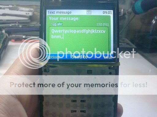

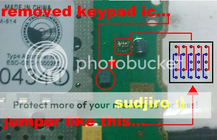

Nokia C3-00 keypad malfunction Solution
MODEL
NOKIA C3-00
PRODUCT TYPE: RM-614
PROBLEM
KEYPAD MALFUNCTION
PROCEDURE'S
DISMANTLE C3-00
REMOVED KEYPAD iC USING FLUX / SOLDERING IRON / LED
AND JUMPER KEYPAD ON BOARD INTERFACE
SOLVED!!!
