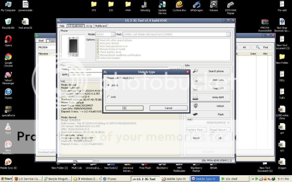

LG-SU910 Unlock Done By Secret Combinition z3x Lg & SETool
Tool:
USB Cyone Cable 2&1
Connect z3x Box To PC
Open LG 2-3G Tool & Goto LG-Qualcom
Selec Model SU910
Click Read Info & Direct Unlock
Next Procedure Setools Lg For Factory Reset Done
First Z3X Box Click Read Info & Direct Unlock
Unlock Done

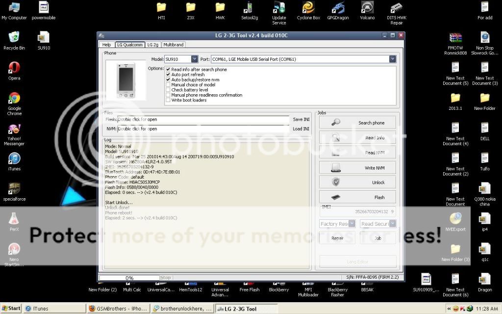

Logs Z3X Box Info & Direct Unlock
Mode: Normal
Model: SU910910
Build version: Mar 25 201014:43:00Aug 14 200719:00:00SU910910
SW Version: M6280A-KLRZ-4.0.95T
IMEI: 35266703204132-9
BlueTooth Address: 0D:47:4D:7E:BB:01
Phone Code: default
Flash Name: H8ACS0SJ0MCP
Flash Info: 05B8/0040/0800
Elapsed: 0 secs. --> (v2.4 build 010C)
Mode: Normal
Model: SU910910
Phone Code: default
Start Unlock...
Unlock done!
Phone reboot!
Elapsed: 2 secs. --> (v2.4 build 010C)

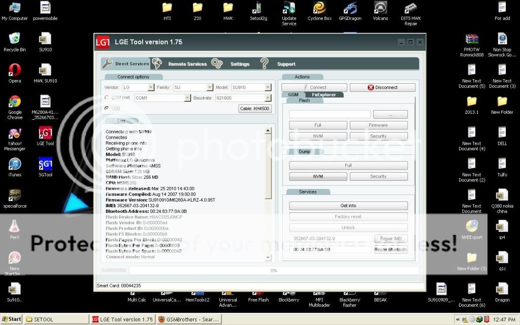

Logs Setools Lg For Factory Reset
Connecting with SU910
Connected
Receiving phone info
Getting phone info
Model: SU910
Platform: LG Qualcomm
Software Platform: AMSS
SDRAM Size: 128 MB
NAND Flash Size: 256 MB
CPU: MSM6280
Firmware Released: Mar 25 2010 14:43:00
Firmware Compiled: Aug 14 2007 19:00:00
Firmware Version: SU910910/M6280A-KLRZ-4.0.95T
IMEI: 352667-03-204132-9
Bluetooth Address: 00:24:83:77:0A:0B
Flash Device Name: H8ACS0SJ0MCP
Flash Vendor ID: 0x000000ad
Flash Product ID: 0x000000ba
Flash FS Blocks: 0x000005b8
Flash Pages Per Block: 0x00000040
Flash Bytes Per Page: 0x00000800
Flash Bytes Per Spare: 0x00000040
Connect mode: Normal
Info received

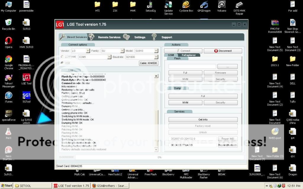

Restoring to factory defaults
Factory Reset: Start
Getting phone info...
Getting phone info: OK
Restoring factory defaults...
Dumping NVM...
Switching to NVM mode...
Switching to NVM mode: OK
Dumping NVM: OK
Patching NVM...
Patching NVM: OK
Flashing NVM...
Flashing NVM: OK
Switching to normal mode...
Switching to normal mode: OK
Restoring factory defaults: OK
Factory defaults successfully restored
